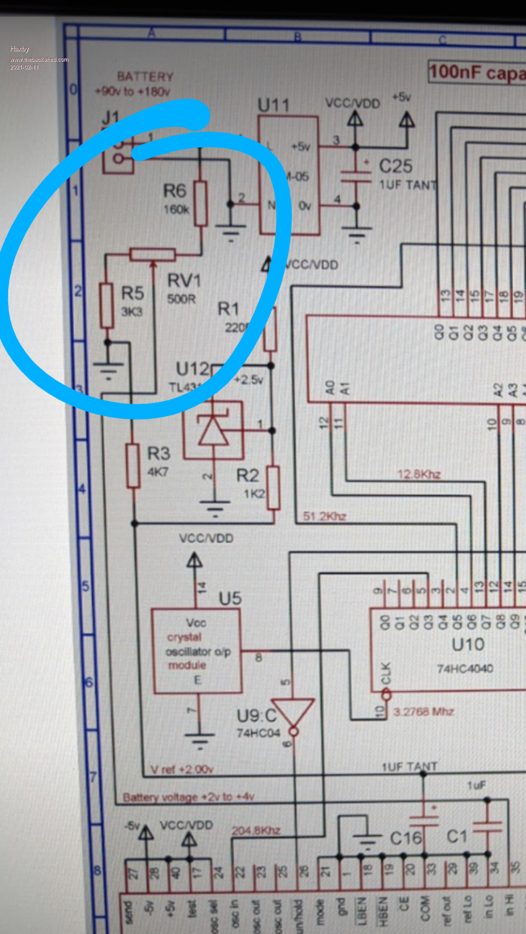

Now before I install it in my Prius, and hit it with some decent loads, what are your thoughts on completely isolating the warpverter board from the 200-400vdc supply? Specifically, the battery voltage sensing 2-4v input part.
I was thinking of using an analog optocoupler for the voltage reference instead of the existing resistor divider and pot. Any thoughts on that?

Standard isolated SMPS designs use optocouplers in the linear region for feedback. I don't know diddly about Warpverters however.

The warpverter is isolated by way of the onboard switch mode power supply, and all the outputs are optocoupled. The one remaining non-isolated point of the circuit is the voltage sense input, which uses a resistor divider to feed a 2v-4v signal into an ADC.
Since I am using higher voltages than it may have been designed for, I'm debating the merits of swapping the resistor divider to an analog optocoupler, rather than just increasing the resistor divider values.
Posted: 09:22pm 10 Feb 2021
Please use a resistive voltage divider, its the key to having excellent long term voltage stability.
What voltage did you wind your primaries for ?

Posted: 11:58pm 10 Feb 2021
O/k, I should have remembered
Try  R5 = 3K3
   RV1 = 1K
    R6 = 430K
You should be able to tweak the warpverter output voltage with RV1 between about 202v rms to 263v rms.

There are also opto isolators that use a fet as the output device.
The fet works with dc or ac as a variable resistance, just like an LDR and light source, but its super fast.
Resistance range might be a couple of hundred ohms to a couple of hundred megohms.

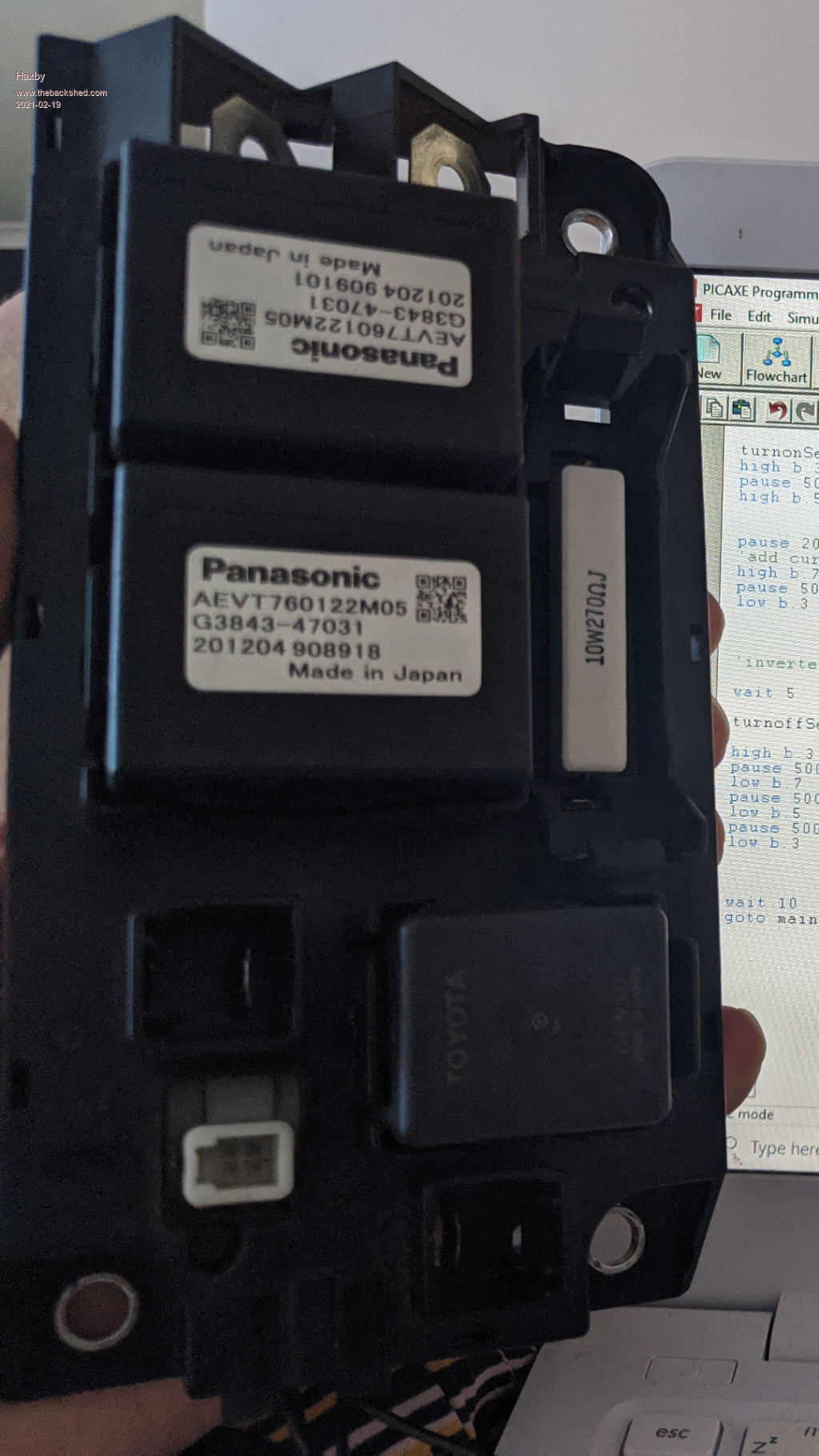

Gents, just working on a precharge circuit and I've coincidentally found a precharge relay and contactors from another Prius.
This one came from a Prius-C, which is the smaller variant and only has a 150vdc battery. I plan on running my inverter at up to 400v.
The relays are rated for 400v, so all good there.
But the stock precharge resistor is 30 ohms which at up to 400v input is 13 amps. The design load in the PriusC would have been around 5A and a very short pre-charge time.
Size wise, the stock precharge resistor looks to be about 30w if I was to guess, but by my calculations it would have to withstand 750w momentarily.
So I want to change the resistor value to something more gentle.
What about 2x270 ohm 10w resistors in series? I've got them on hand.
So 540 ohm
So at 400v, initial current = 1.35A
Initial power 540w
Time constant = 2.7 seconds
Am I pushing it? I don't have a data sheet for these resistors. They are just from Jaycar.
Posted: 05:42am 19 Feb 2021
Should work, and probably for a very long time.
If the resistors do fail open circuit (due to thermal shock) just fit bigger ones.

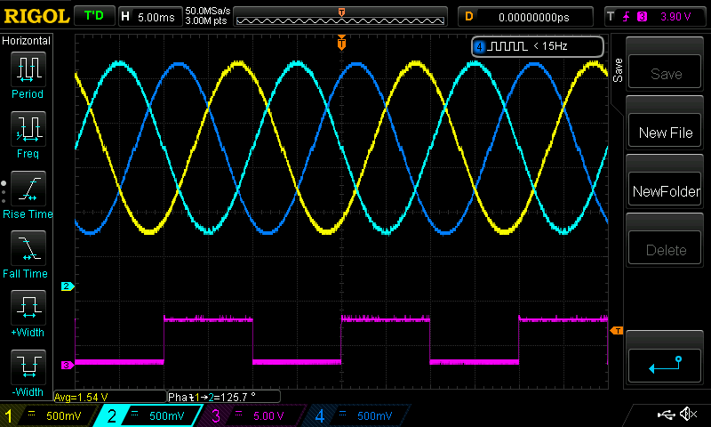

I've made a 3 phase warpverter driver.
It needs the Arduino Mega.
The code is for a 4 transformer warpverter so it has 8 digital control
outputs for each of the 3 phases.
I use the mega's PORTA, PORTC and PORTK pins. This is 24 pins
that will drive either the low or high side of a half bridge.
24 half bridges or 12 full bridge inverters.....
There are two versions of the code.
One takes a voltage feedback from one phase only, and this is used
to maintain voltage output via my usual closed loop control.
Vfb is about 2.5V for nominal output and it is pin A0
The other takes Vfb from A0, A1 and A2 and then individually controls
the output voltage for each phase. This permits some degree of unbalanced load
on the 3 phases. PORTK = A0, PORTA = A1, PORTC = A2 (if you get this mixed up
the output voltage will not have a nice feedback control loop)
As usual, you need to drive D8 to logic HIGH to run the inverter.
Pull it down to ground (logic LOW) to stop it.
There is a soft start and soft stop.
No SCR over current immediate stop function enabled but just change one line
near the bottom of the code, it should be clear to see.
Ensure Vfb is noise free. I suggest an RC filter on the signal as close as
possible to A0, A1, A2 similar to what I have done with the brainboard for the MPPT.
mega_no_sync_3ph.zip
mega_no_sync_3ph_3vfb.zip
Purple is D9, a sync pulse for the DSO
The others are decoded warpverter drive signals that are then converted to analog
voltages.
have fun. make sure to video first time power ups so we can enjoy the fireworks!!

How did you get the traces on the scope? Do you have 3 warpverters?
