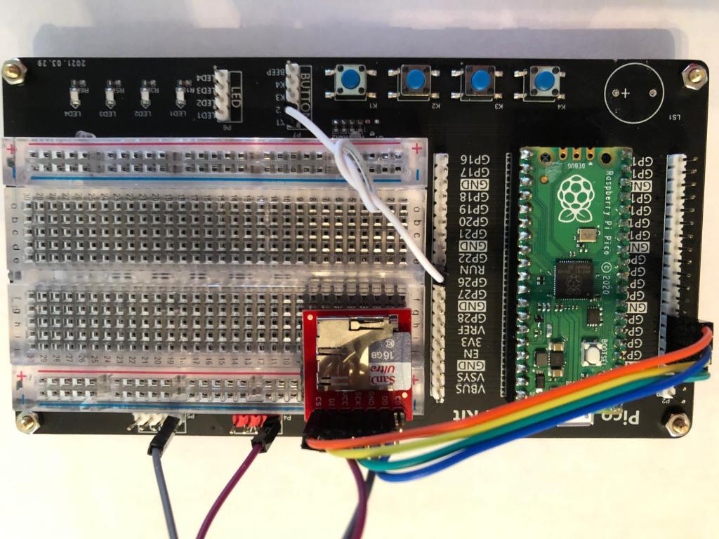

Posted: 01:17pm 06 Jun 2021
I've been testing my astronomy software using alpha version of PicoMite MMBASIC without any serious problems so far. Larger programs such as NPOE will not load and display "Error : The file/directory object is invalid".
Here is a picture of the PicoMite setup I'm using. Reset switch uses button K1. Includes a Sparkfun MicroSD breakout.
Posts: 11938
Posted: 01:35pm 06 Jun 2021
a17
PicomiteV5.07.00a17.zip
Lots of internal work preparing for I/O. More work on flash and option storage
New OPTION
OPTION CPUSPEED cpuspeedinkhz
This allows you to set the cpu speed - after option reset it will be the "new" default 125,000
I've been running completely reliably at 250,000KHz and that has been the speed for all recent alphas. I'm wondering if some of the issue people have been reporting is because their chips don't like the overclock.
Use option reset, flash erase all and var clear to clean up before and after loading the alpha
  Quote  Larger programs such as NPOE will not load and display
Can you post the code so I can have a look? thanks
