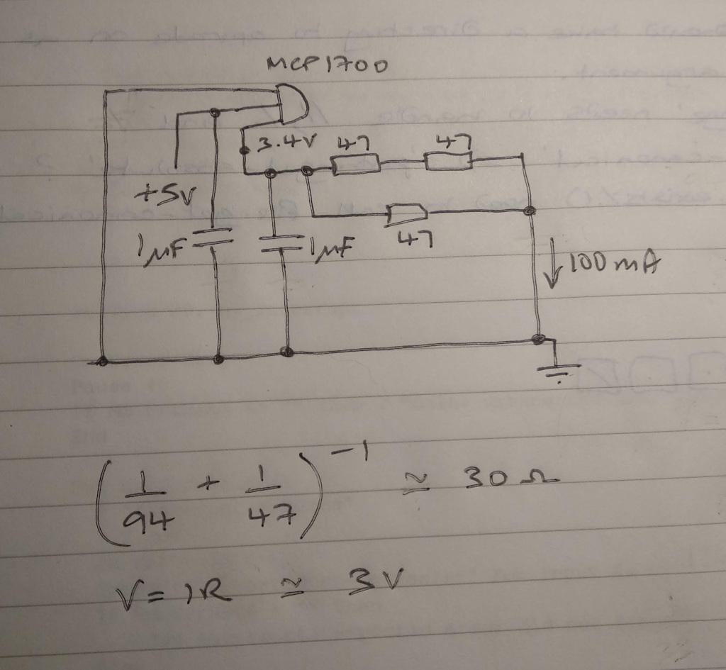

I bought my MCP1700s for peanuts on AliExpress though a Google through the undergrowth now indicates they may be "fakes" - my first if that is the case, is there some sort of initiation ceremony?
Can anyone suggest a simple circuit/procedure for testing them?

Bumping this since I'm hoping it was missed and somebody can help:
  thwill said  I bought my MCP1700s for peanuts on AliExpress though a Google through the undergrowth now indicates they may be "fakes" - my first if that is the case, is there some sort of initiation ceremony?

The MCP1700 is rated at 250mA for voltages over 2.5V, but we don't need that much.
I'd put one in a breadboard and put 5V on its input with a small capacitor then load the output with two 33R resistors and another in parallel. The output should be at 3V3 as the load will be 200mA. The capacitors should be 1uF ceramic ideally, but 10uF electrolytic should be fine. Removing one of the resistors shouldn't change the voltage by very much at all.

  Mixtel90 said  The MCP1700 is rated at 250mA for voltages over 2.5V, but we don't need that much.
Hmm, you're failing to recognise how useless I am. I was trying to learn some basic electronics, but people keep creating boot to BASIC machines that I end up playing with instead.
I built this circuit, which I think is what you described:
I had to use 47R resistors as I don't have any 33R.
The output from the MCP1700 was in the range 3.3V-3.5V and the current about 100 mA which I guess is about right given that resistor network has a resistance of about 30R according to my memory of basic theory. Does this sound OK, the regulator was pretty warm (but not hot), should it have been ?
In the quoted text how is the load 200 mA ? A network of 33R resistors as you describe has a resistance of 22R and 3.3 / 22 => 150 mA doesn't it ?

Posted: 11:45pm 22 Apr 2022
I think what Mick meant to say was to use two 33 ohm resistors in parallel as the load. One will take 100mA and two will take 200mA.
Yes it should get warm, I wouldn't leave a 200mA load on it for too long without a heatsink of some sort.

Posted: 11:50pm 22 Apr 2022
You could try three 47 ohm resistors in parallel, that will give you a load resistance of a bit more than 15 ohms.
