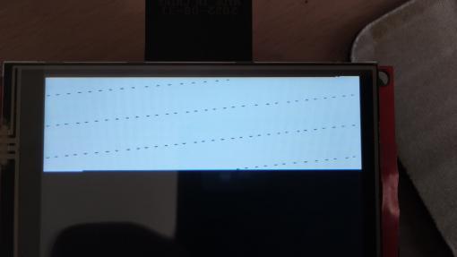

I've got the "pet8.bas" example with the "petsciiLCD.bas" addition running under RC4 on a PicoMite with an ILI9341 and I'm getting this when I RUN:
Any ideas what stupid mistake I am making ?
Edited 2023-09-27 20:51 by thwill
Posts: 4405
Posted: 10:58am 27 Sep 2023
OK, it's caused by the background copy of L to N; I added a PAUSE 100 after that and the problem went away.
Now I just have to determine why there is no player sprite.

Tom--exactly where did you put that PAUSE 100?
Using pet9.bas I get the walking guy on the LCD.
Regarding speed of the LCD version versus the speed of that online MSX version, the LCD is faster. One anomaly that I notice is that if I hold down the left arrow key, the guy disappears for periods, reappearing in the proper place if I release the key or run into an obstacle. I assume this is happening because the screen updating is too fast! Maybe a pause needs to be introduced if the guy is just ambling along (but where).
Tom--I notice that if I put PAUSE 50 after FRAMEBUFFER COPY l,n,b, the guy disappears.

For the LCD version, I moved the FRAMEBUFFER COPY and PAUSE to after writeplayer:
if FlagLCD then: FRAMEBUFFER copy l,n,b: Pause 50: endif
Now the player always appears when an arrow key is held down, but I've lost the background underfoot (it reappears when guy moves to the next tile).
Note that an arrow key (or maybe any key) is needed after RUN to bring something up on the screen.
