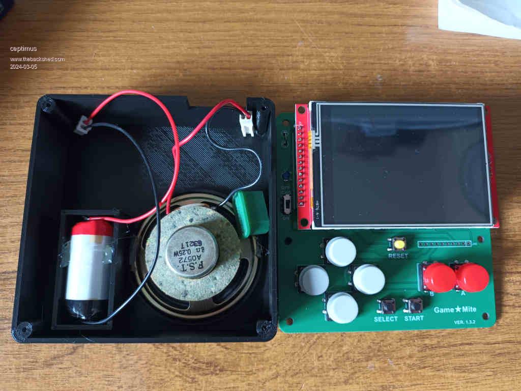

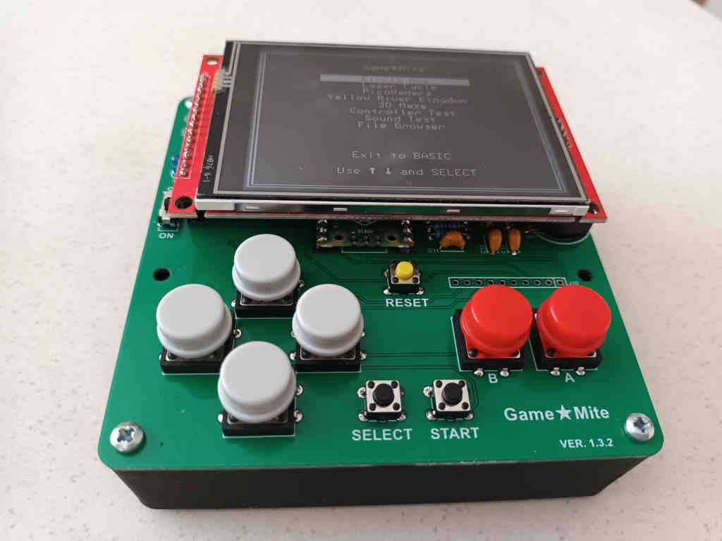

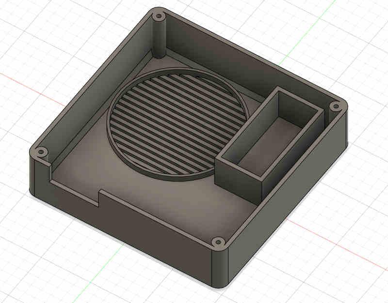

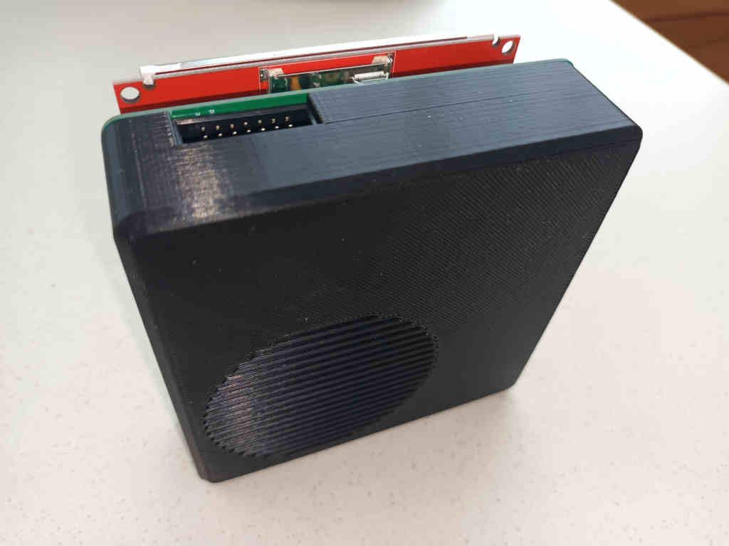

I bought a kit from Tom (thanks Tom), and enjoyed putting it together.  I powered mine from a Li-ion cell I harvested from a discarded vape I found littering the street.  It's a round 1500 mAh cell, so a little larger than the type Tom recommends.  That meant there was no need to worry about the size of the speaker, and I found an old 2-inch diameter speaker in a box of bits - probably I took that out of a broken transistor radio, or clock radio, years ago.
I designed and 3D-printed a case (back) to hold those two bulky items, and put some slots over where the speaker cone fits, to 'let the sound out'.
It works great.  When I get a couple of current, non-mite, projects completed I intend to port some of my previous Colour Maximite (version 1) games to it.  I'll probably start with my Manic Miner port.
If anyone wants the 3D-printed back STL files (or Fusion 360, if I can work out how to share those), let me know and I can upload them to Thingiverse or similar.

You can see in my photo, I just used some dabs of hot glue, from a hot glue gun, to hold the battery in its 'box', and to secure the speaker.
The greeny-coloured thing lying by the speaker in the photo is just a rubber cover for an XT60 power connector that shouldn't be there - it fell off a shelf and landed there when I was about to snap the photo!

Could you just confirm that the 2" speaker was out of choice, not necessity. I did include one of my little rectangular speakers with your kit didn't I ?
ceptimus
Joined: 05/07/2019
Posts: 130
Posted: 03:12pm 04 Mar 2024
I was about to post that I don't think I did have the little rectangular speaker, but I double-checked before posting, and found it lying amongst all the junk on my soldering desk!
The leftover bits from the kit, I think, are that speaker, a VER.1.3.1 backplate PCB, some stand-offs and a few lengths of header pins.  I'll likely fix the track shorts on the 1.3.1 'backplate' board and build up a second Game*Mite.  I think I have all the parts I need lying around, except for a PAM module, a volume control pot, and the large push buttons - I'll get those from Ali Express or Ebay.
The speaker I actually used, I just measured again, and the outer frame is actually about 57.5 mm diameter - so a little over two inches.  I've no idea where I got it from, or whether that is a 'standard' size.  It sounds good in the Game*Mite though!

If I've understood it right, this link should allow anyone to access and edit my Fusion 360 design. https://a360.co/3TmWbG3
Don't worry about changing it - I already have a copy of the .stl, and if I want to make any substantial changes, it wouldn't take me long to just start over from scratch.
But maybe it doesn't allow editing?  I don't really understand what can, and cannot, be done using the free-to-use (hobby) version of Fusion 360.

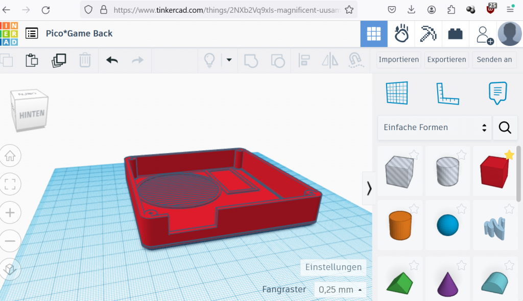

No, i edit the copy of the STL File which I downloaded with your ZIP File, so your Source doesn't change.
If I download a Textfile from you and edit it, your file also will not change ;-)^
here my more slim version:
Pico Game Back.zip

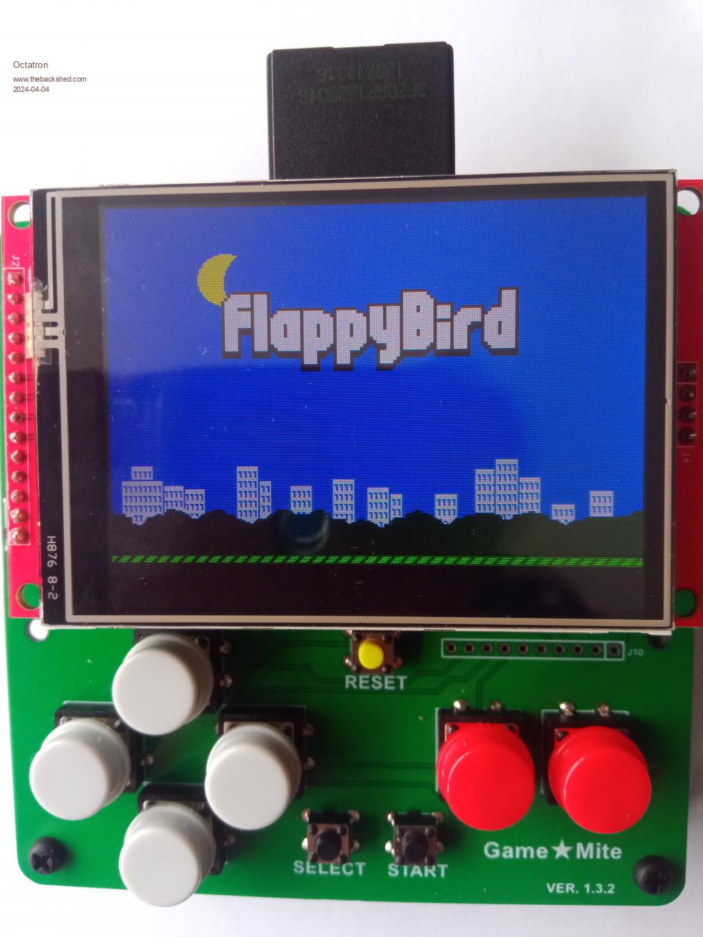

Another Successfully Completed Game*Mite Kit
I enjoyed building Tom's kit, he has done a good job of collecting the parts together, even marking up the resistors.
A couple of questions.
Is there a way of transferring files from Drive B: (SD Card) to Drive A: (internal memory)? I checked the manual but couldn't see any mention.
Is there a USB PicoMite version for Game*Mite? It would be good to attach a keyboard to it for editing etc.
Also it would be good to see some games or other programs using the touch screen on Game*Mite. I don't think I have seen any yet but I may be wrong.

  Octatron said  Another Successfully Completed Game*Mite Kit
Thank you for posting your build.
  Octatron said  Is there a way of transferring files from Drive B: (SD Card) to Drive A: (internal memory)? I checked the manual but couldn't see any mention.
The Game*Mite hardware is just a standard PicoMite with specific display, audio and some buttons. As per the normal PicoMite you can attach a PC via the USB connection and then use a terminal program (e.g. 'Tera Term' on Windows, 'screen' or 'PutTTY' on Linux or Mac). Once connected you can use the MMBasic console to copy files around. Alternatively use @TassyJim's MMEdit. Eventually I hope to provide tools of my own that will run on the Game*Mite and support basic operations such as moving files between A: and B:
  Octatron said  Is there a USB PicoMite version for Game*Mite? It would be good to attach a keyboard to it for editing etc.
It's not on the cards from me. Use a terminal or MMEdit as above. Note you can't attach a PS/2 keyboard to the user-port, the required pins (GP8 and GP9) are not free.
  Octatron said  Also it would be good to see some games or other programs using the touch screen on Game*Mite. I don't think I have seen any yet but I may be wrong.
It would be good to see some more games full-stop .
To be honest the touch-screen doesn't really fall within my concept of the Game*Mite, but there was no good reason not to wire it up, so I did.
Currently I'm porting Akalabeth (Ultima 0) starting with @vegipete's CMM2 version, but I'm doing it the long way around by way of getting it to run on MMBasic for Linux first .
Thanks again for buying and building one,
Edited 2024-04-05 00:24 by thwill
