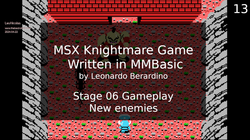

Posted: 04:17pm 21 Apr 2024
I released the stage 6 gameplay video.
https://youtu.be/TD_DWqn7wSA

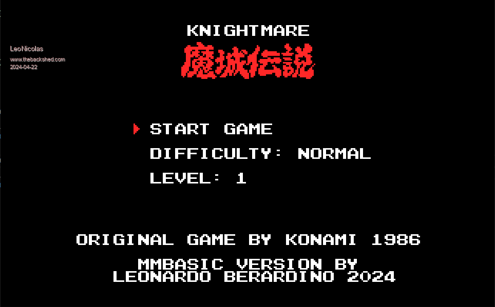

Posted: 10:58pm 27 Apr 2024
Hello everyone
I completed the game intro and main menu implementation. The next steps are to implement stages 07 and 8.
https://www.youtube.com/watch?v=xB08OaIKxmU
Posts: 6259
Posted: 07:49am 28 Apr 2024
Nice, even without level 7 and 8 it is a complete game now.
Excellent work Leonas.
