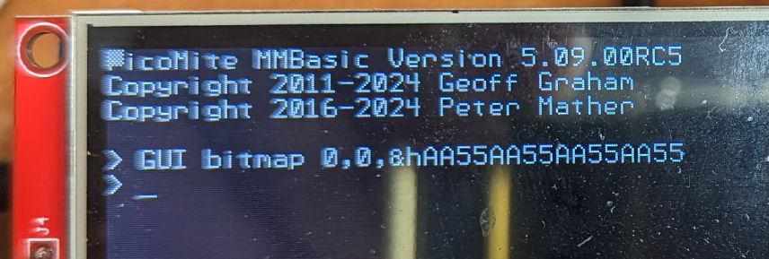

PicoMiteVGA 5.09.00RC5
GUI bitmap 0,0,&hAA55AA55AA55AA55
command stopped displaying graphics in the top line of the monitor with a height of 12 pixels !
This worked in the previous version RC4.
Perhaps other commands for output to the top of the screen are broken too...
Edited 2024-06-09 20:35 by javavi
Posts: 12272
Posted: 11:20am 09 Jun 2024
Works for me
javavi
Joined: 01/10/2023
Location: Ukraine
Posts: 643
Posted: 01:05pm 09 Jun 2024
  matherp said  Works for me
Yes, I apologize. There was some strangeness...
I reflashed it to PicoMiteVGA 5.01.00RC4, and then back to RC5 and this effect went away.

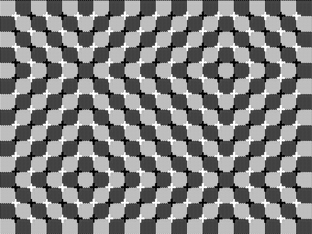

javavi
Joined: 01/10/2023
Location: Ukraine
Posts: 643
Posted: 02:16pm 09 Jun 2024
End works fo me ;) PicoMiteVGA V5.09.00RC5  MODE 1 (640x480)
CLS
For y=0 To 480 Step 2
 For x=0 To 640 Step 32
   If (x And 32)Xor(y And 32) Then
     GUI Bitmap x,y,&hBBBBBBBBEEEEEEEE,32,2
   Else
     GUI Bitmap x,y,&h4444444411111111,32,2
   EndIf
 Next
Next
For y=1 To 14
 For x=1 To 19
   c=(x+y+(x>5)+(x>14)+(y>4)+(y>11)+1)Mod 2
   Line 32*x-8,32*y-2,32*x+8,32*y-2,4,c
   Line 32*x-2,32*y-8,32*x-2,32*y+8,4,c
 Next
Next
Edited 2024-06-10 00:19 by javavi

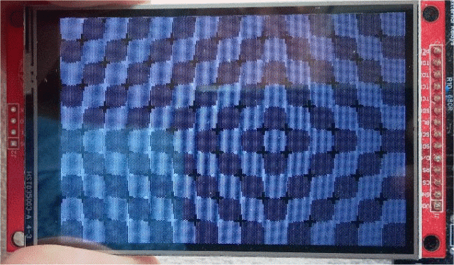

Posts: 3891
Posted: 03:21pm 09 Jun 2024
ILI9488 480x320:
But why are all the corner crosses in this version black, which eliminates the white crosses which produce the appearance of distortion?
CLS
For y=0 To mm.vres Step 2
For x=0 To mm.hres Step 32
  Else
  EndIf
Next
Next
For y=1 To 14
For x=1 To 19
Next
Next
Edited 2024-06-10 01:22 by lizby
Posts: 12272
Posted: 03:27pm 09 Jun 2024
Try this:
CLS
 Else
 EndIf
Next
Next
For y=1 To 14
For x=1 To 19
 Line 32*x-8,32*y-2,32*x+8,32*y-2,4,choice(c,&HFFFFFF,0)
 Line 32*x-2,32*y-8,32*x-2,32*y+8,4,choice(c,&HFFFFFF,0)
Next
Next
Edited 2024-06-10 01:28 by matherp
Posts: 3891
Posted: 04:32pm 09 Jun 2024
Great, thank you. Not exactly the same (different screen resolution), but still a neat effect.
I knew it had something to do with the calculation of "c", but couldn't work out what I needed to do.
Of course, it's much cleaner looking on the LCD itself.
Edited 2024-06-10 02:34 by lizby
