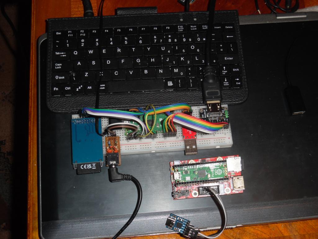

Posts: 2992
Posted: 12:42am 14 Feb 2025
  robert.rozee said  …. i must confessed, i am not entirely impressed by the DVI performance of the RP2350 chip - i get the feeling that support for DVI was just a step too far for the chip's limited resources.
Neither was I too impressed after my initial attempts BUT as of now I think Peter has made DVI very usable. Sure, there are limitations, but when those limitations are understood then some impressive results are possible.
I don’t think I’m wrong in saying that we have all learnt something on the recent ‘journey’. Having spent many hours/days/weeks deep-dive testing I can see why some people have ‘struggled’.
Personally, I have seen jitter/noise but that was down to long cables and slow slew rate. I have had monitor and TVs not display an image, but that was down to incompatible frequencies (and slew rate). Also not helped by when changing resolution to 640, most monitors I have here only work on 60Hz whereas the default 640 res is 75Hz.
Thrown j to the mix, there is the 5V on pin 18 that some displays want; not to mention potentially needing to set OPTION HDMI PINS depending on your hardware pinout of the 4-pairs in the DVI connection.
As for the OLIMEX 2040 Pico PC board there are mixed feelings (mostly negative) about it. Once again, understand its limitations and you can use it very easily. Currently I have two test beds set up with them to give me easy HDMI and SD connections. I have left out GP26,GP27, GP28 (ie, the onboard audio) and instead connected an I2S board (and playing sound files from the SD).
Other than some basic ‘polishing’ in the firmware, I am very impressed with DVI usage.
The ultimate would be to be able to display full colour photos at 1280, but I do live in the real world and know some things would be a little to much stretch of the hardware capabilities.
So, personally, I truly like the current DVI capability and would recommend it to anyone asking if it is any good.

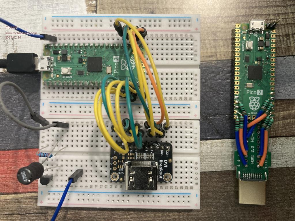

Posts: 462
Posted: 07:06am 14 Feb 2025
G'day,
This post was intended to be an update on further testing of DVI/HDMI, but Mr Murphy has put paid to that idea...
Sometimes you just gotta pack it in and have a laugh at everything
So currently working night shift 150km from home, however during a trip home to pick up parts I threw together the device shown at right of the pic below, the mess on the left has been used in most testing to date as a worst case scenario for DVI signals.
Whilst not pretty the new (right) unit plugs straight in to the DVI sink and "should" be more stable.
HOWEVER, even though the PICO2 units came next to each other in the same carrier strip, the new unit will not go past 252mhz reliably, even on the standard RP2350 firmware, it tries but reset loops every few seconds. At 252Mhz it is stable and delivers 640 DVI perfectly. So much for more testing at higher resolutions
This is NOT a winge or complaint, but it does show that we are pushing the PICO pretty hard and even genuine units are not gauranteed to play well all the time.
The fact that DVI/HDMI works at all on this hardware is awesome.
The fact that it'll work at 1280x720 on my breadboard mockup is incredible, just plugged it into the TV in my donga (living unit / cabin) and 1280 works fine, no 5V or 10k resistors required (on this one anyway)
My thanks once again to Geoff, Peter and everyone else involved in getting this little marvel to where it is now
Lyle.
