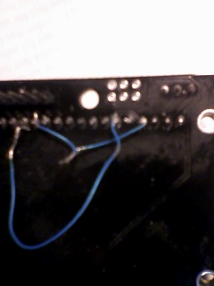

sparkey
Joined: 15/06/2011
Posts: 819
Posted: 03:09pm 17 Nov 2011
well ok then is this correct...
donmck
Joined: 09/06/2011
Posts: 1314
Posted: 03:17pm 17 Nov 2011
  sparkey said   well ok then is this correct...
Sorry, not even close sparkey.
I have re-written the details to hopefully make it clearer.
Jumper DuimoMite PIN (13) to PIN 4 (RS) of the LCD header.
Jumper DuimoMite PIN (14) to PIN 6 (E) of the LCD header.
The DuinoMite (or Maximite) PIN is referenced to the software pin, and is shown on the picture below:
Cheers Don...

sparkey
Joined: 15/06/2011
Posts: 819
Posted: 03:56pm 17 Nov 2011
ok a picture tells a thousand words but i`m sorry i cant figure this one out ..no disrespect but with what you have added im sorry if i rattled your chain to much today it was not my intent ..shure its good to be the first of the block i live for it when i came into this forum i had great expectations of what was or could be done with this machine and i guess i did gloat a little but i`m shure that i was not the first to have a "dynamite -mega" thats for shore really i have given what i could only trying to set some easy steps for others to follow and yes well if you want to go over the "rtc" issue because i made it work with what i had available then so be it ...seriously i dont need the "greif"... and today i was very exited about just having one of these boards i could of just as easily let it sit on the bench admireing its conceptability... i dont want to come to bad stuff between us ...
donmck
Joined: 09/06/2011
Posts: 1314
Posted: 04:03pm 17 Nov 2011
  sparkey said   ok a picture tells a thousand words but i`m sorry i cant figure this one out ..no disrespect but with what you have added im sorry if i rattled your chain to much today it was not my intent ..shure its good to be the first of the block i live for it when i came into this forum i had great expectations of what was or could be done with this machine and i guess i did gloat a little but i`m shure that i was not the first to have a "dynamite -mega" thats for shore really i have given what i could only trying to set some easy steps for others to follow and yes well if you want to go over the "rtc" issue because i made it work with what i had available then so be it ...seriously i dont need the "greif"... and today i was very exited about just having one of these boards i could of just as easily let it sit on the bench admireing its conceptability... i dont want to come to bad stuff between us ...
I can understand your excitement sparkey, and I know you live for the Maximite, but you can't keep sending PMs, ringing every few minutes to the point that I had to take the phone off the hook, and post messages almost continuously on the forum.
I had hoped you would understand the instructions, but wait patiently and Mick will possibly get time to do the correct track cuts and jumpers with full pictures, over the weekend.
Go to bed so you can enjoy your birthday when you get up.
Cheers Don...
