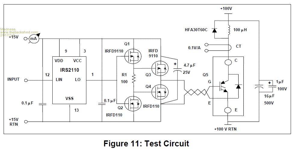

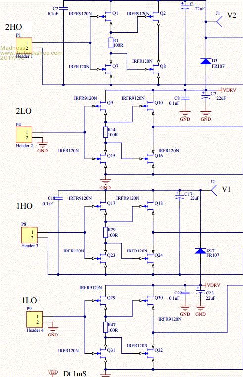

My Inverter has been running but it does not seem to perform quite as I expected. A minimal load of approximately the Toroid is about 25 degrees above ambient temperature. The only PCB I have been able to get to run successfully has been with TO220 4110 MOSFETs. Any PCB with TO247 IRFP4110's and just this week I also tried HY4008W's all work with up to 3 MOSFETs in each bank, however with load I get blips at zero crossing and the sine wave gets a squiggle on it. Adding more MOSFETs results in quite savage spikes particularly once the wave crosses 0. Which seems to indicate that the IR2110 is not able to drive more than 3 gates of these MOSFETs. ( I know the 4110 TO220 & TO247 should be the same)
On this Chinese Inverter PCB there are MOSFETs on the gate drive and they have only 5 MOSFETs on each leg.
I am considering adding this gate drive circuit. I am no Electronics Engineer so I am hoping someone might comment on this.
The full circuit can be found here, it uses the EG8010 chip also.

I'm not an EE either....but the top driver cant work, as the drive output to the fets is turned on all the time.... needs redrawing.
Apart from that I can't see anything glaring at me. I don't fully see why they have done it that way for a totem driver..... but I lack the knowledge to refute the system.
The chinese one looks more like the set up I would do.

Yes the top driver has a glaring drawing error, that needs to be fixed.
To see what is wrong, compare it to the other three directly below, which appear to be correct. The output should come from the junction of Q2 and Q8 drains.
When building something like this, the layout and how it is physically put together is as vitally important as the actual schematic.
Grounding is particularly important, and some interconnections need to be kept very short and direct, and kept well away from some other things.

Thank you for the Oz & Warp for your input I see the error you are referring to.
Here is some information from International Rectifier which talks about the same thing but only shows a circuit for the low side.
"7. HOW TO BOOST GATE DRIVE CURRENT TO DRIVE MODULES
Modules and other paralleled MOS-gated power transistors at times require more current and lower gate drive impedance than what a typical MGD can provide. The high input impedance power buffer shown in Figure 11 delivers 8 A peak output current. It can be mounted close to the power module, thus reducing the inductance of the gate drive loop and improving the immunity to dv/dt induced turn-on. It draws negligible quiescent current and can still be supplied by a
bootstrap capacitor. The buffer receives its drive signal from the IRS2110 or an MGD with lower gate drive capability, and drives an IGBT module which has a total gate charge of 600 nC. Q1 and Q2 are low current drivers for Q3 and Q4 which can be sized to suit the peak output current requirement. When the input signal changes state, R1 limits the current through Q1 and Q2 for the few nanoseconds that both transistors are on. When the input settles to its new state, the
driver transistor quickly discharges the gate capacitance of the conducting output transistor forcing it into off-state. Meanwhile the gate of the other output transistor will be charged through R1; the turn-on will be delayed by the RC time constant formed by R1 and the input capacitance of the output transistor."
The complete PDF is attached.

Posted: 03:50pm 06 Jan 2017
Madness,
That is all true, but IR never made a gate driver chip with real balls.
So they are suggesting cobbling up some extra mosfets, which will work, but it is a bit messy.
A better way is to use something like a TC4452 twelve amp non inverting driver chip and a 1.0 ohm series gate resistor mounted right up close to each mosfet. We are talking about driving some very large mosfets here, with maybe up to 10nF gate capacitance.
http://ww1.microchip.com/downloads/en/DeviceDoc/20001987C.pdf
Then parallel up all the TC4452 inputs, and drive that with your IR isolated gate driver.
Put the TC4452's in machined contact sockets. If a mosfet blows it sometimes takes out the gate driver chip, but not always. So a socket is worth the effort.
Also unplugging the individual driver chips, means you can test each mosfet gate for shorts without having to unsoldering each mosfet to do it.
These driver chips are not cheap, about $5.00 each I think. But they will drive just about anything, and are very fast.Edited by Warpspeed 2017-01-08

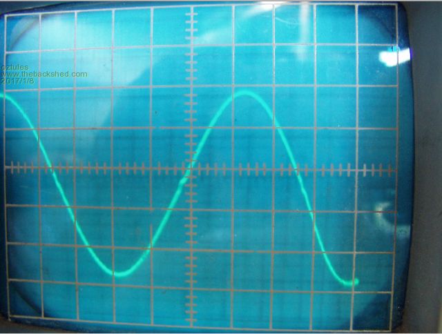

ok got some result for you.... you may be onto something.

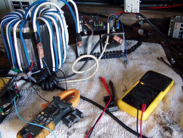

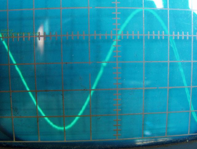

Here is a series of pictures to look at that show the idle wave and the wave at 2500watts using the same control card, but two different power cards. The first has just 2 hy4008 per leg, the second has 6 4110 per leg. so here we go.
This is the yesterday transformer, a little 5kw unit, 3 cores from the smaller 1k5 aero sharp with inner strip removed to give me 97mm hole... about 2volts per turn.
The inductor is a powdered iron ( I think) core, so needed a lot more turns to work ok.
Pic one is the unit using 4008 x 2 at idle. It is as blown up as is possible and still get the idea of the wave shape.

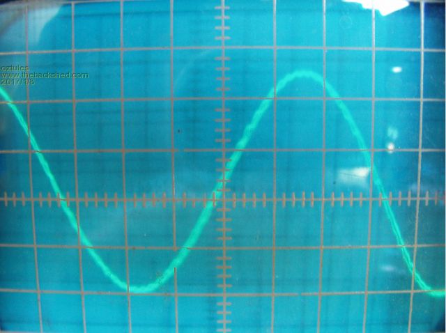

This is the same unit running 2500watts
and this is the setup
It is a bit tighter ( less fuzzy in the picture) than the idle one, so is actually improved slightly..... pretty much perfect.... with fine dimple.

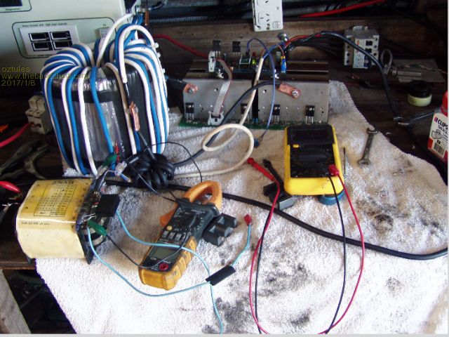

Now we run the next power board with the same control card.

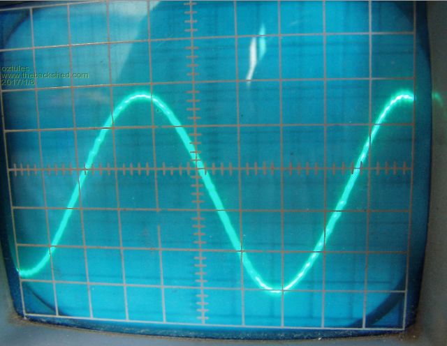

This is the idle pic 6 fets/leg to220 4110
It is pretty close to the other one. This is the setup here:
It gets interesting here. This is with 2500watts with the 6 fets.
I didn't notice the little blip until I expanded it up.... but it is there.
Now there is more to test, as this unit has not got the 4u7 filter cap on the little VFB transformer in the AC line, and I will test with the original setup later on..... but it looks like drive may be your problem.... for some reason, mine does not hardly suffer, but this unit is practically silent, and I have yet to find out why.
The camera and I don't get along too well, and I have yet to find out how to speed up the shutter ... so there is multiple traces, which makes the line look very wide and strange, but in real life is a fairly good looking trace... other times it gets half or quarter of a trace
Even at 2500w, there is only the slightest hum..... wondering it it is the cap or not... but near tea time.....
..............oztules
Edit..... no. new setup with new control card WITH the 4u7.... no difference at all... nix.
So it is not the cap, possibly the drive. Reversed the inductor from the 50hz zide to the 20khz side... no difference.
Still no reason why this setup is so quiet compared to another one I have in front of me.... keep it may even be the transformer being slightly different.... who knows.
Edit #2 yes there is a difference with and without the 4u7. With the ambient noise in the shed now much quieter, there is a very obvious difference between the two control cards with the 4u7 and without.... without is at least 12db quieter.
There is noticable heating of the inductor ring... will have to check out which one caused it.

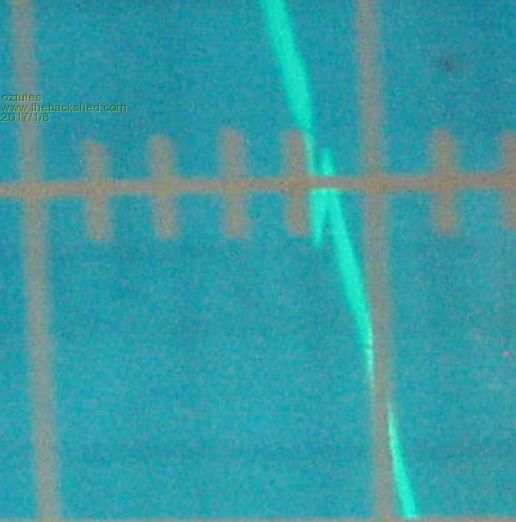

Edit 3
Here is the blemish expanded greatly at 2500 watts.... not much but there.
