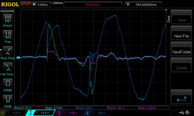

I just tried this with a 60W Apple "magsafe" macbook powersupply.
This is an offline switching PS.
Light blue is the current transformer, 10V/div and 0.095 V/Amp
The negative going peak is 30V which is 315 Amps.
The DC bulk capacitor on the HV side of this PS seems to appear
as a short circuit during the initial stage of charging.
The Purple trace is as always the 50 Amp LEM current sensor.
Blue is AC output voltage.
These short lived high current events show how important it is to over build
the mosfets. This inverter under test uses 4 x IRF3808 on each leg of the bridge
These are rated at 140A each at 25 Deg C for continuous load.
Pulse current rating is 550 A and I guess this is the max current you can put through
the device while being careful not to let the chip get "too hot"
Edited by poida 2018-03-20

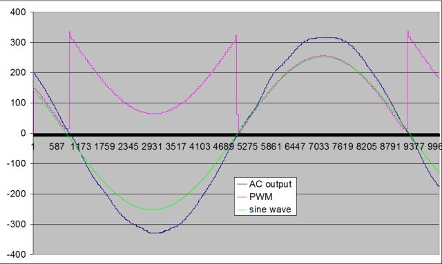

Part 19: examining EG8010 pulse width modulation
Today I show what I have found when looking at the measured PWM duty cycle
of an EG8010 based inverter board.
I wanted to look at the shape of the PWM duty cycle during a 50Hz cycle
and maybe see if it differs from a sine wave.
My prototype inverter, driven by an Arduino running custom software used
PWM duty cycles based purely on the value of a sine curve at the required angles.
With a 20Khz PWM base frequency, this leaves 200 individual PWM cycles to modulate.
I was wondering if the EG8010 was doing any special voodoo with the PWM duty cycle or just plain sine function based modulation.
First I obtained a complete 50Hz (plus a bit) output AC waveform as well as the low side 20Khz mosfet gate drive signal. The DSO I have has ample memory for this and I ended up with 3M samples of these 2 channels, plus DC current and primary winding current. The sample rate was 150 M samples /second. This is almost too much data.
A bit of VB.net code gave me a nice .csv file to import into Excel.
I resampled the 150Msamples /sec data down to only 10,000 samples to keep it
reasonable for Excel.
Dark Blue is AC output voltage, It is higher magnitude to allow a clear view of
the other 2 curves. The Excel file lets you tune it so they all line up.
Green is a pure sine wave, aligned with AC output
Purple is calculated PWM duty cycle (i.e. counts of samples of the gate drive when it is > 8V)
So it seems to me the EG8010 is using PWM duty cycle almost exactly the same
as a sine wave.
There you go.
I was always wondering what EG used and now we know.
I was hoping to maybe see some trickery (i.e. modification to sine wave) in the EG8010 PWM that might be the cause of the wobbles in AC output seen immediately after AC output voltage crosses zero. But no. This means the wobbles are electronic of origin and my idea that these wobbles are due to the injection of very high frequency pulses into the primary remains the best explanation.
I attach the excel file if you want a look at it.

Very nice poida. This is just a guess - Maybe the wobbles are due to the non-linearity of the magnetics, specially at 20KHz.Edited by tinyt 2018-04-14

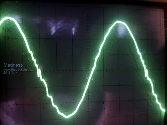

Posted: 08:46pm 13 Apr 2018
You really get into the nitty gritty of it Poida, well done.

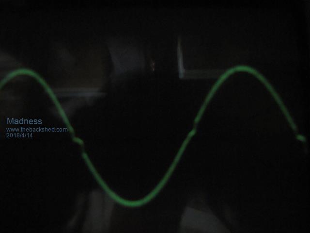

My observations of wobbles and spikes at 0 crossing are the wobbles are the result of incorrect value choke.
Sharp spikes that I experienced were from the MOSFET drive not being up to driving the number of MOSFETs I was using. Also a out of spec MOSFET could cause spikes. Since I started using Totem pole transistors to drive the MOSFETs and a different supplier of MOSFETs this problem has not come up again. I am waiting on some IR2010 driver chips to arrive to see if they make any difference compared to the IR2110s.

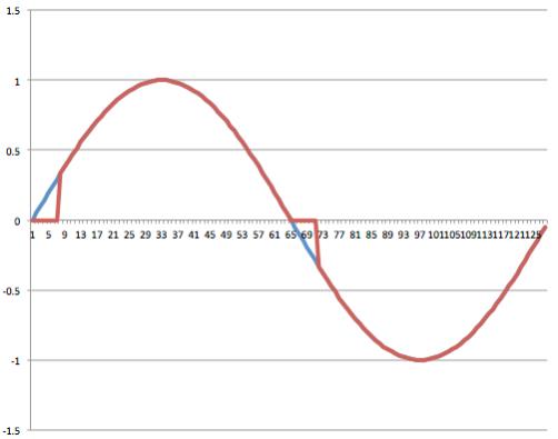

Poida, generating a PWM sine wave directly from a lookup table is fairly straightforward. What makes it much more complicated is continuously adjusting (regulating) the output voltage, and in some cases programming the output frequency up and down as well.
Its not difficult in theory to adjust the amplitude up and down, its just simple multiplication. The real difficulty is getting conventional software to do it fast enough in real time with fine enough time resolution for high frequency PWM.
The way I have done this myself long ago, was to use a dual port ram.
A basic microcontroller can do all the required number crunching, working as fast as it can go, and continuously modifies and updates a sine wave stored in a dual port ram, which is then used as a lookup table template for one complete mains cycle.
The bits stored in the ram can then be read out at a much higher speed from the second "output" port of the ram. This can produce high frequency PWM directly, using just a continuously clocked counter and a magnitude comparator. The counter clocking speed could be made variable to give a varying output sine wave frequency if that is a requirement.
The dual port ram effectively isolates the software side from the much faster hardware driven output side.
The microcontroller can chug along relatively slowly and continuously update the amplitude of the stored sine wave byte by byte completely asynchronously, and it can do that without any timing constraints. All sorts of goodies like PID control, and soft start can then readily be written into the software.
The EG chip is probably some kind of common commercial FPGA chip that works in a similar way to the above, in that the various internal functions are pipelined, with several things happening simultaneously and at different speeds.
Its the only way that I can see to get both the high speed and the very fine time resolution and include quite a few nice features all in a single low cost chip.

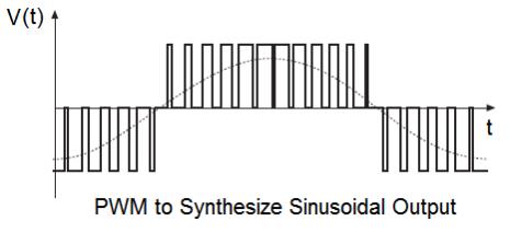

I assume we all have a clear understanding of PWM synthesis of a sine curve.
Skip all this if you know all about synthesis of the waveform, else read on if interested.
It's important to note that the sine wave is continuous, that is, it has a value
at any and all points in time.
PWM, or the duty cycle of the PWM has discrete values at any and all points in time.
It's ON or OFF.
No PWM duty cycle implies zero duty cycle (i.e approximating a zero level of a waveform)
but it can also represent an absent waveform or signal too.
There is no way to produce a continuous waveform via PWM (except in the special case of
DC which is not important to this discussion). We can produce a waveform that
is progressively more accurately approximating the continuous curve as we
increase the PWM frequency. This is akin to increasing the sample rate of a sampled continuous
signal.
In the case of the EG8010 based inverter the PWM frequency is 23.4 kHz.
My Arduino prototype produces a 20kHz PWM output. I can also make it produce
any other frequency such as 10kHz or 40kHz PWM sine wave modulated output.
Different PWM frequencies was one of the reasons why I built the prototype.
These inverters we are building and playing with use PWM to approximate a continuous sine wave.
The deficiencies of the PWM approximation are smoothed over by the filtering of the PWM
output as it is fed into the transformer.

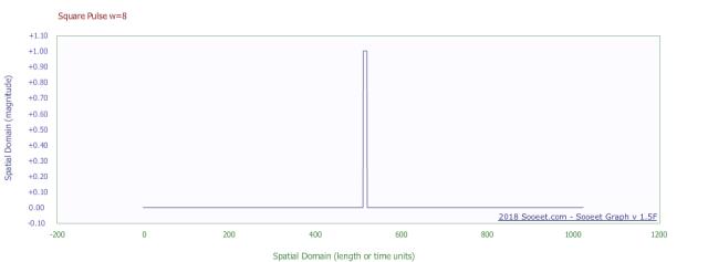

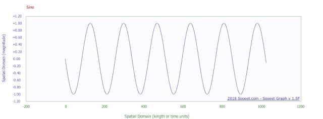

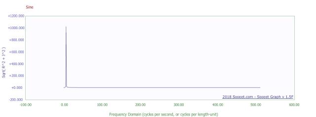

Finally I want to bring up the frequency components of a waveform.
A sine wave without very much of any other frequencies will have a power spectrum
of a single high value at one frequency and low values of power at all the others.
sine wave
fft (or graph of power v/s frequency) of sine wave
See the peak of about 1000 at the location on the X axis = 1? That is showing that
all the power of the sine wave is contained in one frequency.

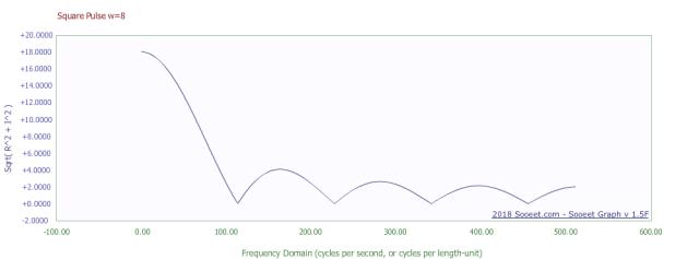

A pulse waveform is a very different fish indeed.
pulse
fft of pulse
See that there are a lot of frequencies that carry significant power levels in this pulse waveform.
PWM is nothing more than a sequence of pulses.
The high frequencies are the result of the fast changes in the signal.
We are generating signals with large amounts of high frequency power within the PWM output
of the inverter’s power bridge. The PWM is to all intents and purposes a square wave with fast edges (the rise and fall of the square wave). We are pumping into the transformer primary
a huge amount of high frequency power.

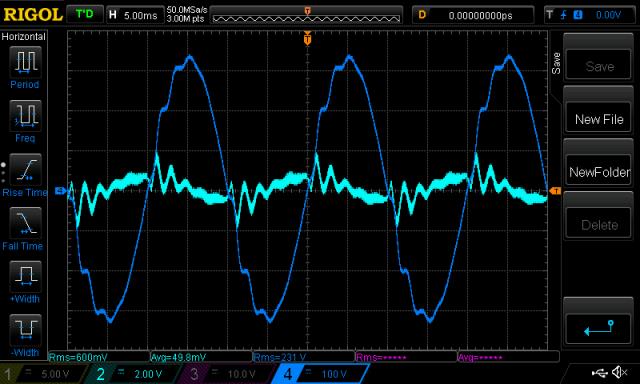

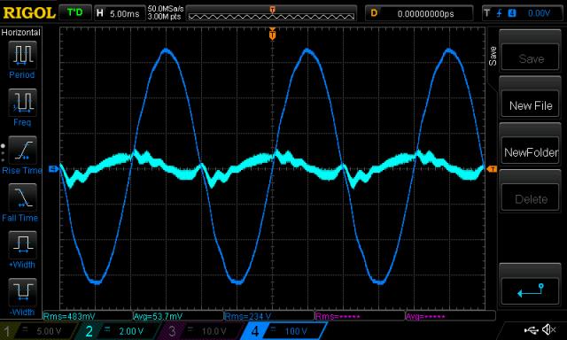

Here in this forum we have seen various people’s inverter AC waveforms, containing various
wobbles.
here
These wobbles are in my view caused by the PWM’s imperfect approximation to a
continuous sine wave and the filter. The degree of wobble and the frequencies found within the wobbles are related to the LC filter’s frequency attenuation characteristics.
I show a simple experiment, what happens to the AC output waveform when you
purposely introduce more high frequency power. In this experiment no changes were made to
anything other than modifying the PWM data in the following way:
Blue is unchanged sine wave
Red is the modified sine wave similar to what I used below…
I zeroed the first 10 of 200 values of the sine wave PWM lookup table in the Arduino code. This effectively adds a fast change to the PWM
approximated sine wave, thereby adding some more HF power.
dark blue is AC output
light blue is primary winding current.
unaltered PWM
zeroed 10 of 200
Clearly these wobbles in the AC output are due to incomplete removal of high frequency power
which is generated by PWM sine wave synthesis.
It looks like I added a fair bit of power at about 1/2ms or 500Hz by adulterating
the PWM lookup data.
Notice that in each of our inverter AC output traces, the wobbles begin after
the AC output passes through zero? This is when the PWM is zero and the first short pulse (approximating a small value of the sine wave and so it MUST BE SHORT) happens
about 50 us afterwards. We have seen (above) the power at various frequencies that is contained in a pulse signal.

The big problem with PWM is that the high frequency switching frequency (and its odd harmonics) need to be removed, to recover the desired 50Hz pure sine wave power buried underneath.
This obviously requires some low pass filtering.
Now here we must introduce some reactive components, both inductive and capacitive to achieve the low pass filtering effect.
Some of these components are deliberately introduced and obvious, and others are hidden and less obvious in that they represent stray inductances and stray capacitances due to construction and layout.
Designing an efficient low pass filter is fairly straightforward, as long as you can define the EXACT source and load impedances. The problem with an inverter is that there is NO WAY to define the load impedance. There is no way to anticipate what may be connected as a load.
It can vary between a complete open circuit, to a very low pure resistance, to crazy non linear loads that switch on and off at various points in the cycle, and highly inductive or capacitive loads of very low power factor.
So we have a big toroidal transformer that may typically have a self resonance of a few Khz, due to the very high inductance of the secondary winding, and capacitance back to the metal in the core and between turns. Then we add a series choke in the primary that will add another self resonance. And maybe even more LC filtering after that.
Then we fire up the inverter, and wonder why the output waveform has some wobbles and discontinuities on it.
Kind of like a jelly in an earthquake, it will wobble around according to its own self resonant nature, pretty much unpredictably.
If you load the bastard right down with a heavy purely resistive load, it will probably work fine and produce a nice clean sine wave.
But the real world loads are not often perfectly linear or resistive, and you are very likely going to see some kinks, wobbles, and strange weirdo output waveforms.
Trying to make an efficient low pass filter that will work into absolutely any kind of extreme load is an exercise in futility.
But in practice the grid waveform is pretty crappy and distorted anyway, so why worry ?
All your "stuff" is very likely to work perfectly well on a wobbly 230v waveform.

Warpspeed, yes I agree. Until the OzInverter is under some sort of loading then wobbles in the waveform are something I can live with.
I am concerned that just testing certain parts may not necessarily be such a good idea and could cause faults at later stages in the build.
I am definitely a 'Oztules' Fan of 'follow known procedure, check everything, assemble everything, charge the big caps on power up, and switch on'. It seems to work for me.!
interestingly, on first loading of a virgin toroid and virgin choke, both make a peculiar vibrating low frequency audible sound. 5 minutes later after a bit of loading, even a 100 watt light bulb for idle power use, the Ozinverter settles down to a very gentle quite hum!. Switched off and back on the OzInverter never makes that original virgin start up sound.
