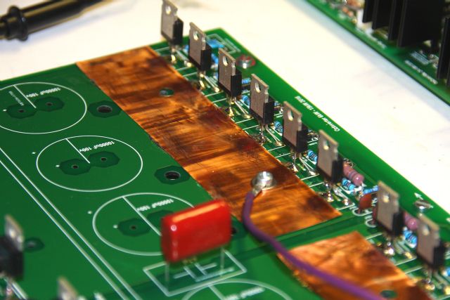

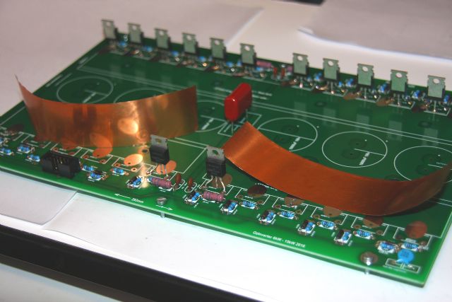

Clockman, solder mask (paint) on your boards is of good quality and hard to scrape off. Was surprised that board is not galvanized completely but only where the solder mask is missing.
Because solder mask is hard to get off I took another move and scratched only some additional joints in the middle of PCB for copper sheets. Then solder it with hot air station behind each FET and on those joints. These sheets shall provide useful contacts to both heat sinks. Board is populated with all FET's and for now operates well.

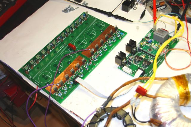

I have feeling that signal on CRO is kind of modulated. It's clearly visible on analog CRO if I shorten (remove) my choke. Lower part of sinus perhaps bit more than upper part. Have not connected output filters jet, but hope they will smooth it a bit.

Modifying the Primary heatsinks mounting may cause other issues, and boy those bits of shim are very close to the Battery cable - connections, a wandering insect and ZAP!!!!.
We are dealing with serious amps here, and the board was laid out so that moisture, insects, dust, etc issues would be limited.
I also note some of your caps and de-coupling caps are physically small in size, we deliberately overrated the voltages a bit.
If you are sure that you know what you are doing,? then that's great! but be warned these power boards are deliberately designed as they are.
Nothing with these PCB's and the OzInverter are industry standards, but if you stick to what we know that works then all should be fine.

My heat sinks are so heavy , I need to mill some kind of support plates below the PCB.

I wonder why you bother with that copper foil. It does not help unless for some reason you put insulating washers under the mosfets. The metal surface on the mosfet conducts the high current to the heat sink, it is at the same potential as the middle pin (drain). So, the aluminium heat sink is the big current conductor with this design, three of the 4 power wires terminate on the heat sinks.
Only the common (ground) high power wire is connected on the PCB. That should be rather wide and have very big tracks to each source leg. I am not familiar with the way this is done on the OZ board design.
And, unless you tin that copper foil the shiny red surface will over time cover with high resistance oxide.
If you want to see how I did it differently check the latest pictures in my post 'building an inverter from scratch'.
If compactness is not a problem then I suggest you look at the way I located the large capacitors. For some strange reason many copied the original Chinese board layout which puts the caps in a heat tunnel between the heatsink fins. About the worst place for them to be from a long life perspective. And, putting them on the other side of the PCB, you can leave all heatsink fins large, no need to trim some short. The cooler you can run this inverter the better.
Of course, that is if you plan to design your own PCB. With your bought OZinverter boards it may be best to put it together as it was designed. I see little reason to 'improve' it, it works fine.
Then, when you got it working satisfactory, and the inverter building bug has you still in its grasp, you could start designing your own boards and let the fun begin...
BTW, PCB's have the tracks 'tinned' (with solder), not galvanised, which is used on steel to prevent it rusting .

Klaus, thanks for explanation and sorry for my English. I have real problems to express my self properly. Of course I mean tinned... and they are not. It would be better if they were, but I know not every PCB manufacturer do it that way.
About small heat sinks I see situation a bit differently. Yes they are good current conductor regardless Aluminium for the 6 FETs mounted on them, but the middle pin (Drain) goes to the other side of the board on to Source pins of other 6 FETs. That current will in case of insulation on PCB flow only trough tiny middle pins. On the other hand, the large heat sink is on its copper (bottom) plane with few screws that helps sharing current. I see here asymmetrical operation inside the bridge under high loads. Therefor my experiment with copper foil.
I'm real sorry if I "upset" some on the forum, it was only my thinking how to balance current flow ... I din't mean anything bad.
You might like to think about ordering your next set of boards with 2mm fiberglass.
Going up from 1.6mm to 2mm thickness does not sound like a lot, but its a great deal stiffer especially for larger boards.
Another possibility would be to add some plastic feet under each heatsink.
That would carry most of the weight directly.
The screws that bolt the board to the heatsink could be made longer to pass through some plastic feet. The screw heads are often deeply recessed into the feet, so shorts through the feet are not a problem.
Nylon screws and nuts and washers can sometimes be very useful for bolting things together that need to be insulated from each other.
Another very useful material for assembling physically large or heavy electronics is fiberglass angle. This is sometimes called "pultruded angle" its not always easy to find, but it is available if you search. Just one example of what I am talking about:
http://www.libertypultrusions.com/pultrusion-products/angles/
Large electrical wholesalers that supply electrical contractors and electricians often stock a limited range of pultruded angle.
Its expensive in the larger sizes and more unusual shapes, but the very common 25mm x 25mm x 3mm angle is not that expensive. Its very easy to cut and drill and great stuff to work with. Its also surprisingly light and stiff and strong.
Bolting a couple of pieces of fiberglass flat or angle between the heatsinks to tie everything together would really stiffen it all up.Edited by Warpspeed 2017-10-12

Yes Tony, I will probably do some kind of prolonged feet in the middle and at the ends of board. Teflon or some other heat resistant material will be used. Have plenty of them at home, left over from microwave projects. Machinery is also there for turning, milling, CNC, etc. So no excuse not to do it

I fit a sheet of 5mm plastic to the top of the heat sink with drilled and tapped m4 screw in the face of the heatsink. This makes it very rigid when assembled.

I see what you mean by the high current having to traverse the small Mosfet pins at each side of the board. On my own PCB the drain current travels via the heat sink and 6 x 4mm screws (one for each Mosfet) to a very large 2oz copper PCB plane and thence to the other side of the PCB. From there it obviously has to go via the source pin to the relevant Mosfet but I made the tracks there very large. They easily coped with a 6KW load, spread over 24 Mosfets.
I'm not sure if your foil addition is practical in the long run, remember that dissimilar metals in contact, like copper and alu, act like a tiny battery with the alu being eaten away. I would be wary using bare copper.
