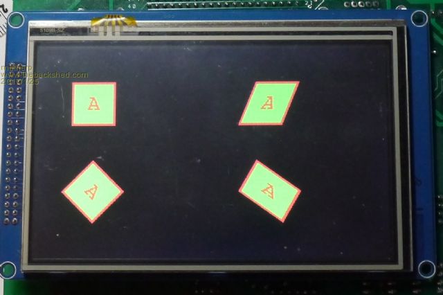

Probably not much use but an interesting academic exercise
This code snippet uses the "three-shear" method to rotate an image. The method works for angles between -45 and 45 degrees and is explained nicely here
It could be used to rotate text to specific angles, for example to draw a compass rose, and then position the images on the screen as part of drawing a fixed background.

' first shear
pause 4000
for i=-max to max
shear = cint(i*alpha)
blit xo-max,yo+i,xn-max+shear,yo+i,max*2,1
next i
pause 2000
' second shear
for i=-max to max
shear = cint(i*beta)
blit xn+i,yo-max,xn+i,yn-max+shear,1,max*2
next i
pause 2000
' third shear
for i=-max to max
blit xn-max,yn+i,xo-max+shear,yn+i,max*2,1
next i
pause 2000
