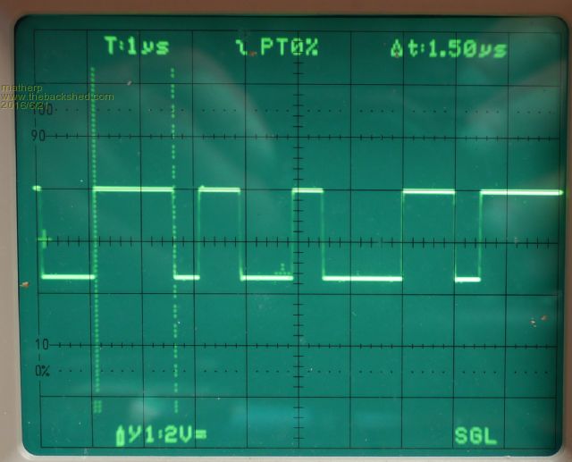

Prompted by a PM about the DMX protocol I've written a very simple CSUB that can generate any arbitrary sequence of bits.
Usage is simplicity itself:
Set up the pin as an output and set it to the required initial condition high or low
set up an array of bit lengths in micro-seconds expressed as floating point numbers
call the bitbanger CSUB
At the end of each bit duration the CSUB will invert the output so you need to specify both the on and off durations.
The CSUB takes care of things like CPU speed but of course the faster the CPU the more accurate the bit lengths
If an even number of bits is specified the output is left in the same state as it started. An odd number will result in it ending up inverted. In both cases the last duration specified does not result in a transition but must be included to terminate the CSUB
The picture is the result of the example code

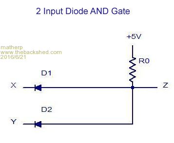

this looks like an extremely useful bit of code. i was wondering: how hard would it be to modify the function just a fraction, so that if the pin specified was already configured as a PWM output, then instead of inverting the pin at the completion of each 'step', instead the PWM was turned on/off?
this would allow an IR LED to be attached to the pin specified, in order to generate infrared remote control codes. the application i am thinking of is using a micromite to create a replacement for a heatpump remote control (with simplified operation compared to the original remote), though it could be generalized to any IR control application where you could uncover the timing.
rob :-)
Posts: 11930
Posted: 03:31am 21 Jun 2016
  Quote  how hard would it be to modify the function just a fraction, so that if the pin specified was already configured as a PWM output, then instead of inverting the pin at the completion of each 'step', instead the PWM was turned on/off?
Easiest way of doing this is a simple discrete logic AND of a continuous PWM and the bit sequence
