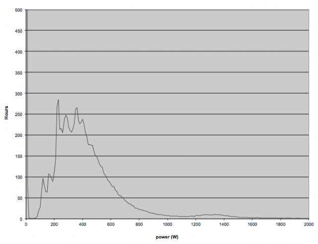

Part 10: sizing the inverter for my particular requirements and efficiency concerns
Given:
- the cost of power is only going to increase, and faster than CPI
- zero political desire or capability to reduce these cost increases
- gas is also only going to go up in price, faster than CPI for the same reasons.
- I live in Melbourne, this means lots of cloudy skies
- (this may be very controversial) we are headed for the mother of all economic depressions when the house market collapses, taking banks, personal savings, jobs, etc with it
- I have some savings in one of the big 4 banks
I thought
- make a solar power system.
- go for the easy 75% of value return, not 100% which would get costly.
- accept I will never supply 100% in Melbourne. About 30kW array needed plus a huge battery.
- get a ROI at 10-15 years.
- slowly transition to a house using less high power things. We use electric cooktop, microwave, clothes iron, kettle. This can be reduced as items need replacement.
- get some money out of the bank so I don't loose it when we all “bail-in” the banks.

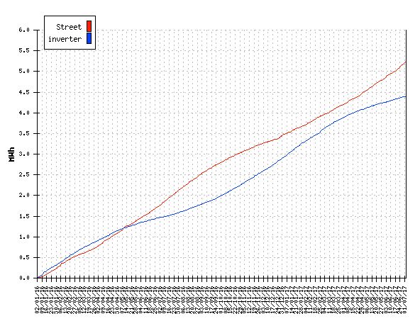

So I have a 3kW solar array, feeding a 400Ah 48V battery.
All data is logged to non-volatile storage every 2 minutes.
I have 1 1/2 years of data showing street power and inverter supplied power consumed by my house. Looking at it gives me clear guidance in inverter sizing.
First, see the total energy consumed by the house from Jan 2016 to date, there are two lines here. Note my solar system can supply nearly 1/2 house needs. But when Winter comes, forget about it. Not even close.
But with 4.5MwHr self supplied, I can say this has returned me 4,500 x $0.29/kWhr (my rate) or $1,300 for this hybrid system.

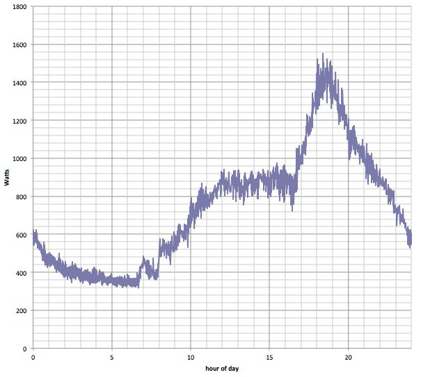

Let’s have a look at the average power consumption level at any time in the 24 hr day.
It shows me that I need 1500W on average peak power, around 19:00 or 7pm which is when we cook. That is why the peak is at that time. We have a tropical fish tank too. Hence the high night time power levels.
The house spends a lot of time less than 1000W. I like to imagine how it would look if we installed a gas cooktop and oven and gave the fish away.
This is about 18kWhr/day average house consumption.

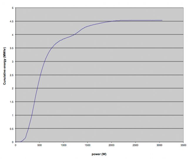

Now, here is the total time (in 2 minute slices, added together) the inverter has spent at various power levels. The inverter is a Victron 3000VA inverter/charger.
It is clear to me that I need to build a replacement inverter that is optimised for power levels up to 700W because it spends more than 90% of it’s time running at these levels.
Finally here is the cumulative energy total, as you totalise the different inverter power outputs. The small time spent at 1000W and more needs to be carefully designed so as to not kill the total efficiency equation.
If the about 500kWhr made at 1500W levels is at an efficiency of 85% only, then
that is 75kWh loss. The 3000kWhr made at 93% (which I am demonstrating right now on my bench) means I lose 210 kWh while operating in that regime.
So it’s 1/4 lost at high levels and 3/4 lost at low levels of inverter output.
Consequentially I am designing a replacement for the Victron that is 93% at 700W but can handle peaks in excess of 3000VA.
I'm currently obsessed by mosfet switching and cross conduction. This is where I can find further efficiency gains. A post on this subject will come when it is ready.
Edited by poida 2017-07-04

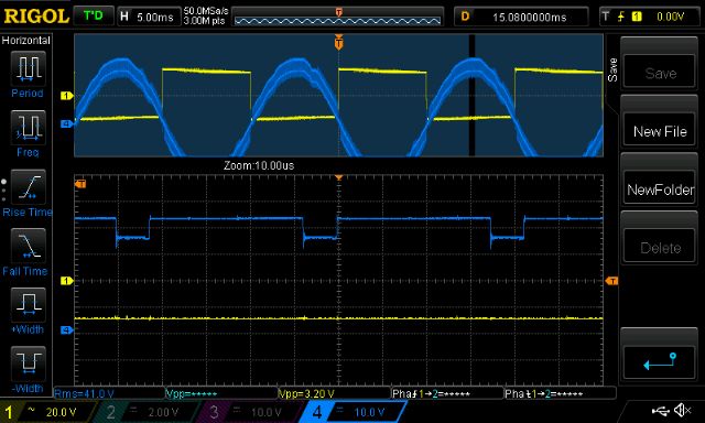

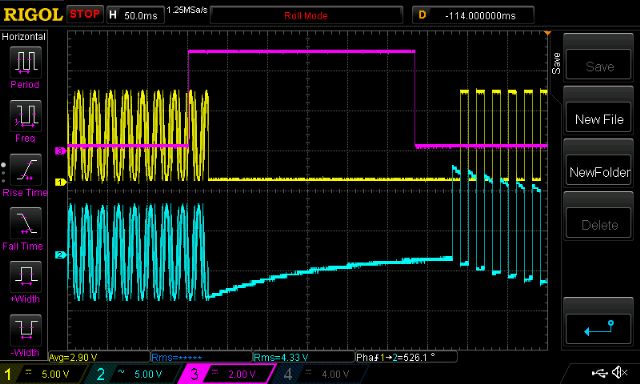

Part 11: how does the PWM thing work? Just the basic idea..
These inverters we are making and exploring take a DC power source and convert it into
an AC output, fed into the primary winding of a transformer.
See the below circuit, taken from
Tinker's post
I see the circuit as having 4 switches, named 1LO, 1HO, 2LO and 2HO
When using the EG8010 or EGS002 parts, 1LO and 1HO drive the 50Hz output and 2LO, 2HO drive the 20Khz PWM output.
It's important for my understanding to choose a reference point for all measurements.
I choose DC ground.
IF you put a oscilloscope probe on Pr1 with the probe grounded to DC supply ground you will see
a 50Hz square wave - nearly all the signal will consist of 50Hz square wave, the low 1/2 cycle being close to ground volts and the high 1/2 cycle close to DC bus supply volts.
Put another probe on Pr2 (also this signal is relative to DC supply ground)
This will have a 20KHz square wave running with differing duty cycles depending on where in the 1/2 50Hz cycle you are looking.
(the high frequency PWM signal is a 20KHz square wave with positive duty cycle percentage times varying from sin(0) to sin(90 deg) then back to zero. The inverter power output is controlled by a factor that is multiplied to the sin().
Typically my inverter runs at 70% modulation with zero loads. The modulation factor starts at zero at the start of the 3 second soft-start
then it increases during the 3 seconds to some value that results in the desired AC voltage output as seen by the feedback network)
At steady state running, with the inverter producing it's expected AC output voltage you will see
again a signal at Pr2 that exists primarily at only two values, ground and DC supply.

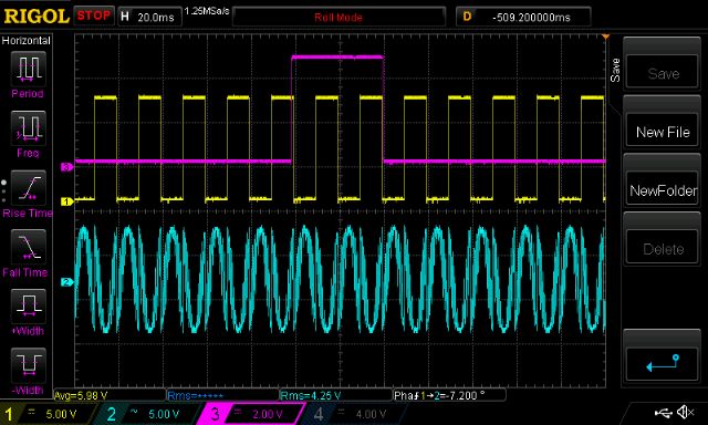

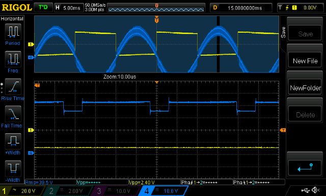

With a DSO (digital storage oscilloscope) you can quite easily capture portions of the PWM generated for the gate drives.
The transformer primary winding sees the voltage difference between Pr1 and Pr2.
We can easily see what this difference looks like with the oscilloscope
(my DSO has a simulated low pass filter I can apply to a signal and I can perform math functions on 2 signals.)

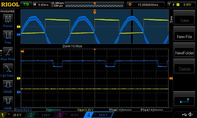

See the following DSO captures
Yellow is the voltage at Pr1
Light Blue is that at Pr2 after passing through a low pass filter.
Purple is (Pr1 - Pr2) i.e. what the transformer gets.
First is where there is zero modulation of the SPWM, leaving the difference = nearly zero.
The primary winding sees differing absolute voltages, changing each 1/2 cycle of the 50 Hz but it sees
nearly zero difference in the two signals.

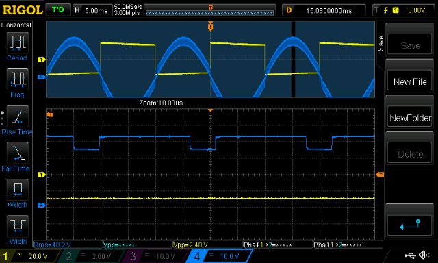

Next I modulate the SPWM to about 10% max, and we see a small sine wave appear on the purple trace.
Subsequent images show increasing modulation of the SPWM.

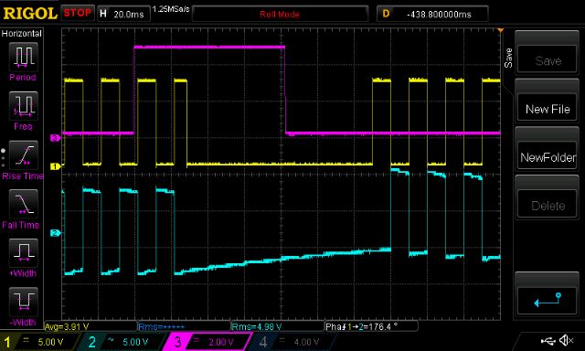

Notice the shape of the high frequency PWM signal (Pr2). See how within one of the 50Hz 1/2 cycles it appears as
a 1/2 of a sine wave? This makes sense since the primary winding sees
the result of (Pr1 - Pr2) which is a sine wave portion going from zero to negative DC bus and back to zero.
The other half of the cycle is a bit strange. Pr1 = Yellow and is at DC bus voltage.
The SPWM is in fact (1 - sin) and so Pr2 starts out at DC bus voltage, reducing down to zero and returning to DC bus.
The primary winding sees the difference of this which is (Pr1 - Pr2) and so thats the positive sine wave half we see in purple.
This is how we can apply an alternating current (going from +DCbus x modulation% to -DCbus x modulation %) to the primary winding.

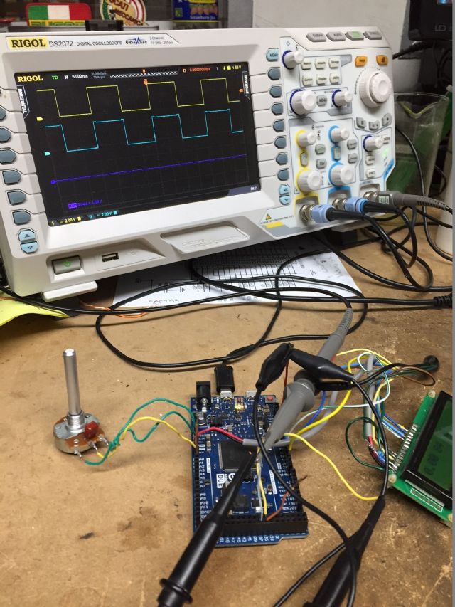

This can easily be done by anyone with a reasonable oscilloscope and an Arduino
I used in this case an Arduino Due (I'm playing with dead-time concepts at the moment)
Here is the code. Attach a potentiometer to A0 to be able to control the modulation %
It includes my very good Bessel 4 pole low pass filter code, which is not used right now.

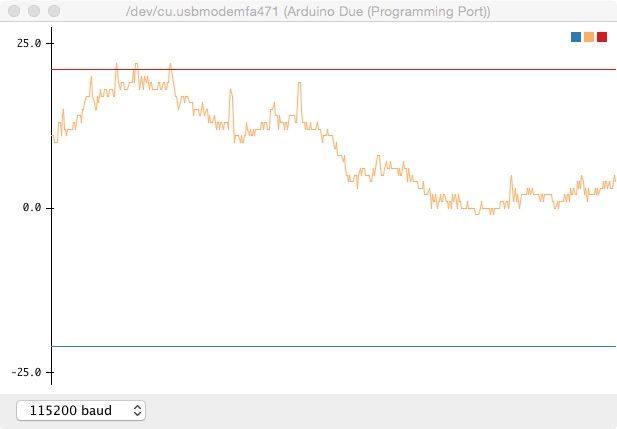

A sneak preview of work in progress:
I have very robust phase lock loop code running on an Arduino Due.
It locks very reliably onto any sync signal from 49Hz to 51Hz
I am feeding it a low voltage sample of my street power.
It locks onto this perfectly well.
The image is a plot of the pll frequency correction factor when tracking the "50Hz" mains.
The upper line corresponds to 50.13Hz, the lower to 49.87Hz.
The view shows about 4 minutes of data. See how much the mains power frequency changes.
The abrupt steps of about 1 or 2 units is due to the PLL loop control and it's slightly noisy performance.
I will post more fully on this subject at a later date.
This work is part of an effort to make a small add-on board for the EG8010 to provide a
clock that will ensure PLL locked AC output as generated by the inverter.
If the inverter output is in phase with street power, when the transfer switch operates it might create far less stress in the inverter and household appliances.

It's honestly rather similar to a PD control loop.
This seems simple enough, how to do it with a microcontroller...
We will feel the full force of the consequences of digital signal sampling from now on.
How I did it was as follows:
1 - sample both the sync signal and the slave signal at a certain rate. In this case it's 200 Hz.
2 - scale and offset the samples to be bipolar, eg the mid point of the sine wave samples will now be zero.
3 - multiply the two samples, and scale result by the loop gain.
4 - put this number into a decent low pass filter, to remove the high frequency product of the multiplication but let the low frequency parts through.
5 - Now use the filtered result and use a portion of it to correct the slave's output frequency
6 - We also need to correct the slave's output freq with a bit of the frequency error.
7 - go to 1
This is easy to implement in code. I will attach working code for both Arduino Uno and Due.
Particular details of the code:
step 1,2
Samples of the sync signal from the ADC range from 0 to 1024 (Uno) and 0 - 4096 (Due)
These need to be level shifted so the signal varies from (-1/2 ADC range) to (+1/2 ADC range) for the phase detection arithmetic
to work. This is easy to do and I code max and min tracking variables to give me the best level shift possible.
step 3,4
Time to do some floating point and even the Uno is fast enough!
The LP filter has to be given input with frequencies less than 1/2 the sample rate for it to work properly.
The sample rate is 200Hz so if we limit our system to have sync and slave frequencies of about 50Hz +/- 1 Hz we should be OK.
The street supply 50Hz is quite well regulated and only varies about +/- 0.12 Hz over the long term of a day or so.
This means the phase detector's LP filtered output will be a signal with frequencies something around DC to +/- 0.12 Hz.
We need to configure the LP filter to have near 100% removal of the 100Hz tone of the phase detector and I use my trusty
2 pole Butterworth biquad filter to achive this. (See previous posts of mine in this thread. I used the filter in my arduino uno inverter
controller to clean up the AC output feedback)
In my case I choose a filter cutoff of 0.02 with 200 Hz sample rate, this means the cutoff (-3db) is at 0.02 x 200 Hz or 4Hz
This is great since it lets the 0.0 to 0.12 Hz signal through without any loss but the 100Hz signal will be cut to less than -80db. (about 1/10,000th)
step 5
maintain a running total of the correction, which starts out at zero but can be any value positive or negative.
call it "plllint" for phase lock loop loop integral...
We need a measure of the frequency difference. Funnily enough, we can get the frequency difference between the sync and slave by looking at the
change in phase error with respect to time. So if you keep a copy of the phase error from last time in the pll code run, you will have the
frequency_difference = (current_phase_error - past_phase_error)/some_time_constant. And after this, let past_phase_error = current_phase_error, ready for the next
time through the loop.
step 6
I adjust plllint by adding a small part of the phase error and a small part of the frequency difference to it.
Then convert this error integral to integer, ready for altering the slave frequency generator clock rate.
That's about it. The Uno runs fine, doing the pll calculations in un-interruped time with ease. The Due is about 20x faster and has more complicated
programming for the timer interrupts.
How to obtain a suitable sample of the mains AC?
I use a 9V AC plug pack, AC couple it with a 1000uF 25V cap, put a diode across the output. On the cathode will be the positive waveform, the anode will be zero or ground.
I divide the voltage using a potentiometer. This works fine for me. I feed this into the ADC input. Search for "DC restorer"
How to obtain a suitable sample of the slave?
Really easy, since the slave output is a sine wave, read from a lookup table via a circular counter, just look up the current sine table value
that was last sent to the DAC.
One point to note is a PLL syncronises the slave to the sync with a 90 deg offset. So to get your slave in sync with zero offset,
you instead offset the slave value that is fed into the PLL loop by -90 deg.
It's all clear in the code.
For the application of getting mains sync with the EGS002, I would need to use the output of the PLL to control a voltage controlled oscillator which would be used to drive the EG8010 instead of the onboard crystal. And we need to get a 270 deg phase shift of the mains too.
But I plan to use my own systems in the inverters from now on.
#define cbi(sfr, bit) (_SFR_BYTE(sfr) &= ~_BV(bit))
#define sbi(sfr, bit) (_SFR_BYTE(sfr) |= _BV(bit))

Serial.begin(115200);
Serial.println("");
Serial.println("");
np = 2;
loopgain = 0.001;
get_biquad(0.02);
lm = millis();
void loop()
while ( (millis() - lm) < 5) // 200Hz
lm = millis();
do_pll();
void do_pll()
float a,b,fj,fk,s;
int i,j,k;
// get 90 deg early sample of output sine. sine table is 200 samples per 2 pi cycle, so 150 samples = 1/4 wave early
i = sc + 149; // i = circular buffer counter + 1/4 full wave
if (i > 199) i = i - 199; // it will overflow, so wrap around if needed
j = pgm_read_word(&si) - 2048; // both snyc and slave are now assumed to be full scale -2048 <= input < 2048
// get sync signal
k = 4 * analogRead(0) - 2048; // i.e. bipolar
// phase detection and loop gain
plllc = (float)j * (float)k * loopgain;
// Butterworth biquad LP filter the phase. This filters out the high freq rubbish we don't want to feedback into the loop
s = plllc;
for(i=0; i<np; ++i)
w0 = d1*w1 + d2*w2 + s;
s = aa*(w0 + 2.0*w1 + w2);
w2 = w1;
w1 = w0;
plllc = s;
// concoct a special feedback value, to be used to adjust the slave sine wave frequency.
// maintain a running total of adjustments, each time adding a small fraction of the phase error
// and a small part of the frequency error. Frequency = the change of phase over time.
pllint += plllc * 0.0001 + (plllc - oldplllc)*0.01;
// convert to int for fast wave table clock updates
pint = (int)pllint;
// get something to plot for the humans to see so they think they are controlling this process.
String withScale = "-21 ";
withScale += pint;
withScale += " 21"; // use "serial plotter" to watch it sync up
Serial.println(withScale); // and follow mains variations

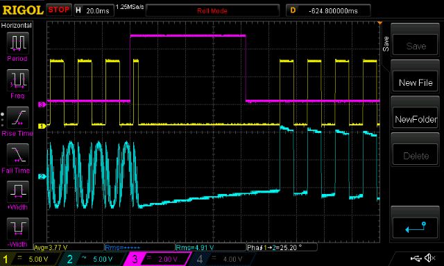

Part 14: EG8010 Tfb signal behaviour
After the less than satisfactory performance of the second Aliexpress inverter board, failing after less than 24 hrs when under a load much less than 1000VA I wanted to make things simple.This meant I wanted to remove all chance the EG8010 would stop PWM suddenly.
OZtules has a good understanding of the pitfalls of letting the EG002 board control gate drive IC shutdown, or control PWM output via current feedback.
I wanted to start from the position of zero current feedback limit. I intend to deal with that eventually via a microcontroller.
Oztules uses the Temperature feedback pin to control both simple on/off and over current situations. I wanted to see how Tfb works….
So I set up an EGS002 board on the breadboard with Vfb getting 3.020V to make the EG8010 soft start and remain on. Into Tfb I feed a 5V pulse once every 10 seconds or so or varying widths. I want to see what’s happening.
In the following you will see
Purple: Tfb signal
Yellow: 50Hz
light Blue: High side SPWM (sine pulse width modulation)
(I use the “high res” sample function of the DSO, which applies a low pass filter to the inputs. So we see a sort of sine wave here.)
We can see the EG8010 stops the SPWM in mid cycle some random time after Tfb goes high. I saw many examples of this, nearly always the SPWM stops mid cycle.
After Tfb drops below the trigger voltage, SWPM restarts, under soft start control.
The 50Hz does not stop.
There is a minimum Tfb high pulse width that will trigger the stop of SPWM.
It seems to be about 30 - 40ms.
pulse not wide enough:
all that follow have the pulse wide enough.
this is what happens if the soft start is still ramping up.
Purple: Tfb signal
Yellow and light Blue: High and Low side SPWM
I hope this is of some interest to us here.

Part 15: When 47uH is not the same as 47uH
I have had some good times and bad times with my home brew, most poorly finished inverter. The main power board is one of these
3 x Hy4008 210 Amp mosfets per leg of the H bridge.
I enjoyed approximately 2 1/2 weeks life from the first unit.
I bought another one and it went for less than 24 hrs.
The bag of spare HY4008’s arrived shortly afterwards so I replaced all, checked gate diode and resistors, etc, replaced the EGS002 since it had blown both the IR2110 and the EG8010 and gave it another go.
It lasted not quite 2 days.
Something is wrong.
I modify the EGS002 so that there is no current limit control, the only way it switches on is via the 5V supply coming up, causing the 3 sec slow start. The only way it goes off is when the 5V comes down. No cause for concern.

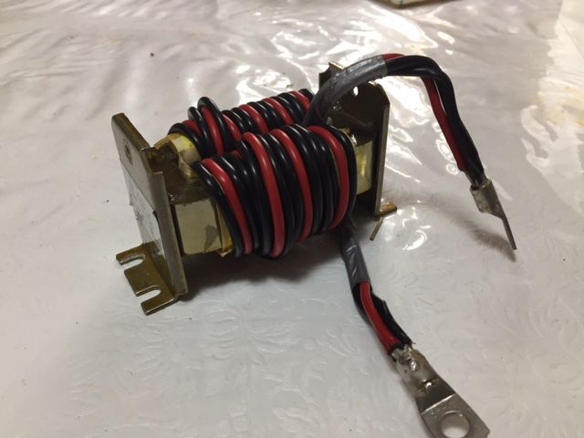

I use an Aerosharp 1500VA inductor core, with 13 turns of 3 x 6mm cable.
This gives me 47uH and a very low ESR.
The board feeds a 37V primary on a 3kVA Areosharp toroid. There is a 47uH choke in series. The secondary has a 5uF 450V cap, then via a 16A CB to a dual GPO.
After rebuilding the better looking of the two boards, again needing a new EGS002, I put the DSO on the primary winding, NOT the output of the inverter board. This means the two probe points are the two primary winding terminals, one of which is where the choke connects.
I was wondering what is causing the failure.
The boards last for days then fail. This means it’s not a simple design fault.
The problem is more to do with operating limits of components exceeded.
Yellow is low side gate drive, used for sync.
Blue is primary winding voltage.
First we see the Aerosharp choke at idle and under approx 400W load.
See the overshoot and undershoot on each transition from on-off and off-on.
idle
load
Next is the E65/32/27 ferrite core with 1.5mm gap, also 47uH.
There is no over/undershoot at all.
idle
load
It does not seem much but it is clear to me there is a difference when I connect one or the other 47uH choke.
Last night I saw the inverter deal with a large load, bordering on short circuit and survive when the defective blower fan of the wood heater was switched in. I doubt it would have made it through that event without blowing up.
I used the Areosharp choke on the bench when bringing up another but different inverter board, this time using 5 x HY1908 (90 Amp) per leg. Usual test conditions (EGS002 with soft start, no current control, 27V DC, 1500VA toriod, 140W load)
It started OK with no load. I switched in the 140W test load a few times and one leg at least has blown. I have not damaged any boards on the bench before.
It’s so easy to damage things by exceeding something. I think it’s not about current limits being exceeded, I think it’s a excessive voltage thing.
The E core ferrite choke is appearing to me to be the magic sauce in the home brew inverter. They reduce the speed of the fast voltage changes seen by the 4 legs of the H bridge. These voltages correspond to Vds or the voltage between drain and source. Admittedly most modern mosfets have construction such that they can widthstand voltage larger than Vds (called “avalanche”) but I think there are limits to how much energy can be absorbed before failure. Fast voltage changes also contribute to cross conduction thanks to dv/dt inducted turn-on. I wonder..
In summary, I think I found the cause of the 3 failures of the inverter boards.
Iron cored chokes. Use Ferrite cores due to their capacity to reduce high frequency energy passing through. Even if the iron core choke inductance seems enough, they pass too much high frequency energy. This characteristic is not shown with the inductor testing we do. I attempted to show how inductance changes with frequency testing at 1kHz, 10kHz, 100kHz and 1MHz but my skills were not up to the task. I saw small changes in inductance but not enough at 1MHz to explain the iron core's difference. MAybe I need to go to 10MHz..dunno.
I may have spoken too soon and this board no.4 will fail tonight. (Murphy’s Law)
I’m OK with that, it will force me to look harder, think better and keep learning.

Poida, i dont know if it of any relevance, but i had a 10kw inverter (based on the PJ control card) and i could not get it to work... blew every power board i threw at it (many mosfets met there doom) but on the smaller transformers i was testing with it would run fine, as soon as i connected it to the monster transformer it would self destruct. They had the same " voltage " input/output and the big tranny was professionally wound... i spent months trying to figure out why it would blow up. Even with brand new PJ gear it would last tops a day...
To cut a very long and painful story short, i ended up (under advice sort of) putting 10 .1 ohm resistors ( so .01 ohm total resistance ) in series with the primary. .. that thing has seen over 11.5 kw for over half an hour without missing a beat..😎Edited by noneyabussiness 2017-10-24
I think it works !!
Posted: 12:24am 23 Oct 2017
Now that is interesting.
With my dual stack toroid I used very heavy gauge cables, two in parallel, to wire up the primary and battery connections.
It blew all the Mosfets on switch on.
Tinkered with it for a while, smaller toroid, different drivers, less capacitors, you name it, but just had mixed success. Nothing I would call reliable.
I then re built the whole caboodle in the usual one long, two short heat sink configuration and it ran over 6KW.
BUT, that was with much longer cables to the battery and primary & 2 chokes, as in a rough bench top test set up.
It should not be too hard to introduce 0.01 Ohm in series, just a steel washer between the connection lugs would do I should think.
I shall try that when I connect it all up again (making a case for it presently) and see what happens.
I won't double up with the inter connection cables either this time.
