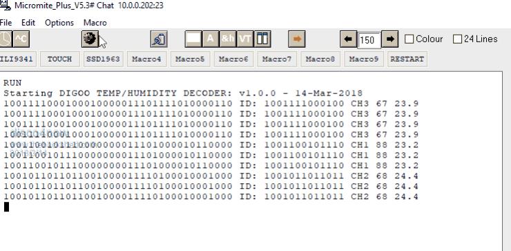

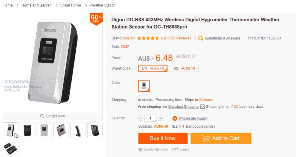

This remote temperature and humidity sensor may be of interest. I have had three connected to the weather station that is available to match them.
Digoo Remote Sensor
$AU6.48 so price is good. I have one for some time and have not had to replaced the batteries on the remote sensor so seem to last pretty well.(Just looked it up just over 1 year on same batteries and still going)
I originally got them with the idea of decoding the 433mhz signal and putting the data into my own weather station. As each unit has a unique code you could connect several.
After a bit of inspiration from an idea from @tassiejim on here I have managed to decode the signal on a micromite using a 433mhz receiver.

' The DIGOO remote sensor sends code to the console station via 433.92MHz ASK code.
' It can be decoded by using a 433.92 reciever connected to a digital pin eg(16).
' The code seems to take this format.
' bits 1-13 are unique ID for the unit.
' bit 14 indicates that the message was sent using the test button
' bits 15-16 used to identify the channel selected on the remote. CH1-CH3.
' bits 17-28 contain the temperature. if bit 17 is 0 is a positve temperature and value is divided by 10
' If bit 17 is 1 then is a negative temperature and twos compliment is used and divided by 10.
' bits 30-36 are the percentage humidity
' Inspection of the recieved shows the signal is repeated three times and
' a 1 is about 4ms low pulse. 0 is about 2ms low pulse. stop is about 8ms low pulse.

disco4now
Joined: 18/12/2014
Posts: 1162
Posted: 10:35am 16 Mar 2018

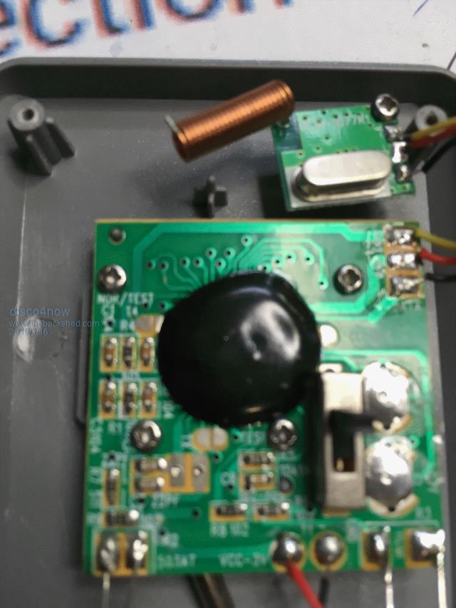

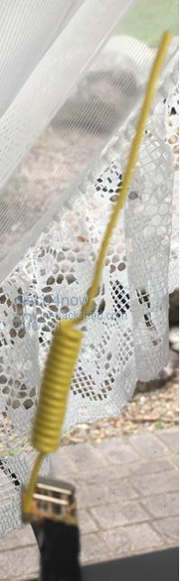

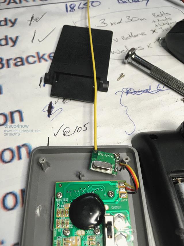

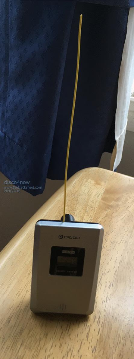

I have managed to improve the reception range so these remote sensors may be useful with the micromite.
I removed the coil antenna on the receiver and replaced with 17cm wire. This gave some improvement.
I opened up one of the remote sensors and the transmitter is a separate unit near the top.
It is easy to remove the coil antenna and add a straight 17cm wire.
This set up greatly improves the range. I am receiving from a couple of rooms away and one from outside, so getting to the useful range.
regards
Gerry
F4 H7FotSF4xGT

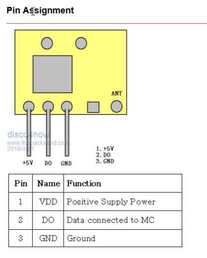

Hi Frank,
Here is a diagram showing where the antenna is connected.
Found it here.
I am using this loaded antenna from here. A straight 17.3cm wire also seems to work.
Loaded Antenna
Gerry
