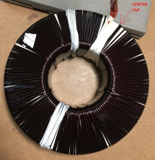

Started working on the datatel elektronik toroid. It has the following ratings: 153V 50-60Hz, 230V/9.6A. (2.2KVA?). Using a variac and temporarily wound 20 turns, I calculated that it has 1 turn per volt winding.
Started de-mummifying:
The 153 vac outer winding is 2 in hand awg #12, followed by an electrostatic shield and finally the single layer 230 vac awg #11. I removed the outer and shield windings and retained the inner 230 vac winding. Applying 100 vac to the 230 vac winding, I located the center tap by looking for the mid-voltage with a voltmeter connected to one end of the winding and the other voltmeter probe attached to an X-acto knife blade. With the sharp tip of the blade, I poked thru the insulation of the magnet wire looking for a mid-voltage reading. The center tap measured 50 vac, but the wire beside it measured 99 vac. I think the winding is split-return type as the center-tap is close to the start/end of the winding. See picture.
I cut the center tap giving me 2 isolated and equal voltage windings which I can configure for 115 vac or 230 vac. For 115 vac, I will connect the two in parallel.
I guesstimate that the core has the following dimensions: ID = 3.5"(89mm), OD = 7.5"(190mm), HT = 2"(50.8mm) giving a core cross section of 2" x 2" = 4 sq. in. (2580 sq mm), maybe my estimated dimensions are a little bit conservative. The toroid ID with its exposed 230 vac winding is about 3.125"(79mm). If I add the 26 vac winding now, there will be a lot of wasted space in the toroid ID. So I plan to add another layer(s) of two 115 vac windings and adjust the cross section area of the 26 vac wire.
I used a variac and measured the no load current draw at various voltages:
VAC No Load Current Watts

So, I am guessing that the core will be able to handle higher power output than 2.2KVA before saturating. The 60 Hz instead of 50 Hz will probably also help.

I have a single core with similar dimensions but 70MM high, it runs fine at 4KW with cooling, you can probably expect around 3KW.
Posted: 04:49am 04 Jun 2018
  Quote  So, I am guessing that the core will be able to handle higher power output than 2.2KVA before saturating.
Saturation only occurs if you apply too higher a voltage, together with too few turns. It has nothing to do with current or power output. Flux density remains constant from zero load to maximum load.
Output current is limited only by heating of the wire, thicker wire allows more current and gives a higher power capability.
A reasonable guide to current capability would be about four amps per square millimeter of wire cross sectional area.
I am guessing here, but assume 1.8mm diameter wire.
Pi R squared = 3.142 x 0.9 x 0.9 = 2.54 mm area.
2.54mm area x 4 amps = 10.16 amps
10.16 amps x 230v = 2.337 watts.Edited by Warpspeed 2018-06-05

From the wire table, the existing awg #11 230V winding is 4.17 sq.mm. So, it is capable of around 16.68 amps. So if I re-use the awg #12 outer winding that I removed for an additional 230V winding, the 3.31 sq. mm will potentially add 13.24 amps capability for a total of 29.92 amps or 6.8 KW, might not be achieved actually but good to know.
Posted: 01:42am 05 Jun 2018
If you can actually squeeze all that wire onto the core, it should be capable of that power. Its why commercial transformers are always full.
