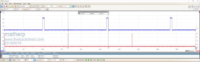

This function takes a trigger pulse on pin-15 (28-pin) or pin-42 (44-pin) MM2 and uses it to create an output pulse on a user-specified pin with a user-specified delay and of user-specified duration.
NB: The Cfunction can not be used at at the same time as IR input
In the example a pulse is created 10mSec after the trigger for 500uSsec
Once set up the pulse generation will operate in the background and create a pulse whenever is sees the trigger. The parameters for the generated pulse can be changed at any time by calling the function again.
The maximum pulse length is a function of the CPU speed and is defined by the equation:
maximum pulse length in seconds = (65536*8)/(CPU speed in Hz)
CPU speed must be either 40MHz or 48MHz
The demo code should be self-explanatory. C-code is also attached for interest

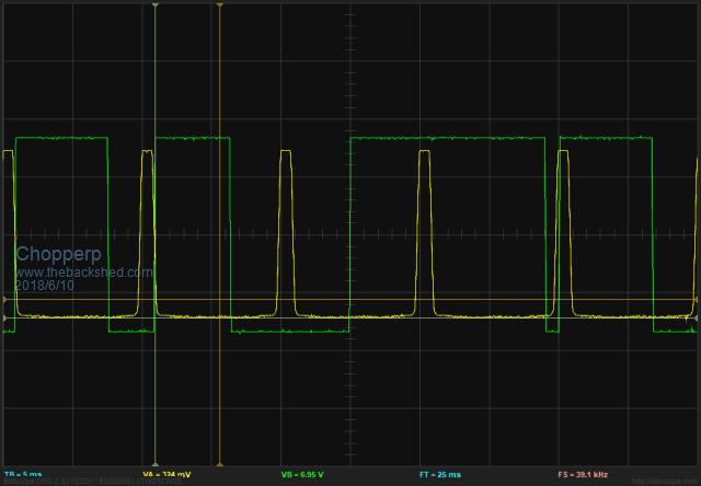

Took me a while to work it out, but I eventually got something going. About the first thing I found out was to use integers for the delay & width variables.
I have it going in a 1 sec loop monitoring a voltage for the width & triggering at 100Hz. (Rectified mains). However, every so often, it will miss a beat as shown by the snapshot below or the width varies slightly. (Delay 1000mS & width ~ 6700mS). It would need to run in a faster loop.
Did some more testing & my trigger signal probably needs improving. I reduced the level slightly from what photo shows & it is behaving much better. More testing needed on my part.
It does appear to have an occasional hiccup when running from the test signal. My test setup is a bit rough though.
This is certainly a huge step in the right direction. Very, very much appreciated.

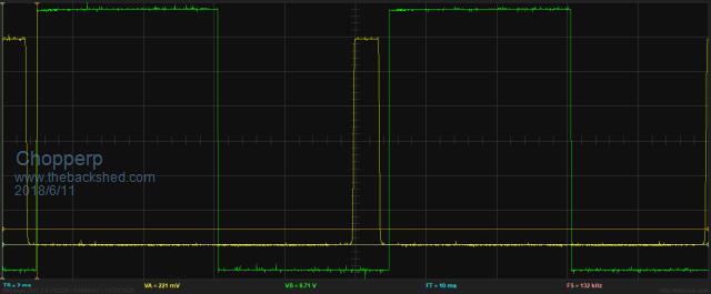

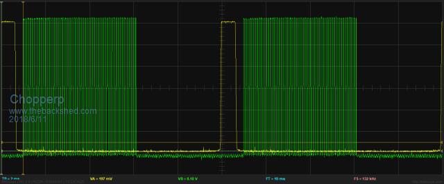

Fantastic!!!! Working perfectly as designed.
As you mentioned, there is no error correction. I found a too wide a pulse gave an inverted output. Limiting the width solved that problem.
I also experimented with some gating pulses. The idea worked on the breadboard. Yet to be tested in real life though which may take a week or two. QLD Courts reckons I need to do Jury Duty. I'd better go.
EDIT OOPS Just realised that my gated pulses aren't correct. Should be after the pulse end. Back to the drawing board.
option autorun on
pwm 1, 10000, 50 'HF trigger pulses for the SCR, gated by PIN 14
setpin 15, CIN 'Trigger input
setpin 7, ain 'Sample volts in. 0-3V3
setpin 23, inth, trigger 'PIN 23 connected to PIN 15
do
width% = max(500, min(8750, pin(7) * 3000)) 'width limited from ~ 0.5mS to 8.75mS
pause 8 'simulating doing other stuff
loop
sub trigger
oneshot 14, 1000, width%
end sub
Trigger + Normal O/P

It appears this has been seen before.
  Chopperp said  As you mentioned, there is no error correction. I found a too wide a pulse gave an inverted output. Limiting the width solved that problem
width% = max(100, min(8750, pin(7) * 3000)) 'width limited from ~ 0.5mS to 8.5mS
Stopping it.
  matherp said  You probably need to call "oneshot 0,0,0" to reset it. Let me know if it works  Edited by matherp 2018-06-13
