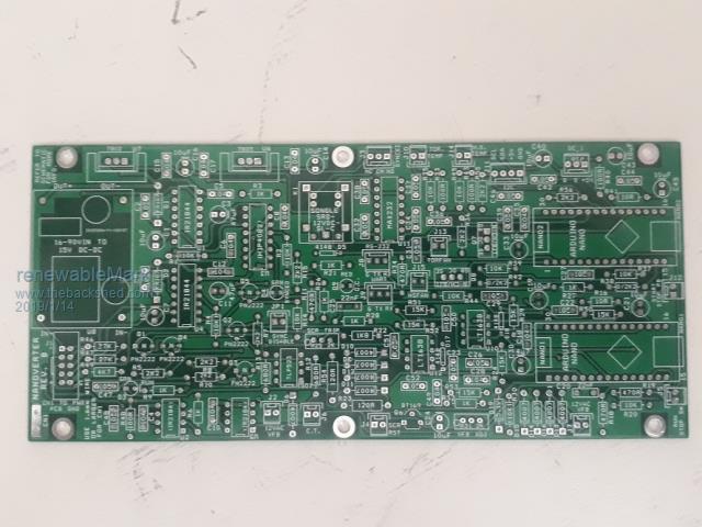

I ordered some nano boards, have 4 spare if anyone wants one.
$10 plus post.
Cheers Caveman Mark

Hi TinyT, I am implementing my version of a control board bit by bit and I hit a small stumbling block. I refer to your schematics to ensure I have the right pin numbers etc.
Nano1 has an input shown as "SCR_SD_N" which caused me to re read about 40 pages to discover what the hell it was. After looking at Nano2 which also has this mysterious input I think I now get it.
Does Nano1 have the flag the wrong way around - it is an output to nano2 so Nano2 knows why the toroid has suddenly gone so quiet, and why the lights went out....
I'm glad to see the finished results are starting to make some sine waves.
I only have 2 types of outputs from my control board to the power boards as I will only be driving optos. One uses the IR2184 direct to optos in the standard fashion (with inherent dead time), the second type uses a quad exclusive or gate to provide complimentary drives (no dead time) which are intended to drive the opto couplers using Warps inverse parallel trick and can provide for more (increased) dead time by adding a small cap if required.
Hope to send out for manufacture this week.Edited by wiseguy 2019-02-14

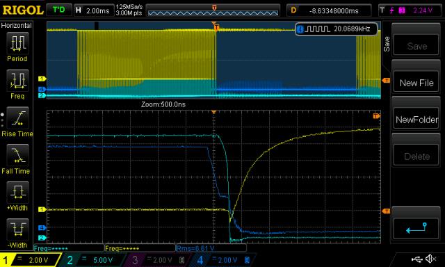

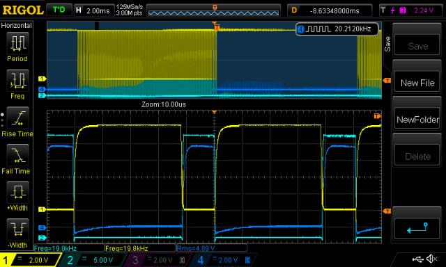

Part 26: A closer look at MOSFET gate voltages during switching
In another post on this forum, some interest in shoot through or cross conduction as a failure mode has been shown.
For this discussion, I want to look at one of the 2 half bridges of the MOSFET switched output stage of the inverter. There is no need to examine both of the half bridges, what we see in one of them is reproduced in the other.
Shoot through is defined to be when both the high side and low side MOSFETS conduct at the same time. This is obviously a bad thing, it means the DC supply is conducted through both sides of the half bridge, effectively shorting the DC supply, with current limited by the Rds(on) resistance and DC supply impedance. Some inverters have immense DC supply capacitance and this provides a huge potential current during short circuits.
Reading the specifications of MOSFETS used in these applications, we see something
called Vgs(th) which is the gate voltage, with respect to the Source pin, that is
needed for the MOSFET to show clear signs it is conducting. Not completely conducting, at it's specified Rds(on) resistance, but conducting never the less.
The testing and results that follow are using my test inverter, which uses
IRF3808. I have 4 MOSFETS for each of the 4 legs of the full bridge.
Each leg is fed gate drive that is connected to 4 MOSFETS in parallel.
This is not best practice and risks having one of the 4 switching on a little before the others, and this can be a cause of catastrophic failures. It very probably causes some high frequency oscillation.
The IRF 3800 Vgs(th) is between 2V and 4V
Rds(on) is 5.8 mOhm
Pulsed current max is 550 A, continuous curent is 140A at 25 degC at the junction.
These are reasonable devices for a test inverter.
I want to show the gate voltages (with respect to the low and high side's Source pin)
with the half bridge output voltage. This voltage is measured at the point where we
connect the primary winding of the output transformer.
Yellow is low side gate voltage
Dark Blue is high side gate voltage (with respect to high side Source pin)
Light Blue is the output voltage of the half bridge
It appears I am using only about 10V to switch the gates.
It's clear also the DC supply of the inverter is about 30V as seen in the light Blue
amplitude.
First an overview. To make sense of this, see the upper trace, this shows a bit more than one complete 50Hz output. I am running the current nanoverter code, so it shows clearly the activity of one of the half bridges.
There is a small vertical dark line on the left in the upper trace. This shows where in time the time expanded bottom view is taken from.

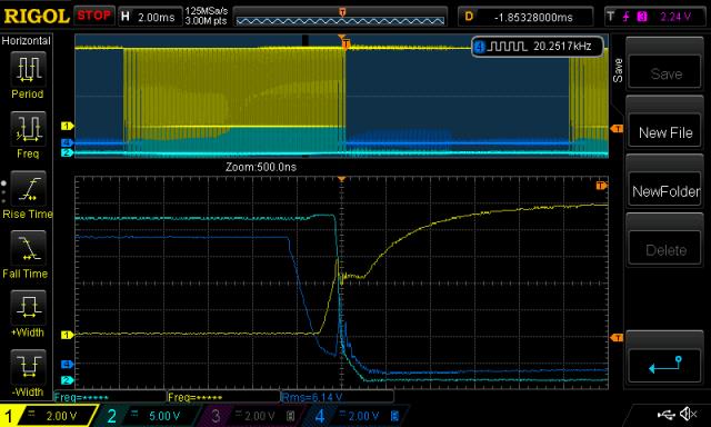

Now let's see the low side switch ON event.
We will see the following:
the high side gate go low, with a bit of dead time to allow the...
low side gate go high.
Output voltage drop to zero as the lowside MOSFETS conduct, pulling the output to ground
And what else can we see? The high side gate voltage increase, way past the Vgs(th)
during the rapid drop of the output voltage. You can see it, right in the middle of the lower trace. When I look at the original image I see it peak over 6V.
This is likely resulting in some low power shoot through.
A detail to see, but most importantly, is to observe the low side gate starts to rise
on a slope (defined by gate drive current, gate supply resistance and gate capacitance) until the MOSFET finally conducts fully. This slams the output voltage down to ground rapidly. This fast voltage change, which appears on the high side source pin, as well as the low side drain pin causes the high side gate voltage to rise. Well past threshold voltage. Into conduction. Beyond our control.

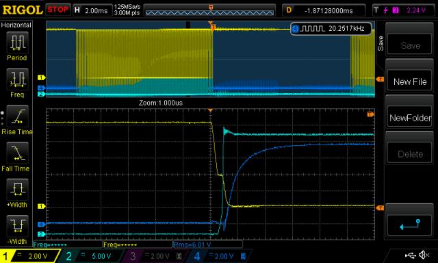

I show now the low side switch OFF event.
This is showing what we all think is supposed to happen. We still see some dv/dt induced gate voltage changes. As the output voltage rises rapidly, it causes the high side gate to drop a little, below zero in fact, for a short time.

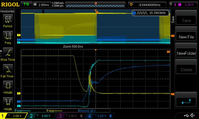

Looking at the switching at a different time in the 50Hz cycle, we can see some
ugly high frequency oscillations, and shoot through.
As the low side gate is driven low, the dead time permits us to see for a short time
no output voltage, low voltage on both the high side and low side MOSFET gates.
Then it's time to drive the high side MOSFETs ON, pulling the output voltage HIGH.
And all hell breaks loose. As soon as the output voltage rises quickly, the lowside gate is now rising well past threshold and conducts.
I want to make it very clear: The low side gate is no longer under control of the gate drive IC's output. It is being pulled low by the drive IC, via a 4.7R resistor but voltages arising within the low side MOSFET is causing their gates to rise up
well past threshold values. These gate voltages also appear on the drive IC output pins, to a certain extent as well. This is another issue to explore.
This clearly is not a smooth event, the low side gate is oscillating up and down, pulling the output voltage every which way and causing further dv/dt induced changes.
I have attached a current sensor to the DC supply in the past and clear spikes in DC supply current occur during these frenzied switching events from the shoot through.
Notice the output voltage only rises after the high side gate has been charged up enough, into it's fully enhanced conduction stage.

A great presentation and informative analysis of FET switching behaviour. In my experience individual chokes in series with each of the paralleled FET gates in the form of a ferrite bead or 5-10uH choke often helps quench HF oscillations - these can be in the MHz range.
In the second to last CRO picture, the yellow gate display appears to show that the gate was not fully off when it reversed direction into the oscillation area. If I am reading the CRO correctly the fall of the gate transition is ~ 500nS, relatively slow.
A parallel diode across the gate resistors (cathode facing away from the gate) should help speed up the fall time, a 1N4148 may be sufficient but I usually use a power ultrafast diode such as MUR160 or UF1004. A lower value resistor may also help. - but these both create a higher drive requirement of the Gate drive IC or buffer used. I have found that the slower the change of gate voltage is as it passes through the miller region can make it more prone to oscillation issues.
When there is a fast transient on the Drain, it is coupled back to the Gate. The Gate resistor forms a differentiator with the Drain - Gate capacitor and a combination of fast transient and insufficiently low Gate impedance (series r - even with the driver output low as you found)) can definitely drive the gate sufficiently to cause the FET to begin unintended conduction.

poida
Joined: 02/02/2017
Posts: 1516
Posted: 03:56am 02 Mar 2019
  wiseguy said   A great presentation and informative analysis of FET switching behaviour. In my experience individual chokes in series with each of the paralleled FET gates in the form of a ferrite bead or 5-10uH choke often helps quench HF oscillations - these can be in the MHz range.
For sure these little beads can do wonders.
I trialed one bead only once and saw the rise time of the gate voltage become way too slow. no numbers, sorry, it's from the dim dark corners of the memory.
But certainly, if I took the time to specify and source reasonable value ferrite beads
I think we could remove some of the circus of oscillations
poida
Joined: 02/02/2017
Posts: 1516
Posted: 04:01am 02 Mar 2019
all four legs of the full bridge have diodes as you suggest.
I'm pleased somebody say this anomaly. I have no idea why it is so.
Maybe I've blown the diode in question. They usually die short tho.
I would love to start driving these gates with some serious low impedance drive.
It would be a detail design thing:
thick conductors everywhere
short conductors too
low gate resistors
the diodes you mention
all driven by a beefy drive IC or totem pole or special opto coupler, whatever tickles
yer fancy.
I want to be able to sink that dv/dt, or maybe dI/dt parasitic down to local Source level via almost zero resistance. That would be nice.
