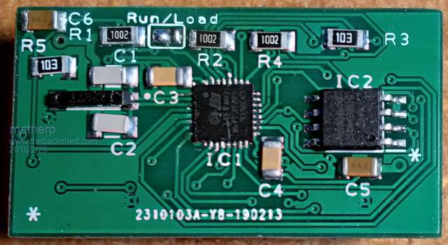

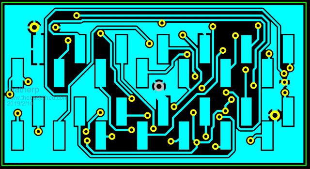

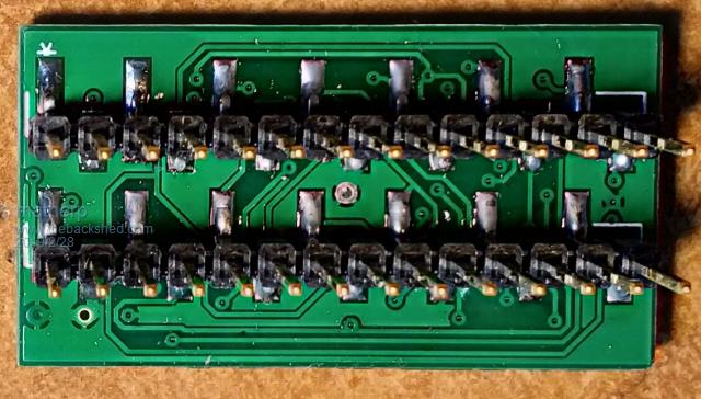

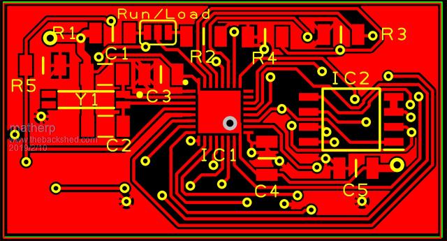

This little PCB will plug into a standard 28-pin DIP socket exactly like a MM2. The difference is that it has on board an Armmite L4 with in-built RTC and also a 16Mbyte Flash drive for storing programs and data using the Armmite's Flash file manager and, of course, it can run at ultra-low power consumption.
The pinout is arranged so that most special function pins are in the same place as the MM2: I2C, SPI, COM1, console, PWM1A, 1B, 2A. The Armmite has on on-board DAC and second SPI channel but does not currently support COM2, PWM1C or PWM2B on the MM2 pins. If this PCB is useful I can modify the Armmite firmware so that you can, optionally, use the same pin numbers as the MM2 and therefore most programs would run without any change.

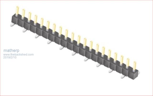

The PCB is just 37 x 20 mm. Soldering itB will require a heat gun as the Armmite chip is a 32-pin QFN and the clock crystal is also a bit tricky. Otherwise all components are 1206 so very easy to solder. The 28-pins on the underside of the PCB are surface mount and at standard 0.3" spacing between rows.
The Armmite has the advantage that it has a built-in bootloader so the MMBasic firmware can be loaded using the console connection by making the "load" jumper. Then it can be set to "run" for normal use.

  Quote  I can't see any 28 pin socket or pins on the board
The rectangular pads on the bottom (blue) are to solder the type of header shown in the first post that makes the pins

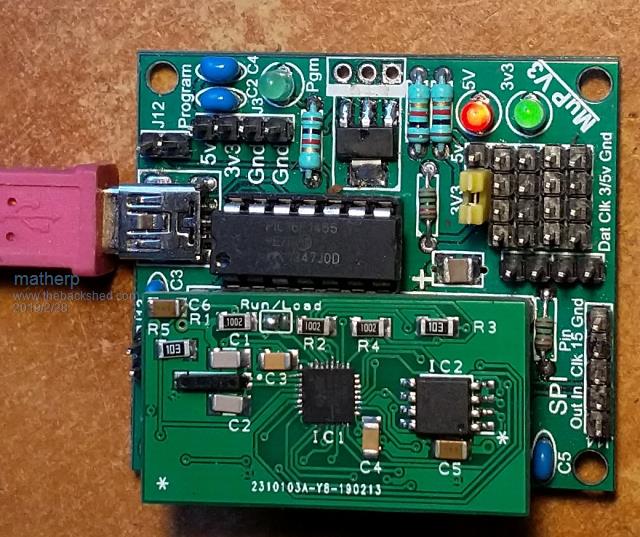

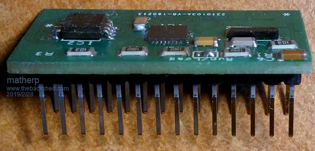

Posted: 02:31pm 27 Feb 2019
PCBs arrived today - one soldered and tested - all seems OK
The last picture show the module plugged into one of BigMik's Mup V3 replacing the MM2.
The ARMdip PCB has onboard RTC, and Flash filesystem.
The gerbers I used are attached
2019-02-28_002931_ARMdip.zip
2019-02-28_003053_ARMdip_-_Schematic.pdf

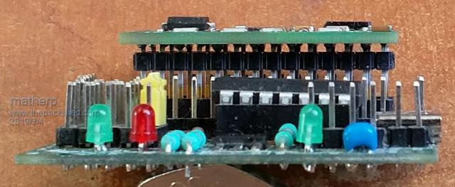

That is very very nice for me as I brought out 26 to a 3 pin header om my
quad relay controllers for possible ADC use.
Could you please give us a side shot of the board plugged into MUP V3.
That side profile would show its height as compared to a 170 I have in
a MUP V3. That will answer my question of it fitting between TFT and
pcb of 170 back packs board.

Posts: 11976
Posted: 08:06am 04 Mar 2019
  Quote  Could you please give us a side shot of the board plugged into MUP V3.
Note the header pins are available in various lengths (see the datasheet ). I'm using the 8.13mm version.
Quazee137
Joined: 07/08/2016
Posts: 603
Posted: 03:02pm 04 Mar 2019
Thanks matherp it looks like I can solder the pins then remove the plastic
part and flow a bit of epoxy to stabilize the pins and trim to fit.
My other thought is to solder a 2mm thick SMD female to the board and pop
some pins into the socket that will work with a batch of 20 of 2.8" that
had the SD holder smashed and with your board I won't need the SD.
It took five tries to get the STM32CubeProgrammer to download.
