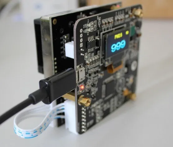

While looking for the SDS011 sensor at AliExpress I found this
SDEV011
Quazee137
Posts: 6624
Posted: 02:09am 08 Jan 2020
  Quazee137 said  While looking for the SDS011 sensor at AliExpress I found this
SDEV011
Quazee137
In the fine print
"Contains no sensor "
so it is a development board only and you still need the sensor.
Still a good price.
