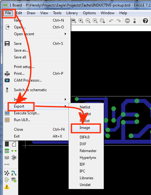

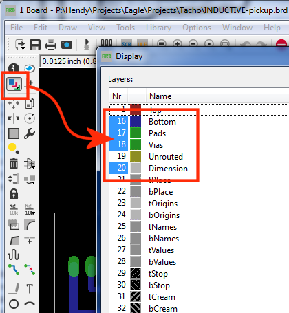

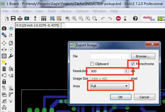

So in Eagle, adjust the view so it only shows the layers for bottom tracks, pad, vias and the outline:
Then export the result as a PNG:
and save it out as a monochrome foil pattern. Use a minimum Dots per inch of 600
So that is the foil saved as a black and white PNG.

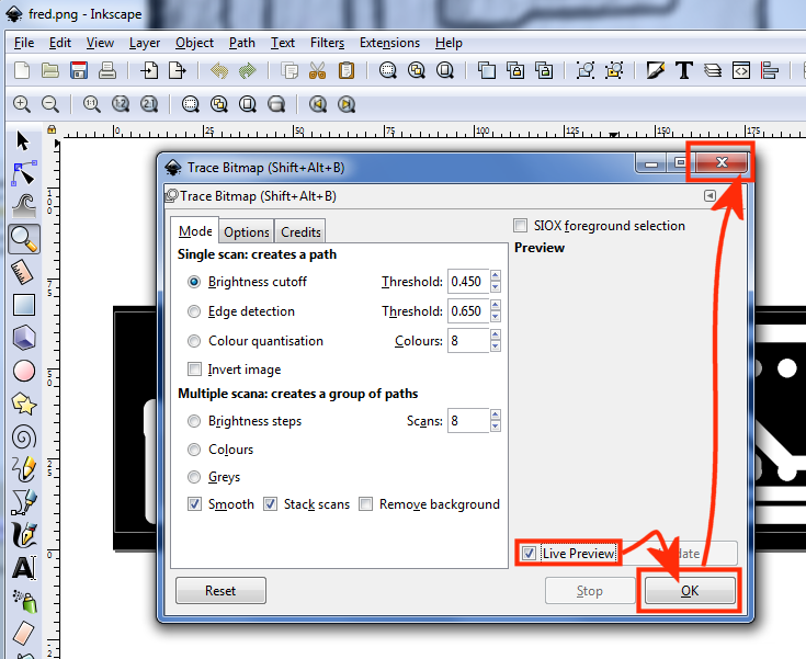

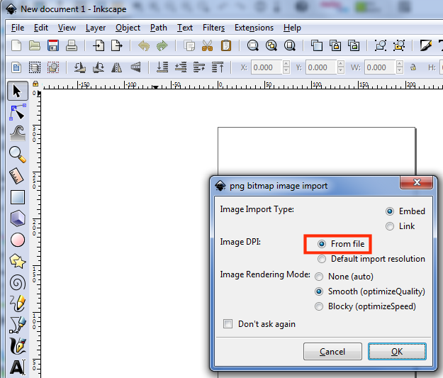

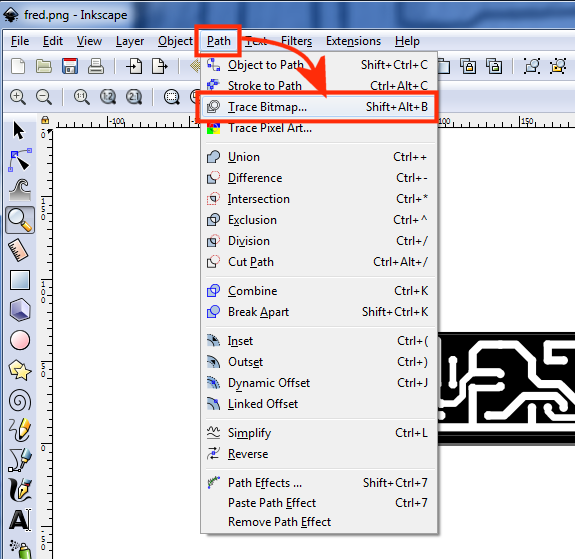

I use InkScape to convert the PNG to an SVG vector file (which is 90% of the way to GeRBL). Open the foil PNG in Inkscape using the DPI from the file - this maintains your dimensions from Eagle:
then use the path/Trace bitmap tool to trace the outline of the foil.
Click OK and close the tool window:
Then Save As SVG... I don't know what the difference between "InkScape SVG" and "Plain SVG" is, I always use the InkScape flavour as it comes up first and it's one less thing to change.

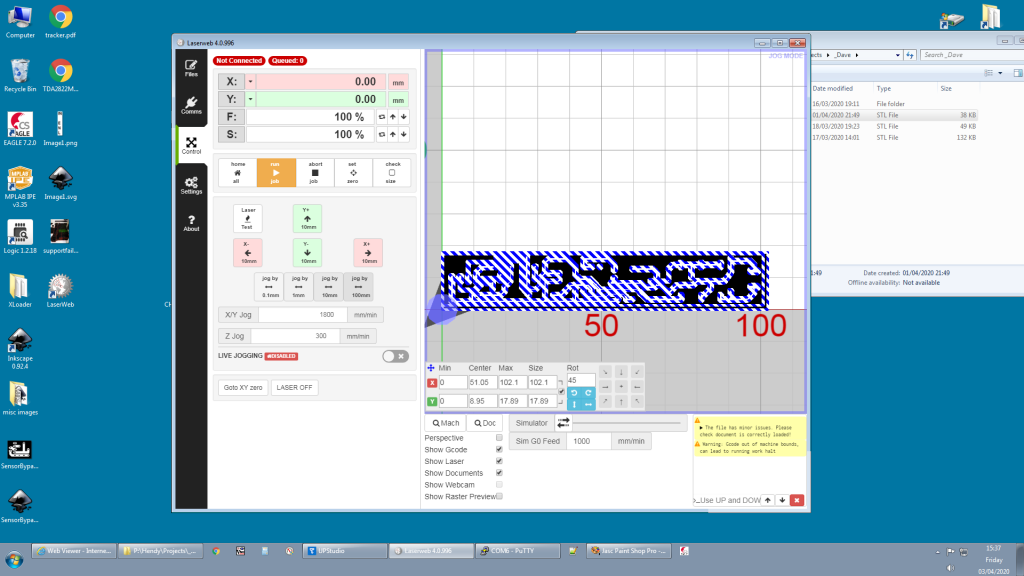

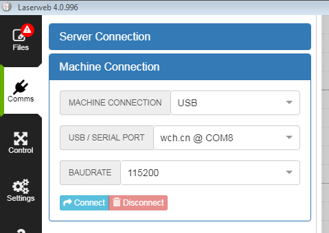

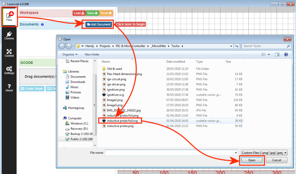

You are know ready to etch the board using your laser. To do this I use LaserWeb.
Open LaserWeb and connect to your laser
and import the SVG into the Documents control

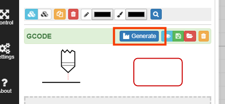

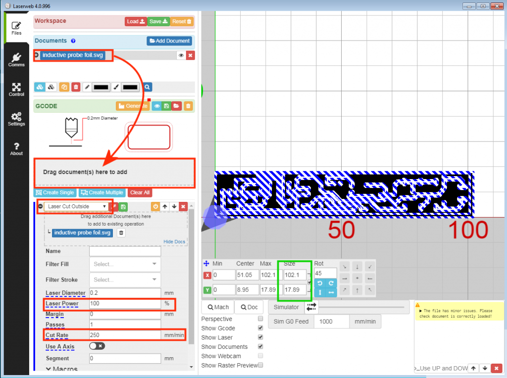

Then drag it to the GRBL generator, note the laser settings (Cut outside/100%/250mm/min) Noye also in the green box... the dimensions have been preserved from Eagle.

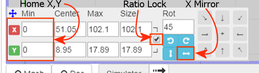

Now, my X co-ordinate is reversed which by accident provides the reversing of the foil required to get a true PCB out of the process. If your X & Y increase from south-west to north-east, you need to flip the image horizontally. Ensure the dimensions are locked then use the X-Mirror tool. set your home co-ordinate back to 0,0 afterwards as the flipping might have moved them.
To generate the GRBL code, click the Genrate button - you may get some minor warning about the file (perhaps this is the difference between the two types of SVG?)
Go to the Control tab, manually position your laser head, check the dimension by turning the laser tell-tale on (top button on my laser module) to position the board as you want it.
Safety goggles on, click RUN

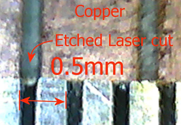

The beam is about half a millimeter or so wide, so the actual thickness would appear to be OK for what I am doing - its the cheapie kit that is the problem. The carriage mechanism is just not very good for super detailed work when processing GCode (exposed belts, no linear rails). It seems better on the registration when raster etching but that gives jaggy edges on diagonals and curves. Raster etch also takes FOREVER but has the advantage that you can get a traditional looking board that only has copper flood where you put it rather than as a by-product of the way the board was produced.

here is a pic from my microscope of an etched copper board with a steel rule across it for measurement... it actually is probably 0.1 - 0.2mm ish in reality.

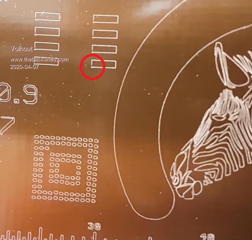

I just watched a video from Marco Reps on YT on all the improvements he made to the Eleksmaker.
But even after all the improvements, when I saw the result shown in his video, it had the same artefacts that I observed.
I am not sure this is in the EleksLaser hardware, in the Arduino nano grbl code, a setting, or in the code that controls the machine. Could be any of those.

Question: what settings did you find best for Trace bitmap.....Never mind, I see the settings are somewhat different in this version of inkscape.
After some time spent mucking around with settings and many mistakes (still learning the program) I have found good results with single scan, speckles, smooth corners and optimise left unchecked.
And I didn't use Simplify, It might be ok for some, it gives a lot of rounded edges and curves but if necessary we can move the nodes to fix it up or widen the tracks.
Its also good to remove the underlying image that's hiding under the traced image...didn't see it there the first few times.
