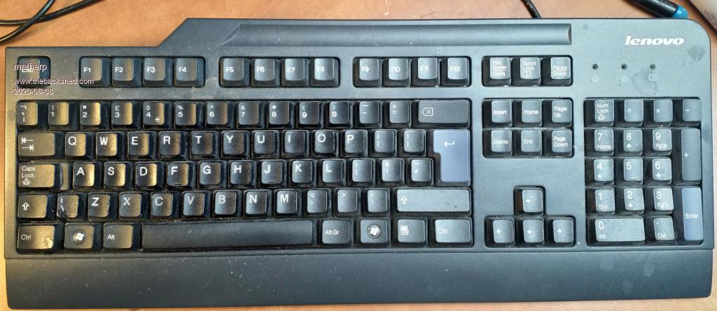

Below is the keyboard map for a standard UK keyboard. The numbers on the left are the ASCII code generated when the key with the description given is pressed first without the shift key and then with.
e.g the key labelled USB_HID_KEYBOARD_KEYPAD_KEYBOARD_1_AND_EXCLAMATION_POINT  generates 49 without the shift key (ascii for 1) and 33 with the shift key (ascii for the exclamation symbol).
I've also attached a picture of the UK keyboard as reference. I need you to produce an equivalent list for the German keyboard. You can assume that keys in the same physical location will produce the same internal USB code - in my example hex 1E. This is the first thing we need to prove.
For keys that have no ascii representation (i.e. an ascii code below 128), for example ü, please set the code to 0
In addition I need a separate list of standard ASCII keys like [ { ] and } which on a German keyboard need some special additional keypress - e.g. Alt Gr or Alt GR + SHIFT
Please produce this in roughly the same format e.g. (example deliberately incorrect)
44,55 //German open square bracket, German open curly bracket = 0x33 + Alt GR
Note where my table has codes above 128 (hex 80) these are special codes used internally by the CMM2 firmware and shouldn't be changed
I can then set this up as an additional table for the German keyboard. When you have something please PM me with your direct email address and then I can send you the firmware direct without having to post multiple tries.

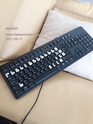

Friet
Joined: 16/12/2020
Location: Belgium
Posts: 13
Posted: 08:20pm 10 May 2021
Hi Peter,
I am working on a Belgian version for the keyboard driver, this is also an AZERTY variant, but with a twist vs the french layout.
Enough differences to make a french driver unusable on a Belgian keyboard i'm afraid.
First part : the text file with an as close as possible approximation is done.
(knowing ASCII characters >128 cannot be used)
The following characters requiring ALT GR :
HID Code   ASCII
$64 ,       92
$20 ,       35
$2F,        91
$30,        93
$31 ,       96
$34,        39
$38 ,       126

Posts: 255
Posted: 07:13am 11 May 2021
This is the route I took with my Belgian keyboard :-)
It needs a new paint job. It gets used a lot :-)
Epsilon CMM2 projects
