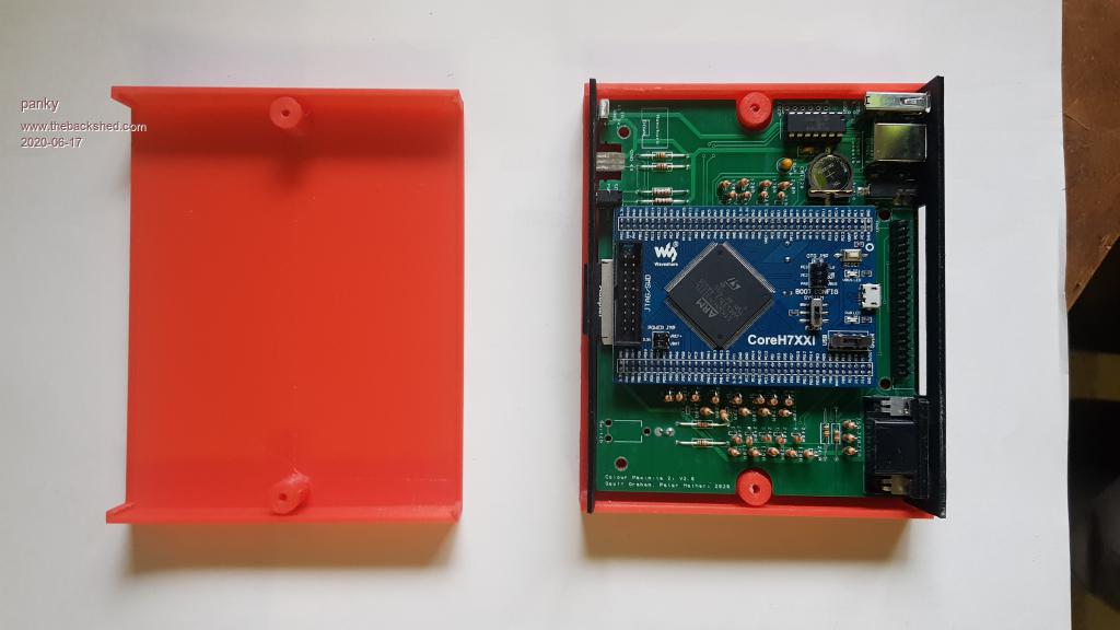

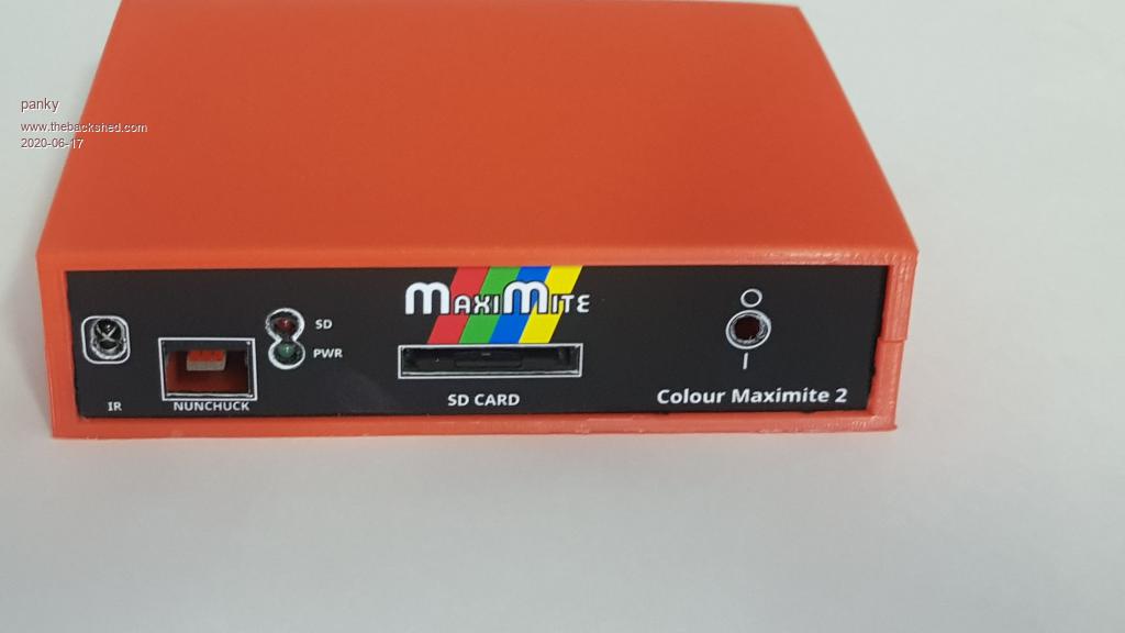

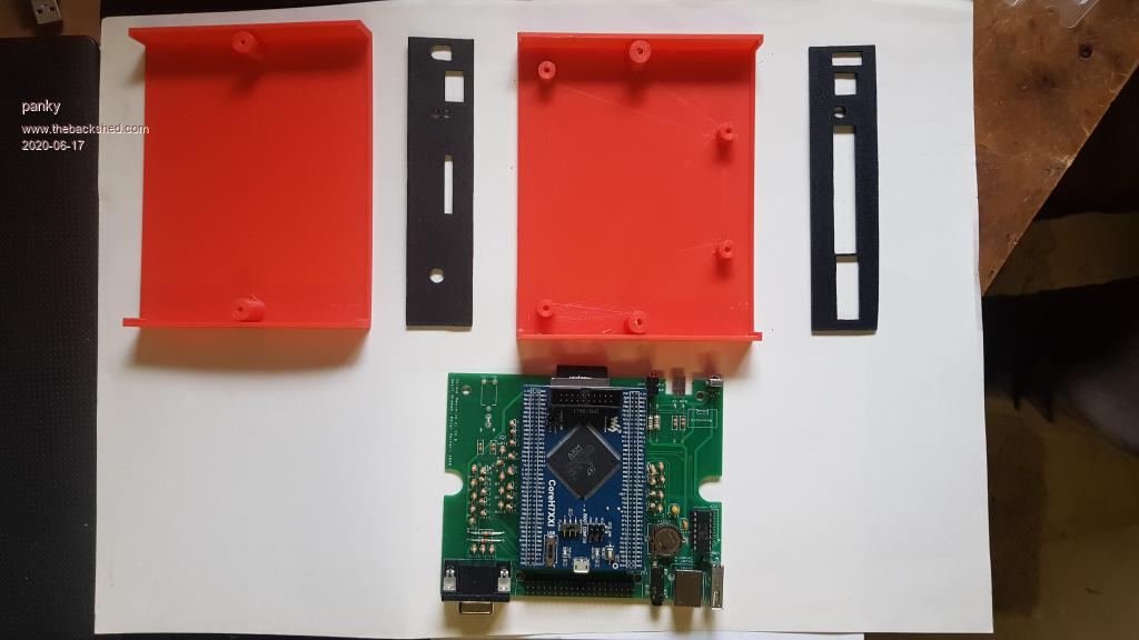

I recently obtained a Flashforge Finder 3D printer and needed to "produce something usefull" to prove to the other half it could actually do something
Accordingly, I created some .stl 3D files using FreeCAD for the front and rear panels and top and bottom cases. It took a couple of goes to "get it right" but I am happy with end result although you need to be EXTREMELY patient as a full was nearly 24 hours of printing!!!
The front decal was created in Adobe Illustrator, printed on glossy photo paper and glued to the front face.
I am happy to provide the CAD files for anyone who wants them.
Doug.

Awesome work @panky!  Printing a case with the right height stand-offs would also mean no need to fiddle around with 5mm spacers!
Nice work on the front panel too. All looks like a nicely finished CMM2.
For the project cases I make with my 3D printer, I got myself those little M3 knurled brass nut inserts which can be pushed into the 3D printed holes to provide a really nice quality screw together finish.

They do look good panky. They appear to have a quite a good finish.
Any chance of posting your printer settings please?
Layer Height, shell thickness, print speed etc etc.
Thanks. Brian

.STL files below. Anyone wanting the FreeCAD drawing files, PM me.
