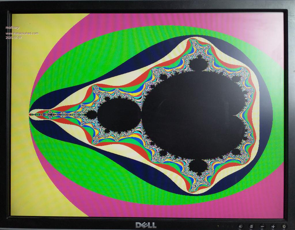

Takes 1.6 seconds to run 800x600
Video
mandelbrot 64 'parameter is the maximum number of iterations
do:loop

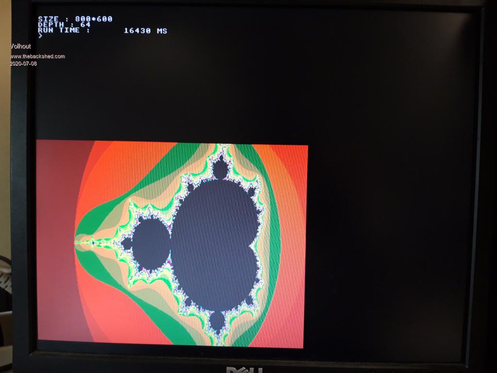

One of the first things I did was write a Mandelbrot plotter and mine works, but it is 10X slower at least as it is in 100% BASIC.  I also wrote a Conways Game of Life implementation and it works but once again, being 100% BASIC, it is slow.
So, exactlly how does this work, is there are tutorial or info as there is nothing in the user manual.
Thanks!

  abraxas said  What would be really nice is for someone to write Pete's code in pure MMBasic so we would have an apples-to-apple comparison of number cruching performance of CSUBs vs plain BASIC subs.
My implementation in pure MMBASIC is very similar, I will post it later.
It is MUCH, MUCH slower.

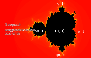

I took the liberty of tweaking Peters Mandelbrot CSub.  It now accepts scale and position coordinates.  I also inverted the Y display coordinates to be more standard. It's still pretty darn fast!
Edit:  You will need one of the latest beta versions of MMBasic to run this!
If someone wants to write a MMBasic UI to make it interactive that would be awesome.  I will get to it "someday" if nobody else volunteers!
The coordinate system looks like this:
Here is the MMBasic Code:

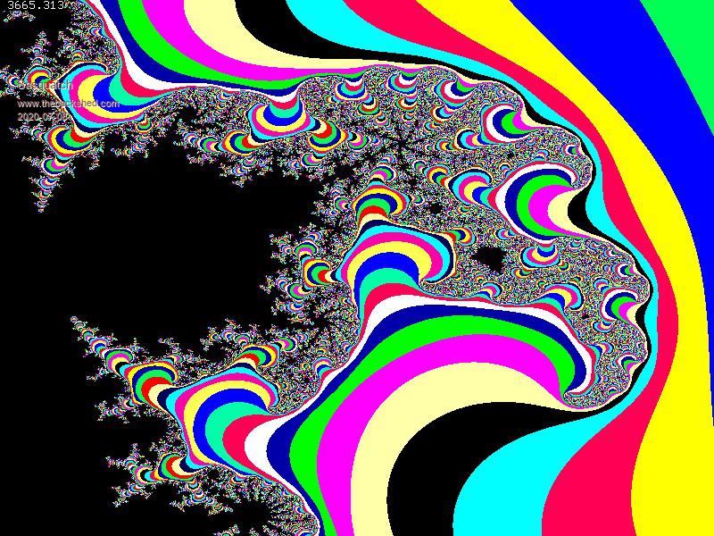

Here is an example screen dump.  As you can see in the uper left hand corner, it took 3.6seconds to render at 800X600.
Depth = 64
Scale = 50.0
XCenter = 0.3935871840
YCenter = -0.1475255520

  matherp said  Can you post the C source. I just fixed a problem in literal floats and it has broken your program. Need to understand why
I originally tried using *double, but I was testing with literal constants and I couldn't get it to work.  I then changed to *float and the literal constants worked but passing a variable wouldn't work.  If you found a fix for the literal floats, chances are the latest version using the *MMFLOAT type should work for both?

  daveculp said  Here is a pure MMBASIC implementation.
Its slooooowwwwwww
CLS black
CONST w = MM.HRES
CONST h = MM.VRES
CONST maxi = 100
CONST colors = 65536
DIM sx AS FLOAT
DIM x AS FLOAT
DIM y AS FLOAT
TIMER = 0
FOR py = 0 TO h - 1
 REM Scale Y axis
 sy = (py / h) * 2 - 1
 FOR px = 0 TO w - 1
   REM Scale  axis
   sx = (px / w) * 3.5 - 2.5
   vy = 0
   vx = 0
   i = 0
   x = 0
   y = 0
   do WHILE (x^2 + y^2 < 4) AND (i < maxi)
     xt = x^2 - y^2 + sx
     y = 2 * x * y + sy
     x = xt
     i = i + 1
   loop
   c = i/maxi * colors
   pixel px, py, c
 NEXT px
NEXT py
PRINT TIMER "ms"
SAVE IMAGE "mandel.bmp"
Ported to BBC V basic running on the raspberry Pi zero.
MODE 28
w = 800
h = 600
maxi = 64
TIME = 0
FOR py = 0 TO (h/2 - 1)
 FOR px = 0 TO w - 1
   i = 0
   x = 0
   y = 0
   WHILE ((x^2 + y^2 < 4) AND (i < maxi))
     xt = x^2 - y^2 + sx
     y = 2 * x * y + sy
     x = xt
     i = i + 1
   ENDWHILE
   GCOL i/maxi * 64
   POINT px, py
   POINT px, h-py
 NEXT px
NEXT py
PRINT TIME*10
run time : 16 seconds (10x slower than the CMM2 CSUB)

Sasquatch
Joined: 08/05/2020
Posts: 385
Posted: 02:17pm 08 Jul 2020
Ok, I can't find a way to edit my older posts in this thread so I will put a warning here!
Warning!
Be warned that the MY original posts of MMBasic and C sourcecode for the Mandelbrot CSub are now Obsolete!
Please use the latest versions in this thread!
