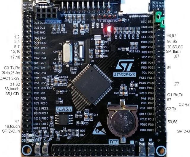

Hi All,
I’m a bit new to the Micromite programming, so please excuse me if the question is stupid or redundant.   I’m looking for the connections (would be nice if it was a list) for connecting a 7” SSD1963Q LCD to the Armmite F4 black board.   I loaded the board, and have it running MMBasic (ARMmite MMBasic Version 5.05.09).  Thanks to matherp, your post was excellent on getting it loaded with MMBasic .
I’ve run pgms to check the I/O ports and have had the Comm ports working.   However I don’t understand how to connect the LCD.  If someone could give me the connection list or point me to where I can find it that would be a big help.    Also what command you used to config the LCD.  The current info in the board is “OPTION LCDPANEL ILI9341_16, RLANDSCAPE” which I will need to be changed.
Thanks, Don

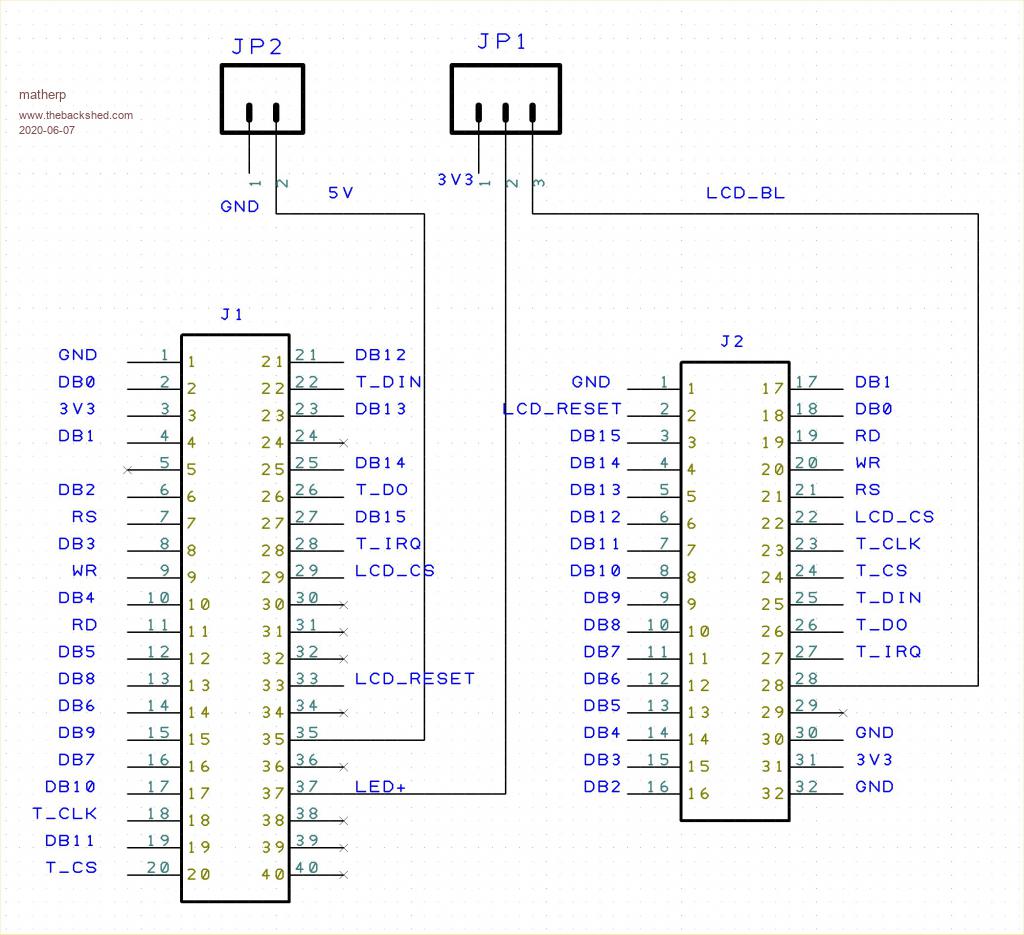

Attached is the wiring for the SSD1963 adapter I did
Disable the ILI9341 with
OPTION LCDPANEL DISABLE
then enable the SSD1963 with
OPTION LCDPANEL SSD1963_n_16,orientation
n should be 4, 5, 5A, 7, 7A, or 8 (same as the MM+)
orientation should be L, RL, P, or RP
Then setup touch if required
OPTION TOUCH PB12, PC5
GUI CALIBRATE

Hi Guys,
I too have a couple of these boards, programmed with ARMmite MMBasic Version 5.05.09.   I sure could use a list that showed the mapping of the pins on the board (by name PE0, PA2,,, etc) to the functions (COMx, I2Cx,,, etc) in MMBasic.
Any help would be great.
Don
Posts: 3888
Posted: 12:26pm 16 Jul 2020
This is what I made up for my use:
Also this from I'm not sure who:
F4 Pin Functions.zip
Edited 2020-07-16 22:34 by lizby
Canada_Cold
Joined: 11/01/2020
Posts: 57
Posted: 12:47pm 16 Jul 2020
Hi lizby,
That is Excellent, thank you so much.
Don

  Canada_Cold said    I sure could use a list that showed the mapping of the pins on the board (by name PE0, PA2,,, etc) to the functions (COMx, I2Cx,,, etc) in MMBasic.
I am fairly certain the Arm versions of MMBasic can use the name of the pin as well as the number
can you try
Setpin PC13,DIN
Posts: 12163
Posted: 01:20pm 16 Jul 2020
Here is the "official" mapping, and yes you can use the pin name whenever you need to specify a pin as the Captain says
