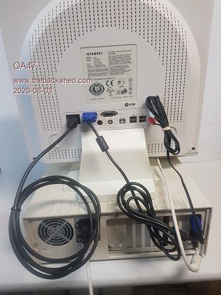

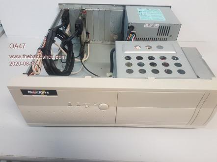

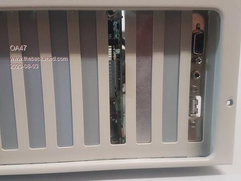

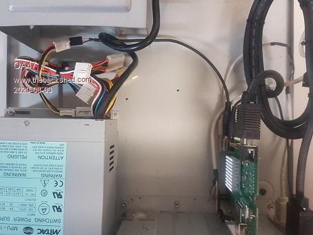

I have a collection of NOS(New Old Stock) AT cases in the shed and decided to house my CMM2 in a baby AT desktop chassis to give it the classic retro feel. I chose the AT format case as it can provide the height needed to house the CMM2 board vertically. I wanted to keep all of the functionality and not modify the current format as much as possible. I was able to get access to the SD card and Nunchuk ports at the rear. I Have the SD led, PWR led and RESET button on the front panel and made a back plate to present the USBhost, Audio and VGA connectors.I have used the original AT power supply as I wanted to utilise the front power switch to also control power to the monitor. The Power/Console USB is connected to the 5V supply.
I found an appropriate beige monitor which had inbuilt amp and speakers as well as a beige USB keyboard to match the theme.

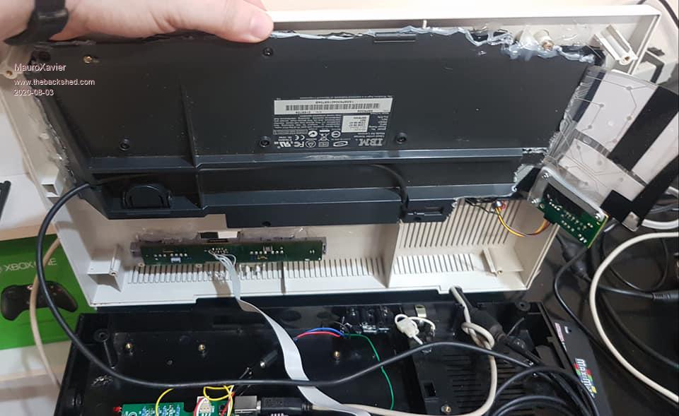

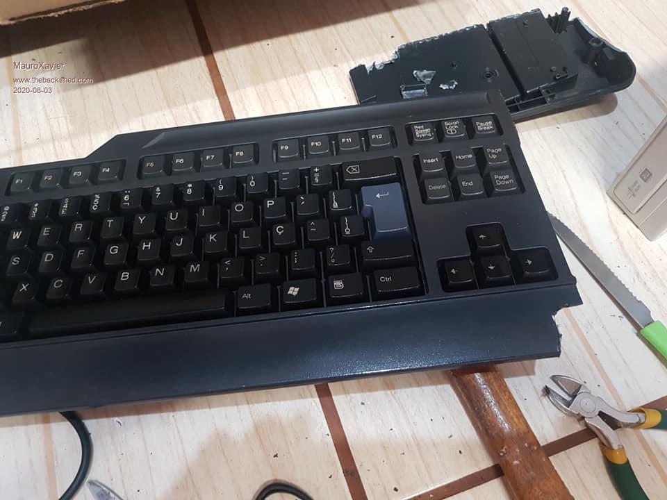

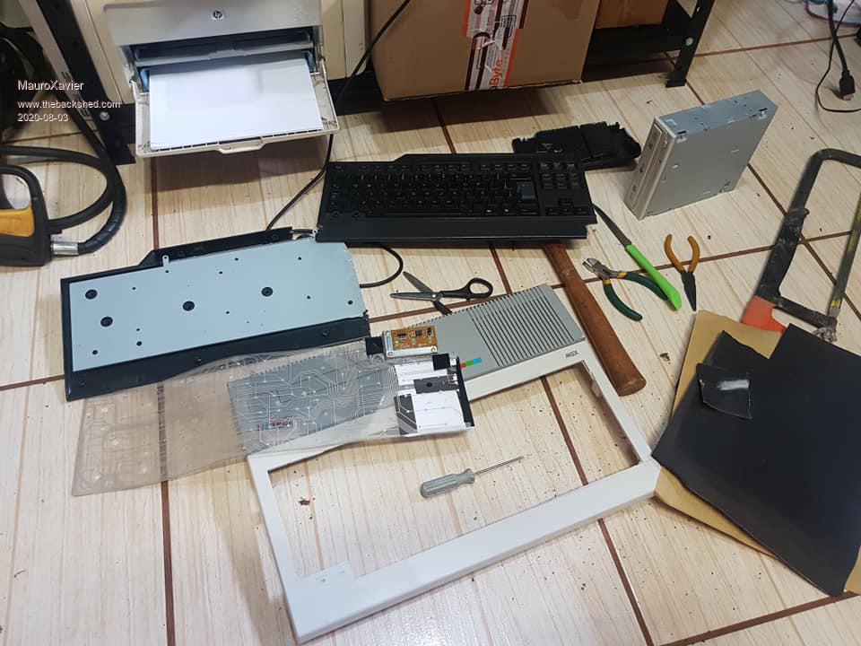

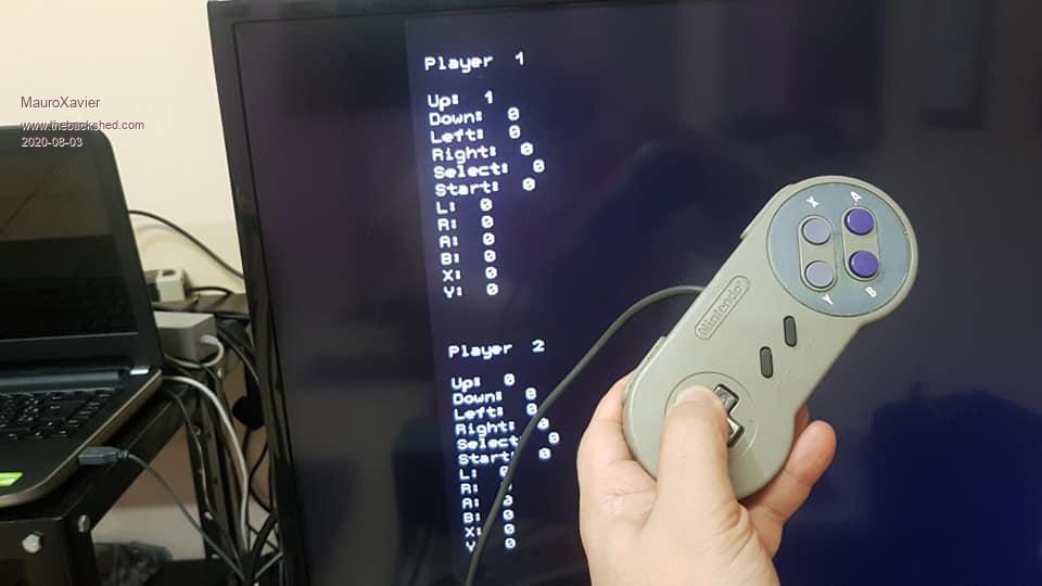

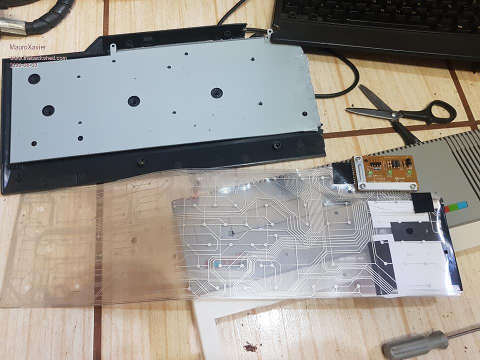

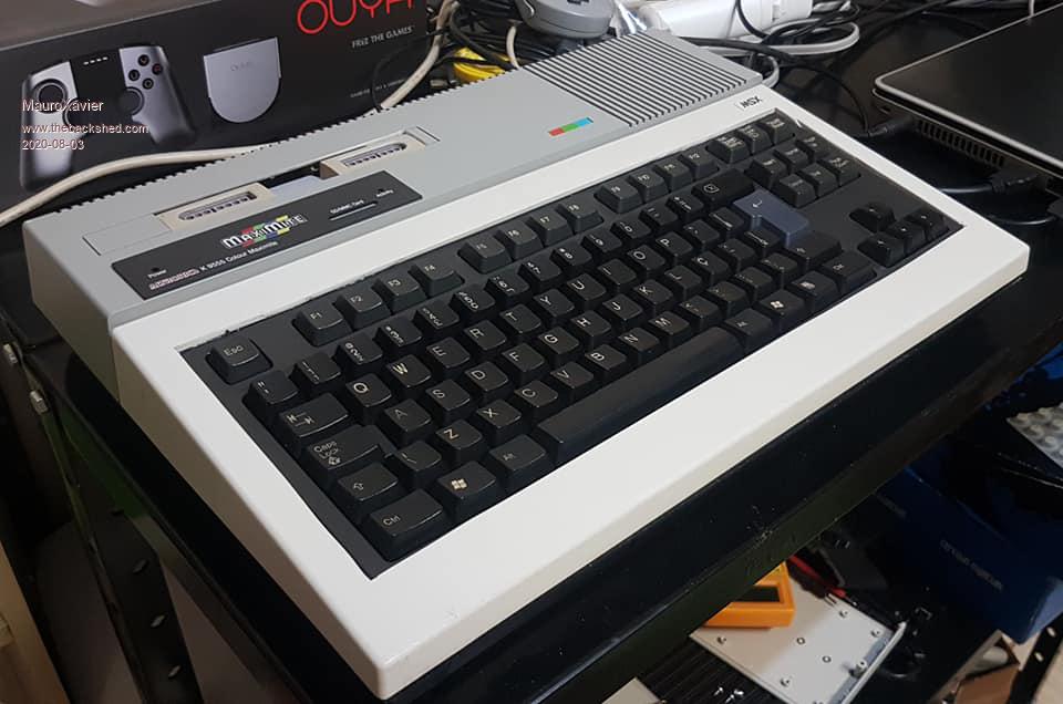

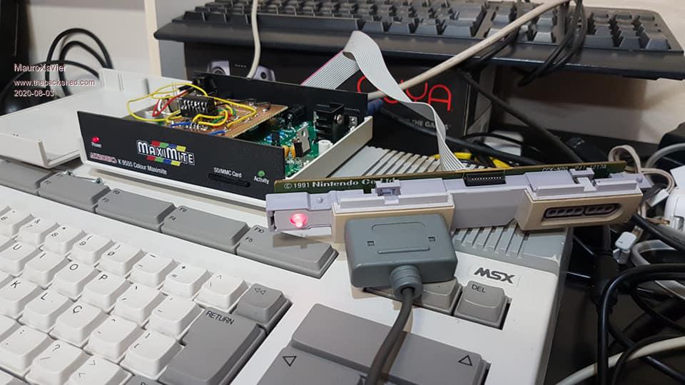

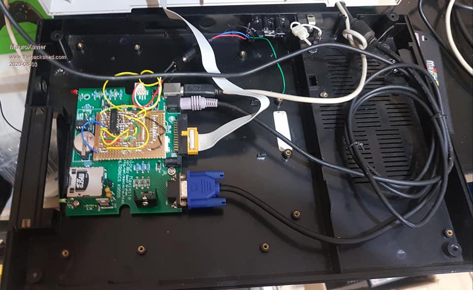

Here are some pictures of what I did with my first CMM about two years ago:
My original CMM have two SNES Control ports and one SN76489 sound chip, but today with our almighty CMM2 none of this is necessary anymore

Hi Mauro,
From the outside it looks dandy .... inside is "functional".
Nice you used the old front panel ...
I am surprized to see that the hotglue holds the keyboard in place... After so many hours of programming.

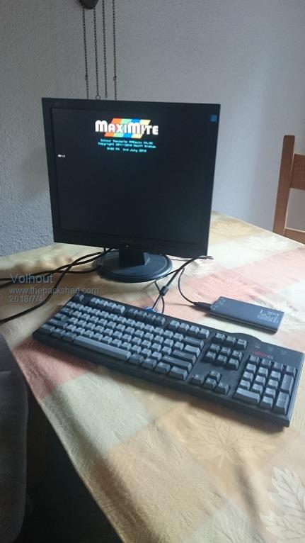

My CMM1:
And.....In use by my grnddaughter, playing Mauro's Gauntlet

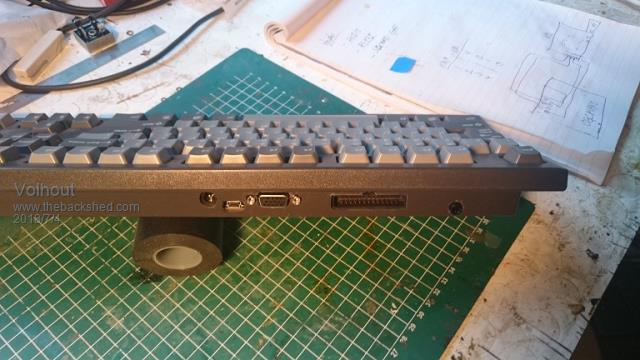

Volhout, this is very nice. What is the keyboard you used for this project? Do you have instructions posted somewhere on building this?

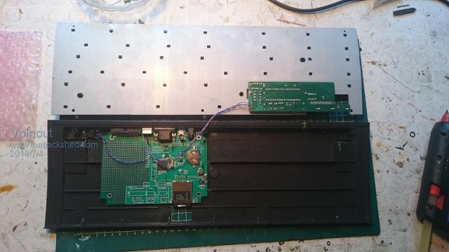

Posts: 6304
Posted: 02:09pm 03 Aug 2020
hi abraxax,
The keyboard is an old Fujitsu Siemens PS2 keyboard I bought for E0.50 on a flea market, and cleaned. The building instructions are simple:
- buy a keyboard that is sufficiently high (a very flat keyboard cannot incorporate the VGA connector, the highest part of this version of my CMM1 board (a CGcolormax2).
- Open it up, and plug it into the CMM1 to write down what color wire connects to what pin of the PS2 connector on the CMM1. Remove the cable from the keyboard.
- Place the CMM1 at the best location in the keyboard (that depends where the PS2 microcontroller board resides, most cases it is below the capslock LED's).
- start marking where the cutouts in the rear of the keyboard should come, and dremel the cutouts.
- make a hole in the bottom, where you can insert the SDcard when the keyboard is closed.
- connect the PS2 PCB to the CMM1 PCB with 4 wires, as written down above.
- hotglue the CMM1 board in the case.
- screw it together (or click). Done....
Edited 2020-08-04 00:10 by Volhout

Posted: 08:22pm 03 Aug 2020
  Volhout said  I am surprized to see that the hotglue holds the keyboard in place... After so many hours of programming.
I used hot glue and screws too.
