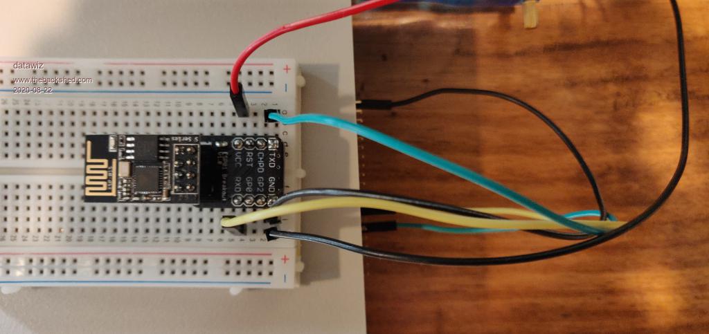

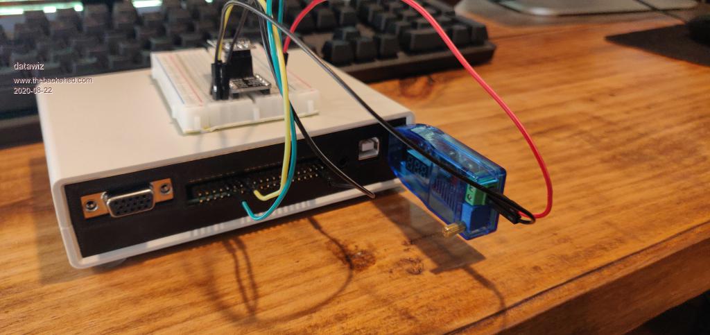

I've connected my CMM2 via COM2 to an ESP-01S unit, which is based on the Espressif esp8266, and written a library and a set of utilities which I hope will be useful for the community.

In regards to the hardware I'm using and how it is wired up--
I had some ESP-01 units (non-S) but had problems getting them working on the CMM2, even though they worked on my PC via a USB adapter. I may go back and revisit those units, but since the ESP-01S units worked without any issues, I moved forward with those.
ESP-01S on Amazon
I used these breakout boards to make them breadboard friendly:
ESP-01S breakout board on Amazon
The ESP-01S won't power from the GPIO pins, so I used these usb voltage regulators to give it the 3.3v it needs. I used the on-board USB port and an external power supply and both worked fine.
USB adjustable voltage regulator on Amazon
Here are some images of how it is wired up:

When I tried to power it up from the GPIO pins, my cmm2 would power on, but wouldn't boot up, and the monitor remained blank. I figured the gpio couldn't provide the power needed for the esp-01s and powered it externally. I admit, i didn't spend any time trying to troubleshoot it. I'll have a look at it again this weekend, as I'd prefer to have it powered that way for simplicity.

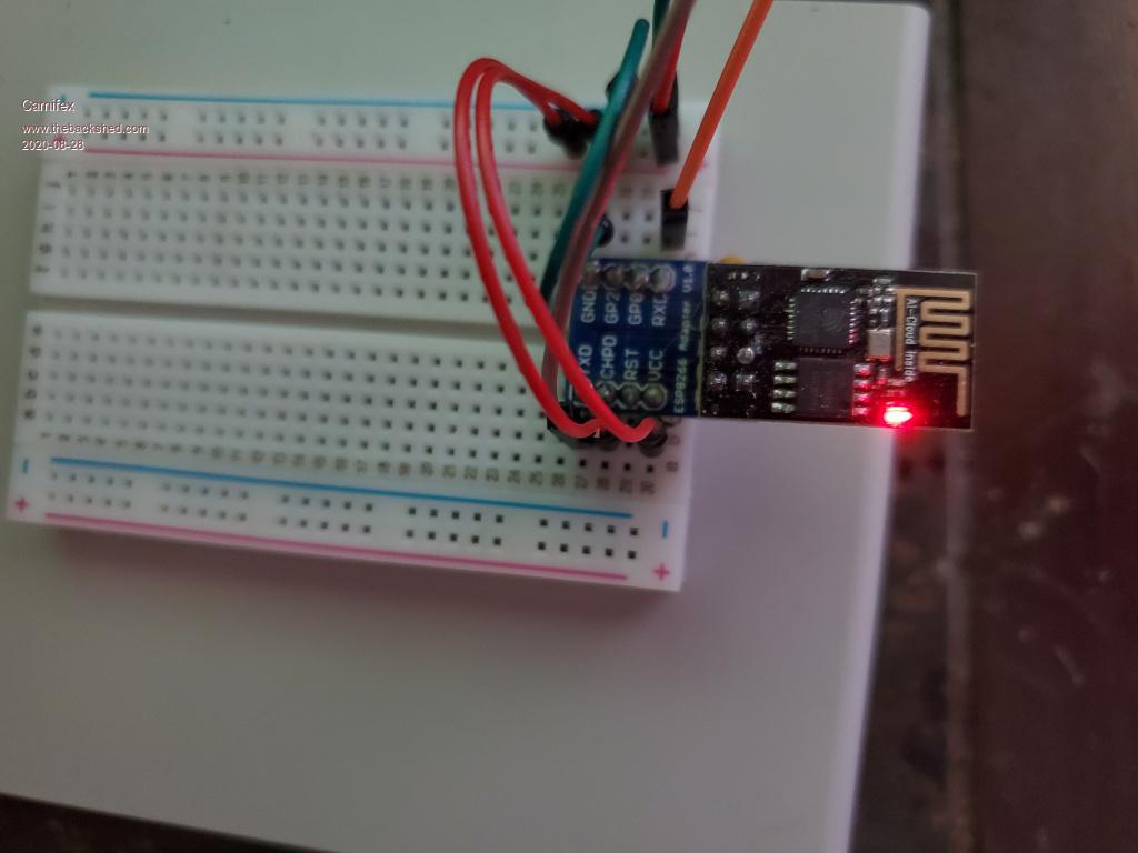

My esp is one I have had laying around for a few years, it was already configured from an arduino project I put together awhile back. My intent is to try them all this weekend and look over your code and see how your libraries work.
From your code, I assume you are using COM2, I wired mine to COM1. The only other thing I can think of is perhaps I have have an older version esp.

I'm powering using THIS puny USB Power Regulator from Amazon, so your bench power supply will be more than suitable for the job. I power it using a generic external USB charging device plugged into "mains" (thats how you Brits say it, right?) power. :-)
I tie grounds from the CMM2 GPIO pin together to the ESP8266 pin and the power supply ground, if I didn't do this, i was unable to read data from the serial connection.
Rich/dw
