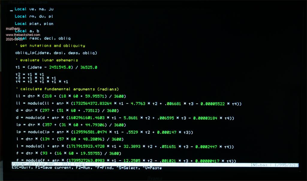

Just posted V5.05.06b9
This has two new modes designed to be used as the default on widescreen monitors.
Mode 11 (1280 x 720 @ 60Hz), Mode 12 (960 x 540 @ 60 Hz)
In the case of Mode 11 the monitor sees a 720p signal. Those of you with HDMI adapter and/or using televisions may find this is a better mode to use as the default (untested)
In the case of mode 12 the monitor sees 1920 x 1080 @ 60 Hz. This mode works superbly on a 1080p monitor with a VGA input (my setup) giving the best image I have ever seen from the CMM2, perfect for editing as each CMM2 pixel maps onto exactly 4 physical pixels.
Both modes support 8 and 16 bit colour but not 12 and both are great for displaying jpgs etc.
Remember the way to set the default display mode is:
OPTION DEFAULT MODE n
n can now be one of: 1, 8, 9, 10, 11, or 12
This is preserved when updating the firmware.
Jim: your colourbar program will need a tweak as modes 11 and 12 only have one page available (page 0) in 16-bit colour mode
960x540 image

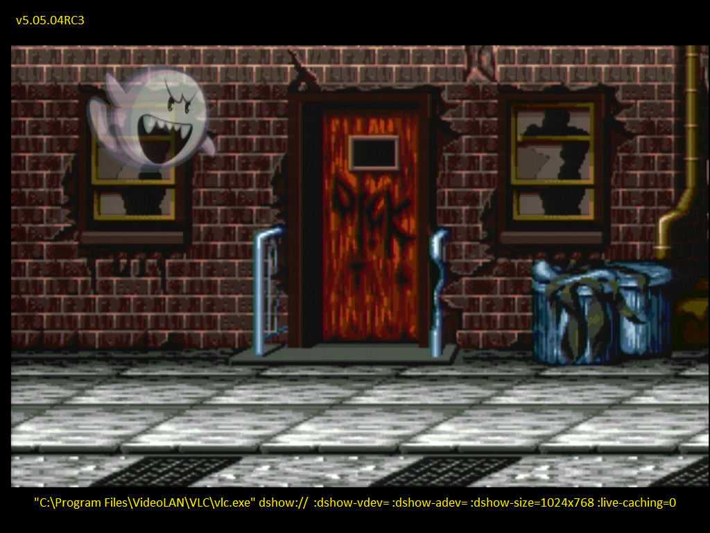

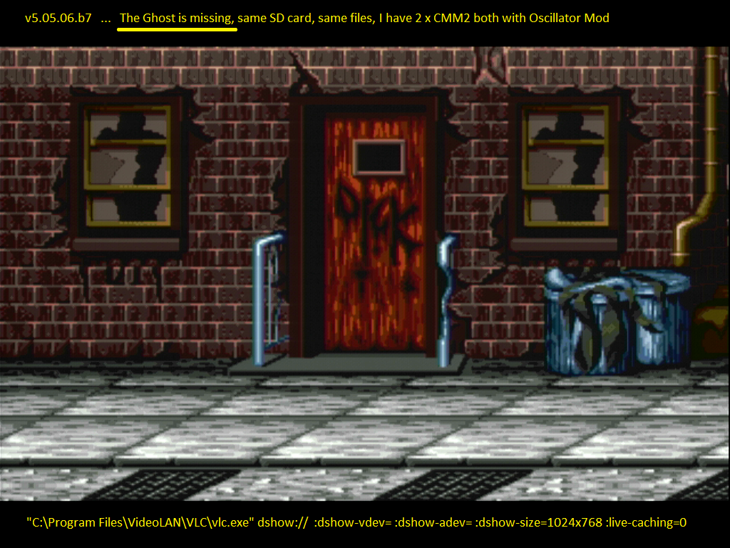

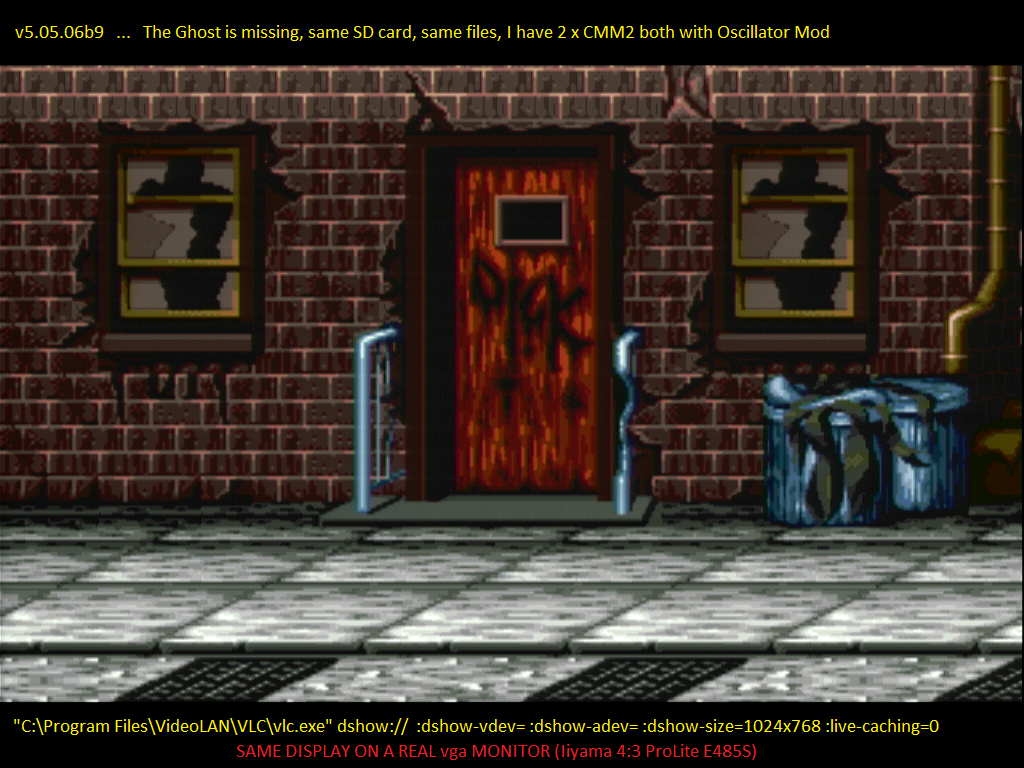

Posted: 10:05pm 19 Sep 2020
Peter,
Many Thanks for your work on this but I seem to have found a bug on the last few firmware releases whilst I have been testing the VGA-->USB2 Video Capture device.  These also show up on a real monitor (Iiyama 4:3 Prolite E485S) on both my CMM2's.
When it worked: V5.05.04RC3
No Ghost
Still No Ghost
The program I am using to test this, basically your code from this post which I modified to change to a directory where the files are located, and to exit cleanly when ESC is pressed.
Here is the code I am testing so you can replicate the problem (minus the MP3 of course, I include a text file showing the spec of my HOTEL.MP3)
Ghost Demo.zip
Maybe I have done something stupid, but I am surprised no one else has found this one.
Sorry
Womble

Posts: 12093
Posted: 07:56am 20 Sep 2020
  Quote  When it worked: V5.05.04RC3
Thanks for the report. Now need to understand what I have broken
Edited 2020-09-20 19:45 by matherp
