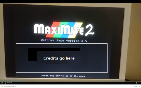

Hi folks,
Does anyone have (or want to write) a demo of vertically rolling credits that I can repurpose for the Welcome Tape splash-screen. I specifically need to show the credits in a letterbox rather than scrolling the entire screen, i.e.
I'm suspect I will need to fade the text in and out from black as it passes through the letterbox otherwise it will probably look very odd.
