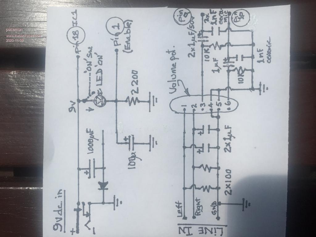

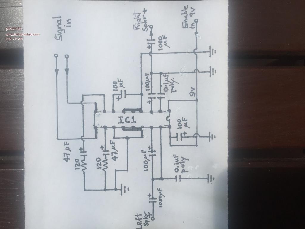

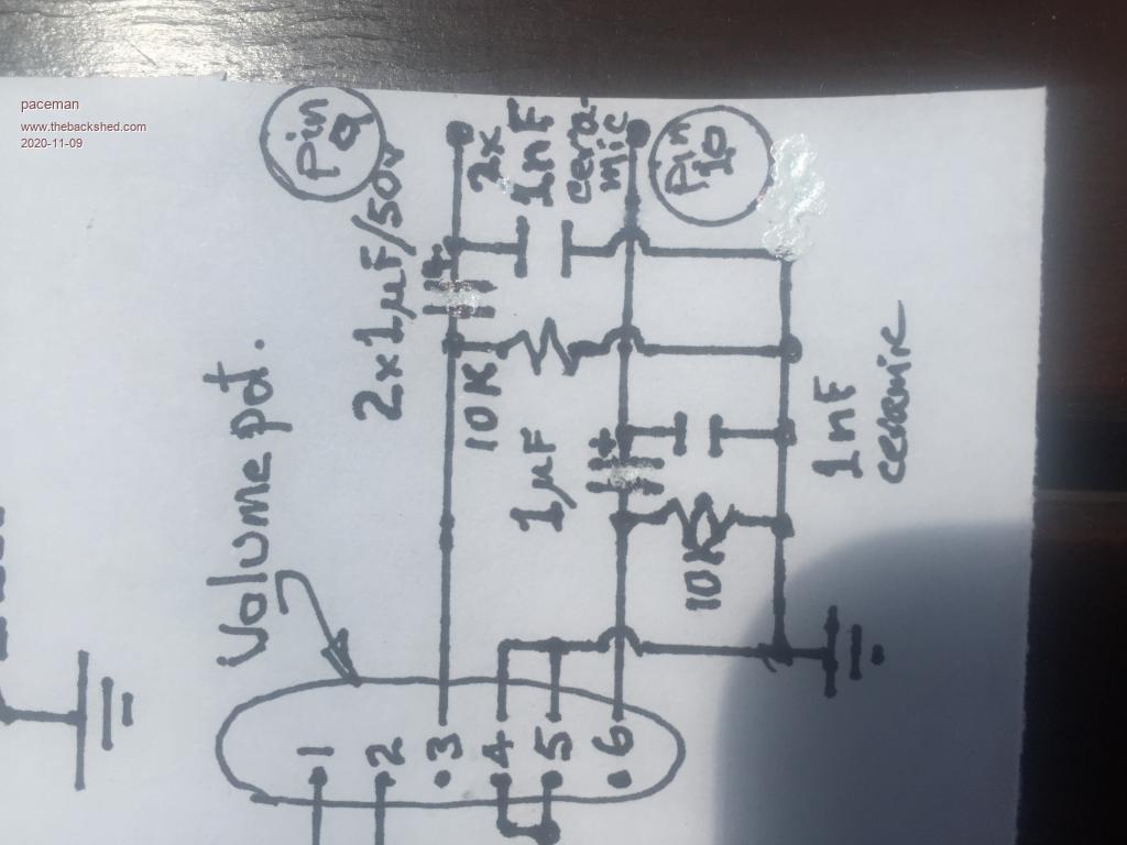

This same DC blocking audio issue came up recently in this thread so I thought I'd post some more info on what I'd found.
I decided to trace the amplifier PCB in my desktop speakers to see whether it included blocking capacitors or not. Turns out it has got them (ordinary 1uF polarised cans) so I checked their values and they were still pretty close to nominal,  even after 10 or more years of use. I decided to replace them anyway and also checked all the others on the PCB - again no bad ones.
One thing I do wonder about though is whether they're polarised correctly. The positive side of the cap doesn't face the "Line-in" plugs, it's reversed. It then connects to what is presumably the amplifier IC (it's unmarked). The PCB silkscreen confirms that orientation, so no installation mistake.
The photos below show the circuit I traced out.
My "fix" of the garbling problem was to put a 1uF SMD cap in-line in both audio channel cables, this fixes the garbling but also limits the bass.
Given that there are now two blocking caps in each channel's input, is there a better way of doing this?
Also is the orientation of the amp's blocking cap back to front?
Is someone able to shed some light on the identification of the amp IC.
Greg
Posts: 6626
Posted: 06:21am 09 Nov 2020
The CMM2 likes the load to be 5k or greater.
Your circuit shows 100 ohm resistors across the inputs. That is what I would expect if it's intended to be fed from headphone or speaker outputs, not line level.
If the 100 ohm is correct, that would explain why 1uF results in loss of bass.
It would also explain the distortion.
A 4.7K resistor instead of the blocking capacitor would take the load off the CMM2 and might still give reasonable audio level.

Posts: 6195
Posted: 12:52pm 09 Nov 2020
If an amplifier has a capacitor at the input, and it is a polarized capacitor (electrolytic, or tantalum) there is a chance that connecting the CMM2 causes a reverse polarity on that capactor. In that case the polarized capacitor can cause distortion, or start conducting.
P.S. Geoff/Peter maybe next time ... add capacitors to the CMM2 at the audio output, and provide a bypass jumper for DC coupling for the 1 or 2 that use the DAC output for something else.

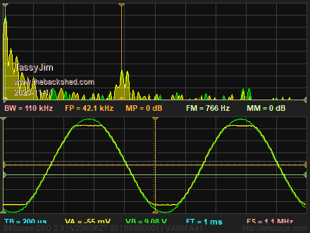

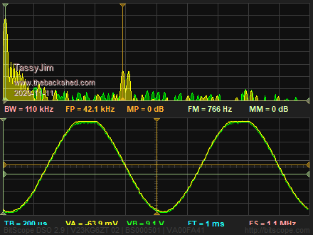

Posts: 6626
Posted: 06:44am 11 Nov 2020

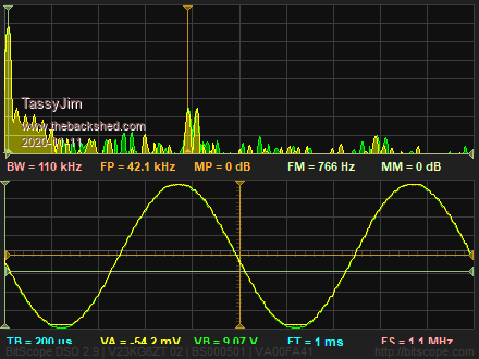

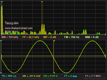

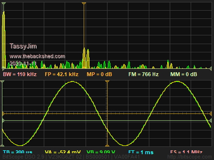

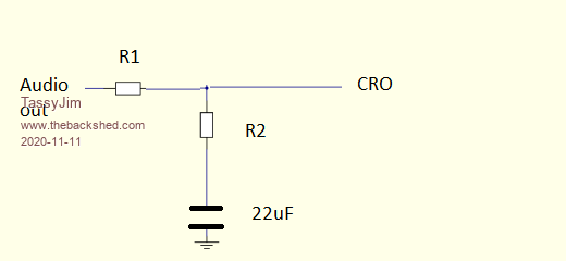

I decided to do a few experiments with different loading on the audio output.
R1 is the series resistor and R2 is a shunt to ground. R2 goes via a 22uF capacitor to remove any DC effects.
Initially I started with R1 = 0 ohms (shorted) and R2 = 4.7k

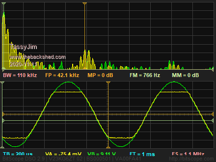

Next R2 = 1.8k - no obvious problems.
With R2 = 1k, flattening of the waveform is hard to see but the harmonics in the spectrum are growing.
R2 390 ohms and the curve looks very flat.
200 ohms and things look very bad. Even my cloth ears wouldn't like it.
Connecting my speakers instead of the dummy loads and you can see one side flattening. It is one sided because there is no DC blocking capacitor.
With my speakers, I found that 4.7k in series (R1) and 0.01uF shunting to ground gives a bit of low pass filtering and stops the over-loading of the audio output.
Most of the audio problems so far can be put down to using amps with low input impedance. A 4.7k resistor in series with the audio output will resolve the distortion and still leave plenty of signal to disturb the neighbours.
The data sheet calls for 5k or higher and I guess that they know what they are talking about.
Edited 2020-11-11 16:46 by TassyJim
