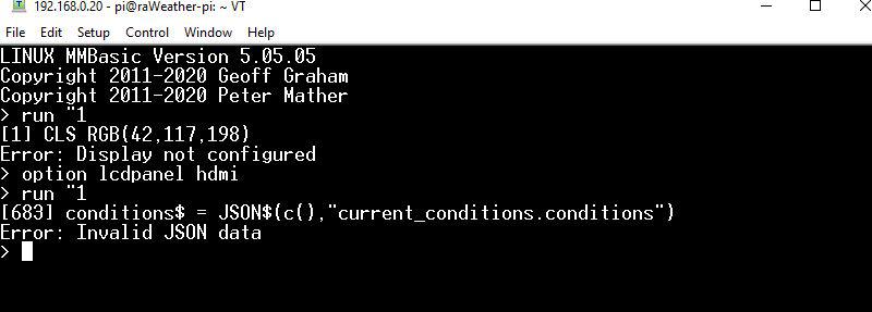

btw that other error I mentioned is still happening, I've narrowed it down to one section of code
SUB Forecast
LONGSTRING PRINT c()
conditions$ = JSON$(c(),"current_conditions.conditions")
print conditions$
I actually thought it would do the longstring print before it went on to the JSON$
edit: if I type run straight away it then runs fine till the next time, I suspect it might be something wrong in the data being received so I'm going to do the longstring print straight after wget and see how that goes

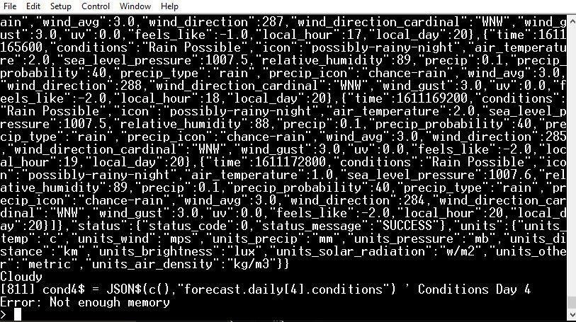

I thought it might be the buffer for c() wasn't large enough and was not getting the end }}, I had it at 15000
I then counted the characters received and there was 93885, it should have been enough but I've upped it to 16K just in case

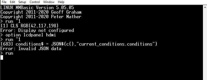

Posted: 07:47pm 10 Jan 2021
Sorry Peter, it crashed again first time I pressed run
I deleted the old mmbasic, and .options
transferred this version and got this immediately
Edit:
Without doing anything else I pressed run and it ran, same as before
btw it was around secs = 17 when I pressed run the first time so it shouldn't have tried to get the JSON data
Edited 2021-01-11 05:49 by lew247

Posts: 12083
Posted: 10:40pm 10 Jan 2021
Ok - that's useful. It looks like the json you are trying to load is simply too big and/or complex for the parser. Nothing I can do about it I'm afraid

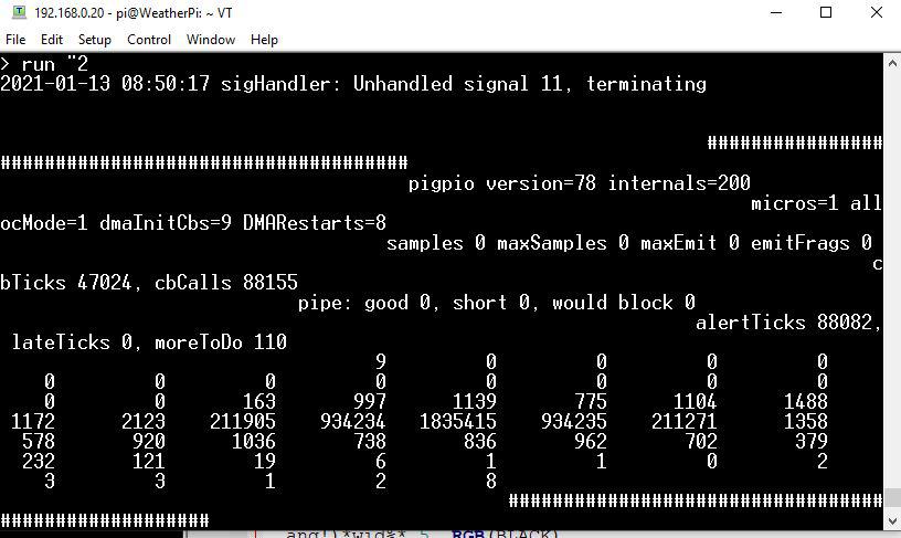

I checked this by loading it up again and running it overnight, over 12 hours so far with no crashes
The only thing missing was Image rotate
This version worked best out of all the ones you did yesterday, it ran for several hours before crashing and throwing this error
If I close the terminal and do screen -D -r it goes back to the error and won't do anything until I close the terminal again

Peter it's working perfectly for over 2 hours so far.
It did crash the very first time I press run but it was also a new install of the latest Stretch, Pigpio and python3-distutils on a clean SD card.
I took a screenshot in case it's any help

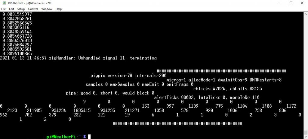

I spoke too soon
it crashed after almost 3 hours
Posts: 12083
Posted: 12:04pm 13 Jan 2021
Please run it on the version of stretch that you posted - any upgrades are likely to break it - this is exactly the problem with the whole Pi infrastructure
