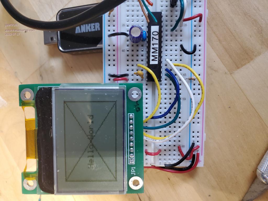

The latest release of the MM2, MM+ and MMX firmware includes the ability to write drivers for all sorts of displays entirely in Basic.
To write a display driver is now simple with no "C" knowledge needed. Of course this comes with a performance impact but for smaller displays and many applications this shouldn't be an issue.
Once a display driver is written all of the in-built commands of the MM2, MM+ and MMX can then be used in the same way as for any in-built display.
One big plus is that the same code can be used on the MM2, MM+ and MMX with no changes needed other than if different pins are used.
A display driver comprises just three routines
1. initialise the display
2. output a filled rectangle to the display (a single pixel is a very small rectangle )
sub MM.USER_RECTANGLE x1%, y1%, x2%, y2%, c%
' code to draw a rectangle with the colour c%
end sub
3. output a rectangular bitmap to the display.
sub MM.USER_BITMAP x1%, y1%, width%, height%, scale%, fc%, bc%, bitmap%
' code to display a bitmap with foreground colour fc% and background bc%
' bitmap% is the address of the bitmap. Use PEEK() to get the data.
' each byte is a horizontal row of pixels starting with the most significant bit
end sub
The initialisation of the display can be done in the main program or in the library and the other two routines are subroutines with defined names and parameters.

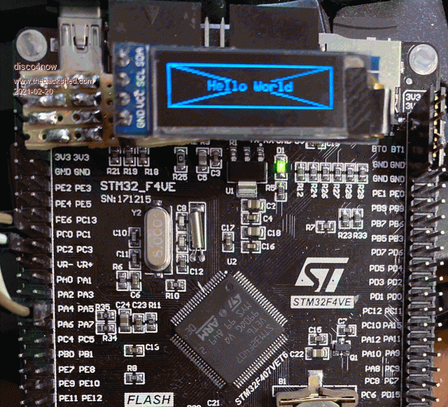

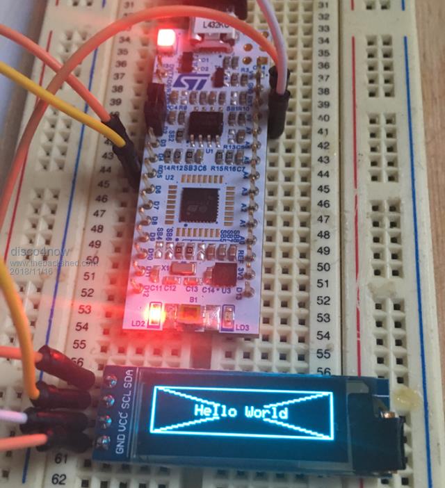

This is all best illustrated by looking a Basic display driver for one of the SSD1306 OLEDs, in this case driven over an I2C bus with just a two wire connection.
I've tried to comment this as much as possible. The complexity is always in converting the simple drawing instruction to draw a rectangle or bitmap into the required sequence to implement this on any specific type of display
if you write your own display drivers please add to this thread
userdisplayinit
line 0,0,mm.hres-1,mm.vres-1
line mm.hres-1,0,0,mm.vres-1
box 0,0,mm.hres,mm.vres
text mm.hres/2,mm.vres/2,"Hello World",CM,8
end
sub userdisplayinit

disco4now
Joined: 18/12/2014
Posts: 1162
Posted: 05:46am 16 Nov 2018
Driver for 0.91" SSD3306 128*32
I created a driver for this display based on Peters code above.
This is the LCD. SSD3306 I2C 128*32 Banggood
The changes are.
OPTION LCDPANEL USER,128,32
During initialization two changes:
OLED.SCmd(&HA8)'MULTIPLEX
'OLED.SCmd(&H3F)' 3F required for 128x64 display
OLED.SCmd(&H1F)' 1F required for 128x32 display
OLED.SCmd(&HDA)'COMPINS
'OLED.SCmd(&H12)'12 for 128*64
OLED.SCmd(&H02)'02 for 128*32
The buffer required is only half the size so
for i% = 0 to 3 'was 0 to 7
s$(i%)=string$(128,chr$(0))
next i%
'https://www.banggood.com/0_91-Inch-128x32-IIC-I2C-Blue-OLED-LCD-Display-DIY-Oled-Module-SSD1306-Driver-IC-D C-3_3V-5V-p-1140506.html?cur_warehouse=CN
on error skip 'if OPTION is already set then ignore the error
OPTION LCDPANEL USER, 128,32
userdisplayinit
end
sub userdisplayinit
' The 0.91" SSD1306 display is 128 x 32 monochrome pixels
' This is arranged as 128 bytes x 4 bytes so a byte will cover the pixels in 8 rows of the display
' this makes it a bit tricky to program as we have to remember what is in the other 7 rows if we want to update a pixel in any specific row
' In this example we will hold a display image in a string array with 8 elements each 128 bytes long
OPTION explicit
OPTION default none
on error skip 'if global variabels aren't yet set ignore the error
erase S$(), tmaskarray(), bmaskarray()
DIM S$(3) length 128 'this is the array that stores the screen image
DIM integer tmaskarray(7)=(255,254,252,248,240,224,192,128) ' mask for writing pixels left to right
DIM integer bmaskarray(7)=(1,3,7,15,31,63,127,255) 'mask for pixels right to left
local i%
on error skip ' if I2C already open ignore the error
i2c open 400,1000
' send the intialisation instructions to the display
OLED.SCmd(&HAE)'DISPLAYOFF)
OLED.SCmd(&HD5)'DISPLAYCLOCKDIV
OLED.SCmd(&H80)'the suggested ratio &H80
OLED.SCmd(
&HA8)'MULTIPLEX
OLED.SCmd(
&HD3)'DISPLAYOFFSET
OLED.SCmd(&H0)'no offset
OLED.SCmd(
&H40)'STARTLINE
OLED.SCmd(
&H8D)'CHARGEPUMP
OLED.SCmd(&H14)
OLED.SCmd(
&H20)'MEMORYMODE
OLED.SCmd(&H00)'&H0 act like ks0108 Horizontal Address Mode
OLED.SCmd(
&HA1)'SEGREMAP OR 1 A0 for Reverse direction
OLED.SCmd(
&HC8)'COMSCANDEC C0 for Reverse Landscape
OLED.SCmd(
&HDA)'COMPINS
OLED.SCmd(
&H81)'SETCONTRAST
OLED.SCmd(&HCF) 'CF
OLED.SCmd(
&Hd9)'SETPRECHARGE
OLED.SCmd(&HF1)
OLED.SCmd(
&HDB)'VCOMDETECT
OLED.SCmd(&H40)
OLED.SCmd(
&HA4)'DISPLAYALLON_RESUME
OLED.SCmd(&HA6)'NORMALDISPLAY
OLED.SCmd(&HAF)'DISPLAYON
' Set the memory image of the display to all zeroes
for i% = 0 to 3
s$(i%)=
next i%
' Refresh the display with the new blank image
update 0, 0, mm.hres-1, mm.vres\8 -1
end sub

Again to confirm that the ARMMITE F4 does support user defined LCDPanels written in MMBasic.
This driver from memory has a little glitch, if you attempt to display a right justified text, that uses the scale option in the text command and it results in the text being beyond the x=0 co-ordinate it breaks.Fixing this is an exercise left for the reader.
The NRF socket has 3.3v, GND and the I2C-SCL and I2C-SDA pins available and is the ideal place to connect the i2C display.
  Quote  'Geekcreit 0.91 Inch 128x32 IIC I2C Blue OLED LCD Display DIY Module SSD1306 Driver IC DC 3.3V 5V

New User Basic LCD driver for SED1565 and similar mono LCD's.
The code below and photo is a LCDPANE User driver for a 100 x 64 pixel mono LCD based on the SED1565 driver.  This driver is similar to the UC1609 Mono LCD driver.  Its a very low power SPI display driver with onboard charge pumps, for operation from 2.7 to 5.5v.  Supply current is about .35 mA active.  I have a bunch of these displays from an old project and thought getting them to talk to the MMITE would be a nice challenge.  The code here is heavily cribbed from the SSD1306 OLED display.  These displays have a similar layout and pretty minor changes were require- explained in the code.

'RST  4 DOUT  <DS PIN 5> GPIO
'ARCHIVED AS REV1
'REV 2-
'Basic Test Code *****************
userdisplayinit       'init display
'Standard User Display Test
Line 0,0,MM.HRes-1,MM.VRes-1
Line MM.HRes-1,0,0,MM.VRes-1
Box 0,0,MM.HRes-1,MM.VRes-1
Text MM.HRes/2,MM.VRes/2,"Hello World","CM",8
End
'basic end- driver code follows
'LCD DRIVER CODE- MMite User LCDPANEL Format
' Preliminary- Global
'init routine - main entry, setup hw and declare vars
Sub userdisplayinit
Option explicit
Option default none
On error skip
Option LCDPANEL USER, 100,64
On error skip
Erase S$(), tmaskarray(), bmaskarray()
Dim S$(7) length 100 'this is the array that stores the screen image
Dim integer tmaskarray(7)=(255,254,252,248,240,224,192,128) ' mask for writing pixels left to right
Dim integer bmaskarray(7)=(1,3,7,15,31,63,127,255) 'mask for pixels right to left
Local i%
' HW SETUP
'SET DEFAULT PIN STATES BEFORE DDR
Pin(5)=0    'CS LOW, NOTE ACTIVE HIGH
Pin(2)=0    'A0 LOW= CMD, HIGH DATA
Pin(4)=0    'RESET DISPLAY
Pin(24)=0   'LOGIC TRIGGER- DEBUG
'SET DDR'S
SetPin 2,DOUT  'A0 COMMAND/DATA
SetPin 4,DOUT  'RST
SetPin 5,DOUT  'CS
SetPin 24,DOUT 'AUX- DEBUG, LOGIC TRIGGER
'DEBUG
Pin(24)=1   'START RISE- MAIN TRIGGER
Print "MAIN TRIGGER"
SPI OPEN 1000000,0,8    '1M
Pause 5       'WAIT 5 MS WITH RESET HIGH
Pin(4)=1      'RESET INACTIVE
'END HW SETUP- DISPLAY IS RESET, CS IS LOW- INACTIVE
 Pin(2)=0    'A0 LOW- COMMAND
 Pin(5)=1    'CS ACTIVE
 SPI WRITE 11,&HE2,&HA3,&HA6,&HA1,&HC0,&H23,&H81,&H2B,&H2F,&HAF,&H40
 Pin(5)=0
'INITIALIZED- create array and clear
For i% = 0 To 7           'PAGES
 s$(i%)=String$(100,Chr$(0))     'ZERO OUT
Next i%
update 0, 0, MM.HRes-1, MM.VRes\8 -1
End Sub
'-----------------------end of userdisplayinit ------------------------------
' standard driver requires two routines-
'  1. output a filled rectangle to display
'  2. output an image
' FILLED RECTANGLE
Sub MM.USER_RECTANGLE(x1%, y1%, x2%, y2%, fcol%)
Local integer i, j, k, l, t, mask, top_row, bottom_row, top_start, bottom_end

John Wettroth
athlon1900
Joined: 10/10/2019
Location: Austria
Posts: 51
Posted: 02:26am 27 Jul 2022
  jwettroth said  New User Basic LCD driver for SED1565 and similar mono LCD's.
Many thanks , good job
