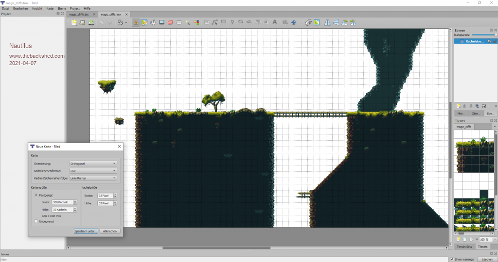

  epsilon said  Are you using a level editor to create the tilemap.csv?
Yes - the TILED map editor is your friend   ( https://www.mapeditor.org/ )

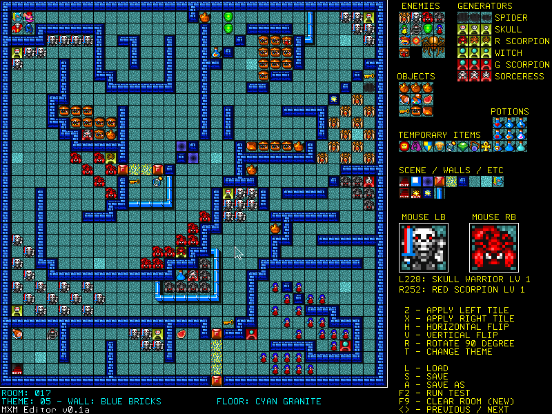

MauroXavier
Joined: 06/03/2016
Location: Brazil
Posts: 307
Posted: 07:37pm 06 Apr 2021
Nautilus, very clever idea, I will get a look at this software. Thanks for the tip!
Meanwhile, I suffered developing a map editor only to have the experience creating maps directly on the CMM2... But for sure this isn't the most recommendable experience to speed up the development of a 2D game.
Now I'm seriously thinking about quit making another map editor to the INTO THE DARKNESS game.
