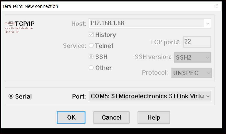

Hello People,
i can not find Information on how to start with the NUCLEO-L432KC.
I have found this PDF:
2019-03-29_012130_Armmite_L4_Manual.pdf
And this Firmware: 2019-05-09_041753_ArmmiteL4.zip
Are this the latest Documentaion and Firmware?
The Documentation says:
Programming the Nucleo-L432KC
Copy the supplied .bin file to the disk NODE-L432KC on a PC
After doing this, i cannot connect to Serial console (USB and Pin A1/A2)?
Posts: 12017
Posted: 08:38am 18 May 2021
Just checked and that is the latest version and works fine for me. Do you see the ST-LINK serial port? That is the console connection when the firmware is loaded.
If not you may need to install the driver. NB speed is 38400

Ok Guys,
thank you for the Help. Now it works. The wrong baudrate was the Problem.
I am suprised how easy it is to flash this NUCLEO-L432KC Boards
