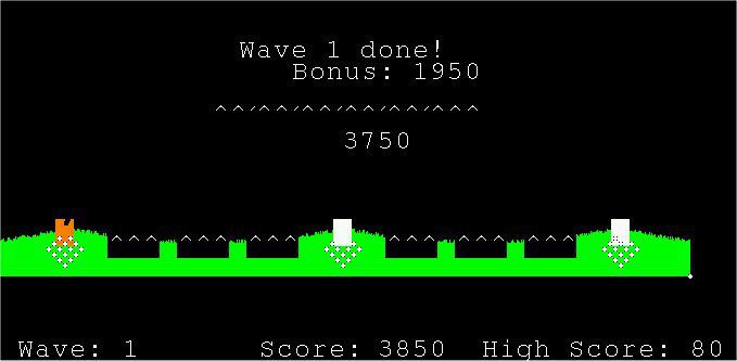

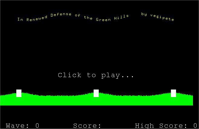

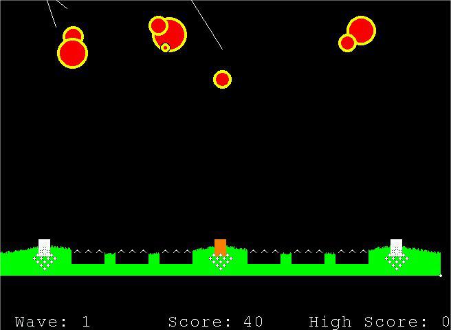

I would post on an original thread, but I couldn't find one--just posts in the Programming Challenge thread.
Vegipete's game did not too extensively use features not compatible with the F4 (pages, etc.), but it turns out the one thing he did use was the speed of the CMM2. On the F4, it's a more--how might I say it--"stately" pace (perhaps suited to now three-quarter's-century-old reflexes of this would-be Missle Commander).
Instead of a mouse, I used the touch feature of the F4. The LCD is the 800x480 IPS display, but since vegipete used mode 2,12, 640x400, I just used that much of the screen, and used the extra 80 pixels at the bottom for scorekeeping. Touch is also used to select which of the three missile bases is firing.
The program is intended to run on both the CMM2 and the F4, and I've tested it on both. I couldn't get the "High Score" to display properly on the CMM2, and I don't know why (but don't want to spend more time).
I reduced the number of missiles--incoming and outgoing--from 48 to 33 for the F4. This gave a bit of a speed boost. Other speedups might be possible, but I did not note any throttling delays in the main loop.
Other than adequate speed, the biggest thing the F4 port is lacking is the sound effects which Pete used so effectively. It may be possible to replicate them on the F4, but I don't have any idea how to go about that.
I could not make a movie--the green in the green hills washed out completely, as did the red in the explosions, so here are screen shots after terminating with Ctrl-C (I could have set a touch area to do "SAVE IMAGE nnn.BMP".)
This was a fun exercise even if the result is less challenging than I had hoped. I keep learning from vegipete's skills.
