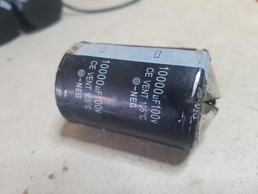

So far I have used these 100V 10,000uF caps in my inverter builds.
Why not use one for the DC-DC converter/power supply?
Input DC peak volts from the bridge rectifier is 95V.
No problems. Right?
So I built the power supply and it works fine, with short circuit protection,
current limit, etc. It charged the bike battery fine at 54V and 7 Amps.
Once the battery was charged I left it to finish off.
Later I discovered a blank LCD screen..
not good.

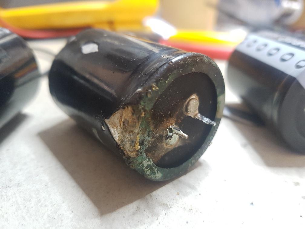

The cap had found it too hard to live with 95V and the current ripple from both the bridge rec. and the 20kHz PWM switching.
It looked like this after it spooged all it's guts over everything inside the
enclosure.
And that crap is very corrosive too.
So a cheap cap can cause a lot of extra work rebuilding your device.
And potentially damage a $600 ebike battery as an afterthought.
The aliexpress sourced cap had zero specifications so we just use them and see if they are OK.
For sure, when used is bulk DC supply caps in inverters, and used in large numbers
they are fine. (so far..)
I noticed the cap got warm but not hot when the supply was running.
Clearly it was not happy with the ripple current.
6 months ago I blew one of these caps from simple overvolting, I recall it was
only 110V I think.
Today I rebuilt the power supply using one of these , a Nichicon 4700uF 100V cap
costing $12 AUD. The aliexpress cap costs $4 US
After a few hours at 150W to 200W output, the cap remains at room temperature.
Nichicon give specs on max. ripple current.
the 4,700uf 100V cap has it at 5.2 Amps.
Ok, how do you measure this? Or do you calculate it?
I put a current sensor between the cap terminal and +ve supply and had a look
on the DSO.
The current increases each 1/2 wave of the mains supply, with peaks of about 3 Amps.
The current decreases due to PWM switching, at 20kHz with peaks of about 2-3 Amps
So there are two current signals on top of each other.
The total swing from low to high is only about 3 Amps since the PWM current pulses
follow the mains 1/2 wave up and down.
Anyway, it appears it will not blow up so I think it worth the $$ to get
caps that have specifications. It will save you many hours of work and worry.
I want to ask here how to size caps for these sort of jobs.
I don't like calculating ripple, I prefer to measure it.
How to measure it. RMS current is best? The specs may not use RMS current..
