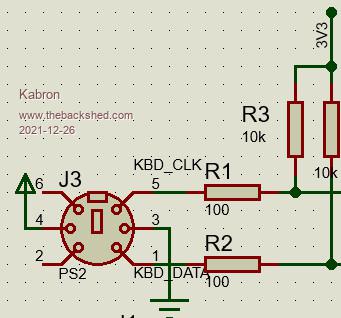

PS/2 keyboard perfectly works with this simple schematic
Posts: 9407
Posted: 09:39am 26 Dec 2021
It'll work fine, but if the keyboard supply is 5V then you MUST clamp the inputs to a Pico to 3.3V as the keyboard might have its own pullups to its supply (some do, although they shouldn't) and the built-in esd protection diodes might cook. I would recommend increasing the 100R resistors to 270R and adding BAT85 schottky signal diodes from the Pico inputs to 3V3. I've had this running in simulation and the max voltage at the pin was about 3.45V, the max allowed is VDD+0.3V, i.e. 3.6V in this case. The input resistors should be as high as possible, as additional protection, but above 300R the Pico won't pull a TTL input below 0.5V if a 10k pullup is used at the keyboard end. This arrangement (with 220R or 270R input resistors) is shown on an application note for a 3.3V FPGA (sorry, I can't remember where I found it).

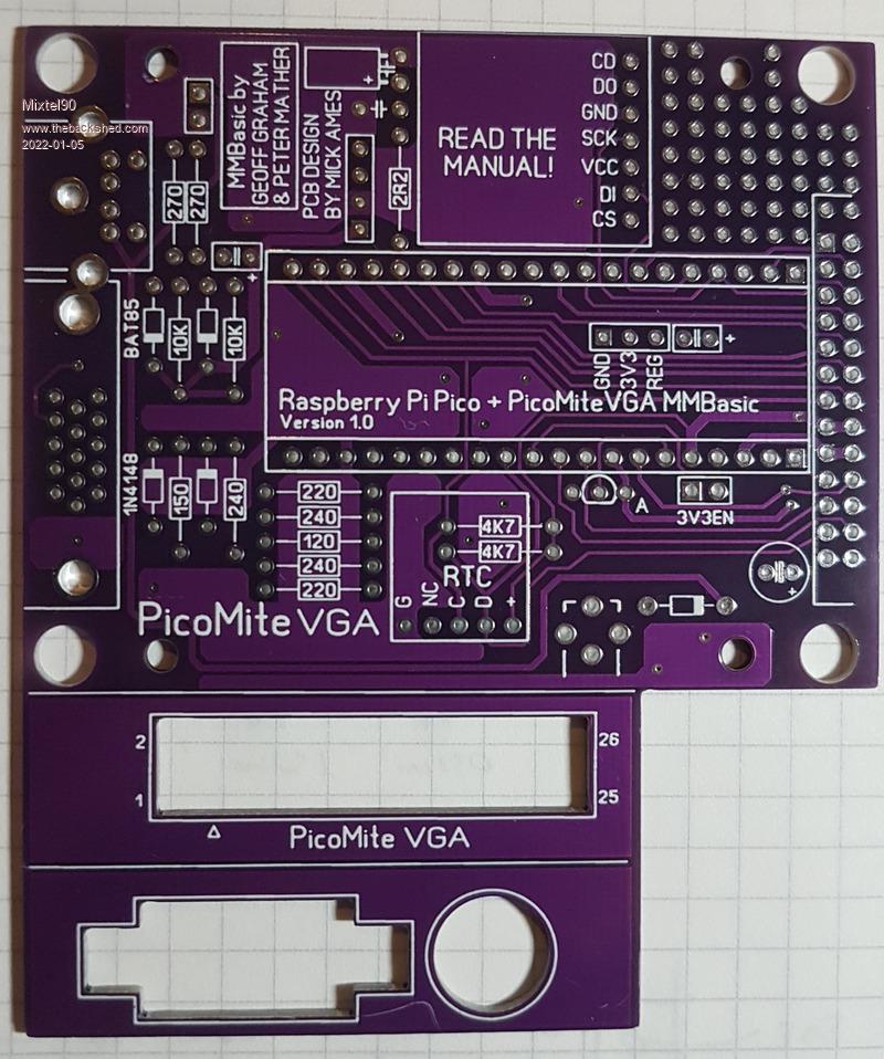

This is the board for the original version 1.0, which has a wiring fault on the PS/2 socket. I might be able to sort that out. Now I'm going to experiment with putting V score lines between the end plates and the main board so that they can be snapped. I can see that process being a bit fiddly, but exact precision isn't needed in this case.
I've now done a new version of this. This was a testing ground as it's the first time I'd used SL6 when ordering a board from JLC so I wasn't sure what would happen in some areas.
I love the colour!  :)

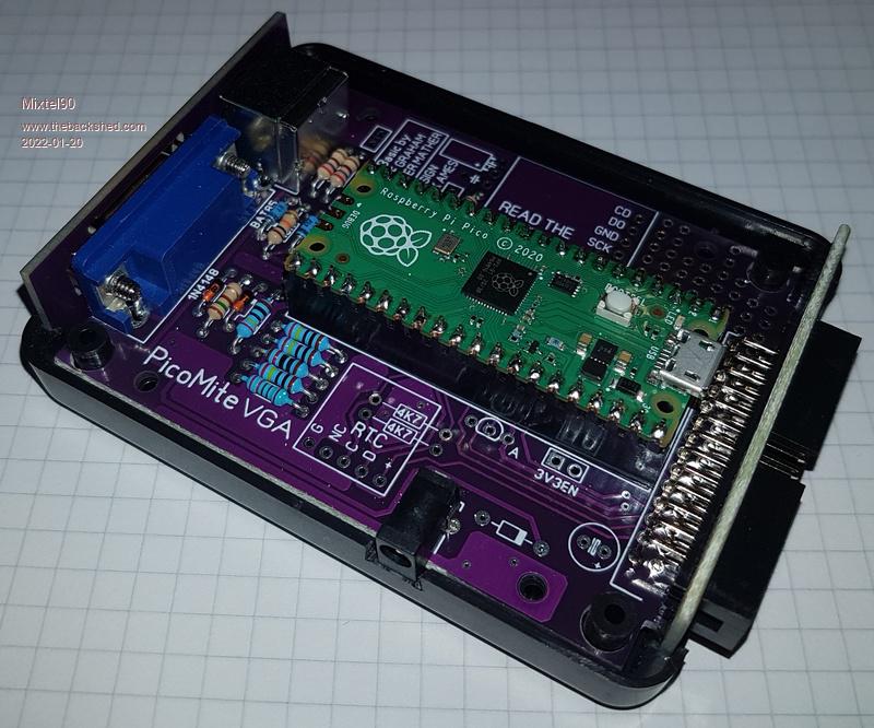

Posted: 09:48pm 19 Jan 2022
Well, with tracks to the keyboard socket isolated and powered via USB it's working so I must have done something right. It also fits into the case. :)
Now to finalise the latest version and build one of those. It has quite a few enhancements, but is more of a pig to get into the case...
