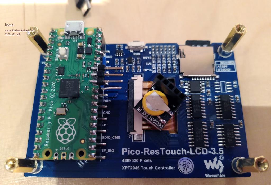

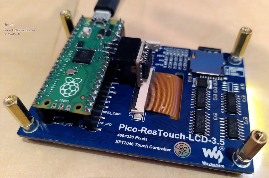

By the way, who cares: I have mounted the DS3231 from amazon plug-in for the Pico ResTouch LCD 3.5 and found it to be a good fit.
> option list
OPTION AUTORUN ON
OPTION COLOURCODE ON
OPTION SDCARD GP22
OPTION SYSTEM I2C GP26,GP27
OPTION LCDPANEL ILI9488W, RLANDSCAPE,GP8,GP15,GP9,GP13
OPTION RTC AUTO ENABLED
OPTION TOUCH GP16,GP17
GUI CALIBRATE 0, 251, 3862, 1278, -854
