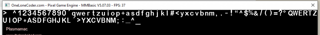

Hello,
in pa9 and DE keyboard, I cant type a question mark "?", and no "<" and ">". There is no "\" i.e. for integer division and path assignments  in option default path C:\...
"+" is "'" and "#" is "^" and "-" is "#" and no "[" and "]"
>option list
OPTION Default mode 9 1024x768
OPTION Default Font 1,1
OPTION Default path C:\andreas\Meine Dokumente\
OPTION Colourcode OFF
OPTION Keyboard DE
Current display 64,128
-andreas

Hi Andreas,
can you please create a list like that:
https://www.thebackshed.com/forum/ViewTopic.php?FID=16&TID=14518#181313
Best regards
Michael

andreas
Joined: 07/12/2020
Posts: 226
Posted: 06:51pm 31 Jan 2022
@twofingers  I thought I did it already? There was a picture containig a "wanted" and a "currently" code generated with pa3.
wanted has meant the code it should be in german and "currently" was what Peters pa3 generated.
https://www.thebackshed.com/forum/ViewTopic.php?FID=16&TID=14518#181313#181284
-andreas
Posts: 12303
Posted: 06:53pm 31 Jan 2022
  Quote  Hello,
Sorry but all that works as tested by me and twofingers if you are using a standard DE keyboard. Try OPTION RESET and start again with just OPTION KEYBOARD DE to start
andreas
Joined: 07/12/2020
Posts: 226
Posted: 07:02pm 31 Jan 2022
can you specify a path in option default path ?
I can't because in pa9 is no \
I'm using an IBM Model "m" and a perixx keyboard
Im running wine under debian linux to start MMBasic.exe
hmm... I could try to start MMBasic in a virtualbox Windows 10 or 11 - have both here..
-andreas
Posts: 12303
Posted: 07:05pm 31 Jan 2022
  Quote  Im running wine under debian linux to start MMBasic.exe
Is wine mapping the keys? what happens if you set the keyboard to UK or US?
andreas
Joined: 07/12/2020
Posts: 226
Posted: 07:09pm 31 Jan 2022
  Quote  Is wine mapping the keys?
I have to look for that - don't know but possible!
-anderas

@Andreas
  andreas said  @twofingers  I thought I did it already? There was a picture containig a "wanted" and a "currently" code generated with pa3.
...-andreas
Yes, you did it! (I did not realize that. Sorry! )
I don't understand why your table is different from mine.
I would expect them to be identical.
For UK layout I get the backslash with the key 92 (^) left of the "1".

Joined: 07/12/2020
Posts: 226
Posted: 08:11pm 31 Jan 2022
I tested pa9 with a nativ Windows 10 Fujitsu Notebook, german keyboard layout: works good!
I could not start MMBasic within VirtualBox 6.1 under Windows 7 & Windows 10. - it shows a white window.
Under wine/linux pa5 seems to be the best for me. I put some additional labels on the keys ;-)
So wine seems to have some hidden layer which does not fit - when I open the command windows CMD under wine and type any key, it is correct according to my keyboard but not together with MMBasic :-/
But this is my problem, not yours
-andreas
