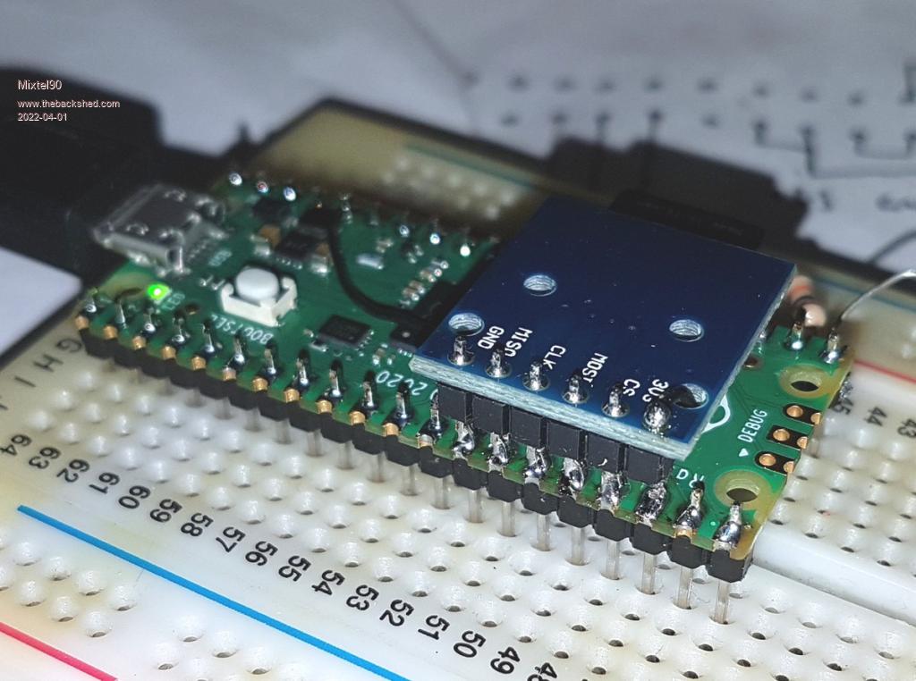

So what we need is a piggy-back board for a Pico that carries a uSDcard socket? I'll have a think....
The uSDsocket module I'm currently using can probably be (carefully) soldered directly over GND to GP13, having cut down the pins on it to 2mm-3mm. The VCC pin of the module would be cut off and a wire connected between it and the 3V3 pin of the PicoMite - via a 2R2 resistor if you are fussy. The module contains a capacitor of about 33uF and has 10k pullups on the control & data lines. It would make a plug-in PicoMite with it's own uSD on-board. The pins used are:
Wire to 3V3
GP13 - CS
GP14 - MOSI
GP15 - SCK
GP16 - MISO
GND
The uSDcard slot is over the top of GP18-GP21 so the card will project here.

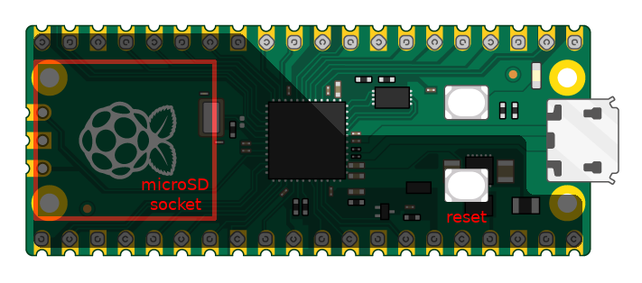

  Volhout said  I like those small boards, but (in my opinion) the ideal MMBasic RP2040 board would at least support an SD card
the simplest approach would be to design a small PCB that sits over the top of an existing PICO board, and contains a microSD socket, reset button, and perhaps even a 3-terminal 3v3 linear regulator to replace that nasty switcher:
  Volhout said  [...] because the flash would wear out too fast
aside from the massive effort for little gain that peter mentions, the wearing out of the non-replaceable onboard flash would indeed be of major concern. far safer to not go there!

Posts: 6169
Posted: 11:11am 31 Mar 2022
Just the SD card socket. Don't over-complicate it (*). If you make the piggy back board so it exactly overlays on the pico IO pins, then you can place it flat on the pico board, and solder the header pins through 2 boards at a time. Only need to make sure to use pico pins for SD that do not interfere with VGA pins, so the piggy board can be used for all pico's.
(*) reset and linear voltage regulator are only needed in limitted applications, end even then there are other work arounds (especially for the audio noise).

Posts: 9182
I've successfully soldered a SMD push button on top of pins 28 and 30. It just fits nicely and doesn't cause problems with pin 29. :)
The pins that my uSDcard module uses don't clash with the VGA version.

Posts: 2552
Posted: 12:07pm 31 Mar 2022
i have little interest in VGA, a simple approach would be to have cuttable tracks underneath to select between VGA-avoiding pins and GP16-GP20 (incompatible with VGA).
there is no cost to having pads for an AM1117 3v3 regulator, those who don't want to can simply not fit it. the same holds for a reset button (that i do use myself).
the board would need to be spaced up slightly to clear existing components.
remember, 3v3 needs to be picked up from pin 36, so the board needs to extend that far unless you use a flying wire.

Posts: 9182
Posted: 05:12pm 31 Mar 2022
So, I screwed up on the GP numbers, but it works fine.
It should be OPTION SDCARD GP13, GP11, GP12, GP10

Posts: 2552
Posted: 12:53am 01 Apr 2022
  Mixtel90 said  So, I screwed up on the GP numbers, but it works fine.
i'd forgotten that the SPI for the SD card was now bitbanged     i've ordered a handful of those little boards from ebay. for my user case, i'll mount it over pins 23-28, socket-side up, with the 3v3 trace cut and routed up to pin 36.
LED: a small daughterboard would suit those who want to get the SD card 'out of the way', much as was the case with the Explore-64 module. having the socket onboard is just one less thing to worry about when juggling wires on a solderless breadboard, or (shock, horror) building up a project on veroboard. but, as Mick has demonstrated, there is a similar solution already available ready-made.

Posts: 9182
Posted: 08:12am 01 Apr 2022
I'll let you know if this one comes in handy. :)  I suppose they might if you had to save on PCB area. uSDcard holders are a pig to solder but they are the only size that will fit underneath a Pico to save space.
