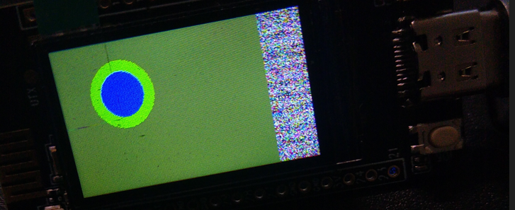

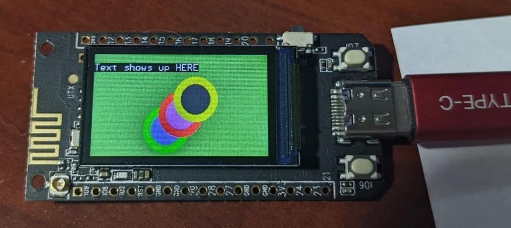

The T-PicoC3 from Tindie has a lot going for it.  <$9 (plus $9 shipping for one or several boards) gives you a RP2040 machine that works with MMBasic (a must for my use). Plus it comes with a wired 135X240 color display fully drivable by MMBasic. Also two pushbuttons (gp6, gp7).  Plus there is a ESP32 supposedly supporting Bluetooth and Wi-Fi that I haven't begun to play with yet, all on one board.  Picture and sample code below.
One thing I haven't figured out yet, each time I reconnect it to Tera Term, I have to reload the .uf2 file in order for the serial channel to show up.  A real annoyance, but at least the flash programs are still there.
Warning:  I am presenting code with pin numbers that work.  It may be that different pin numbers should be used, but these make the image below very reliably.
I would welcome anyone else's comments, questions or corrections.
PS: The screen looks much better than my cruddy phone picture of it.
' T-PicoC3 test program
' OPTION SYSTEM SPI gp2, gp3, gp0
' OPTION LCDPANEL ST7789, LANDSCAPE, gp1, gp6, gp5, gp4
CLS RGB(100,150,60)
Text 0,12, "Text shows up HERE"
Circle 100,100, 30,10,1,RGB(green), RGB(blue)
Circle 120,80,30,10,1,RGB(red),RGB(200,0,200)
Circle 140,60,30,10,1,RGB(200,200,0),RGB(50,50,50)

Have you got a circuit diagram for it?
The problem with this sort of thing is in knowing what things are connected to. Using pins that are normally used for something else on a PicoMite system can easily mess things up, as others have discovered.  :(
Another niggle that I have with this sort of thing is problems you can get if you want to actually use it in something rather than experiment on it. I'll take this board as an example, but that's only because it's convenient to do so. :) Almost all other modules have problems too. You have two mounting holes, both at the same end. If you want to use the ESP then you can't put anything metallic in the lower hole as it's too close to the antenna. The RH end is unsupported - where you need support because of the USB connector. You can't plug anything into the remote antenna socket without increasing the distance between the front of the screen and the rear of a front panel as the plug projects forwards. I'm not sure what the switch does, but it would need some sort of slider system to operate it from outside a box. Likewise the two buttons - they aren't the sort that can take button caps. These are minor things, but they make things awkward. It wouldn't surprise me if this board wasn't intended to be used in portrait mode with the buttons at the bottom and the switch accessible from the side for some sort of hand-held device.
Posts: 4330
Posted: 08:37am 23 May 2022
Schematic on here  I think.
Aha, this
Edited 2022-05-23 18:38 by JohnS
Posts: 8847
Posted: 09:47am 23 May 2022
An interesting little board, if a little restricted for external I/O.
Flip the USB connector over to connect to the ESP or the RP2040. Green & blue LEDs indicate which. Neat. :)
Battery charging from USB built in.
ADC0 (GP26) is tied to the battery voltage, but ADC3 (GP29) is wired out.
GP0 to GP5 are used by the display.
GP8 to GP11 are connected to the ESP.
You seem to get a lot for your money.

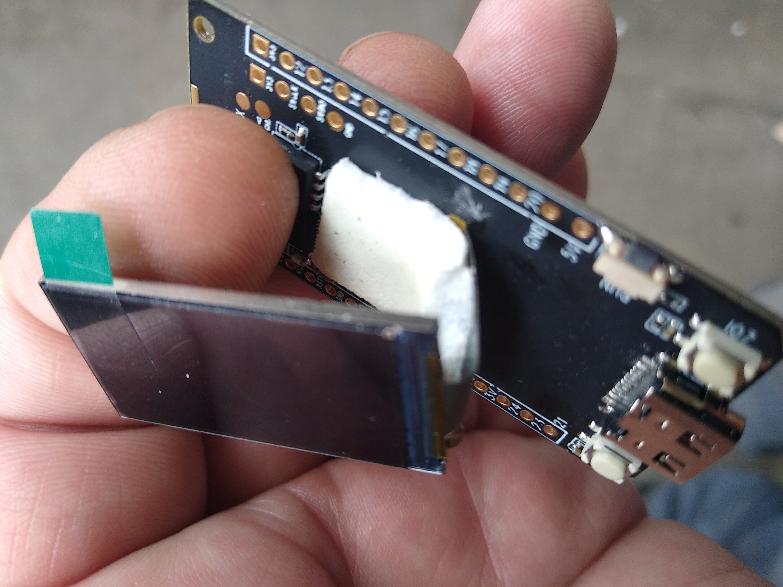

Firmware loaded with no issues and it's sitting here, running @378MHz
Note to Mixtel90: That comment you made regarding the antenna connector? The display is only held on with tape. The idea is that you pull it away from the board when you install in an enclosure.

My comment about the connector was that it's too close to the fixing hole. If you use a metal screw or mounting pillar there then you'll almost certainly de-tune the antenna to some extent. You can get round it by using a nylon pillar and screw, but I bet that isn't in the instructions. :) Mind you, that is the ground end of the antenna so the effect may not be too bad. The other end is the "hot" end - you don't want to get anything metallic near that or you may have no signal at all.
I had another comment about the display being too close to any front panel. So you can pull the display off and mount separately it with no visible means of support? That's kinda interesting. lol

Yeah, an enclosure would be a 3d print job:

Mixtel raises some really good points about antenna detuning.  I was initially enthralled with this board because it was a really cheap/small way to have display functionality with MMBasic.  Since then many other alternatives have arrived, so don't be overly swayed by my initial enthusiasm.
Tinine, neat catch on detaching display.  I don't 3-D print but I kludge one-of-a-kind stuff with hot glue and I will try detaching this.

Meh...fallen out of love with this thing. Bluetooth Classic is not enabled and I'd need to jump through all kinds of hoops to do that.
Display has an offset problem...screw-it. Gonna stick with the no-frills PGA2040
Craig

Joined: 02/10/2012
Posts: 1127
Posted: 02:58am 15 Jul 2022
  Tinine said  ...
Display has an offset problem ...
Craig
You need to set the LCD driver as
OPTION LCDPANEL ST7789_135, LANDSCAPE, gp1, gp6, gp5, gp4
Cheers, Doug.
