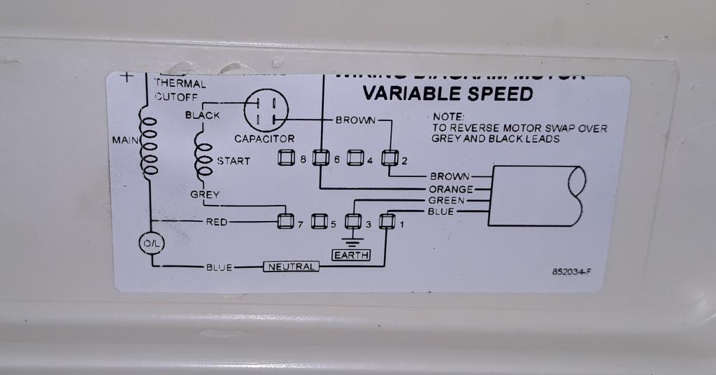

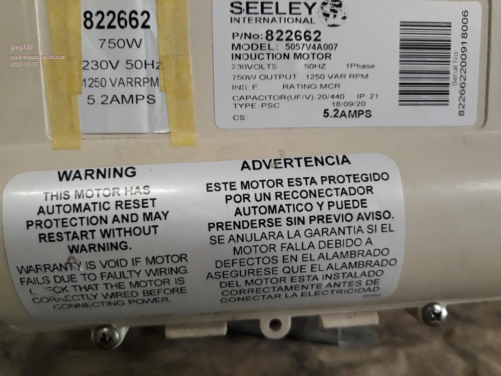

I have acquired a Seeley variable speed single phase 230V AC motor rated at 750W and 1250 Var RPM that appears in excellent condition. The model number is 5057V4A007, part number 822662.
I'd like to get it working with a variable speed but there was no power supply with it and the wiring diagram sticker in the terminal box is incomplete. The power cord is cut and simply consists of 4 wires : brown, orange, blue, green. The capacitor tests fine (20uF) and coil resistances test fine.

Posted: 01:06am 15 Oct 2022
Yes that Gamato link is correct - a variable speed motor. No PCB. Here's the wiring diagram that is inside the terminal box lid. The top section is cut off and when I checked another identical motor its diagram was also incomplete - a printing problem at the manufacturer I guess.
And here's the full specs....
Capacitor is 450VAC 50/60Hz.

There can't be much missing from that wiring diagram. My guess is just the main winding going to the orange wire via the thermal cut-out. You could check that with a multimeter easily enough.
The speed control is probably a triac phase controller connected between active and orange. Essentially a high power light dimmer modified to cope with a highly inductive load.
To run at full speed just connect orange to active.

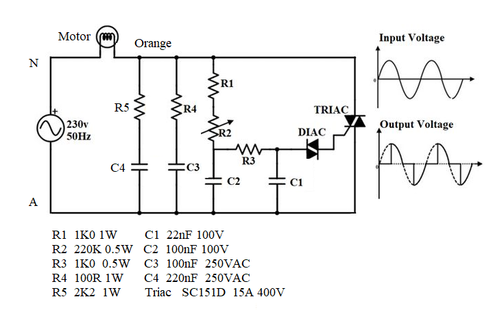

Posts: 3412
Posted: 12:13pm 16 Oct 2022
Found a suitable light dimmer circuit and adapted it for an inductive load.
Untested.
greg199
Joined: 03/11/2015
Posts: 39
Posted: 12:00am 17 Oct 2022
I appreciate the effort you've invested phil99 - even providing a design. Unfortunately I don't yet have the skills or equipment for an electronics build but it will be a good project for me when I've completed all my outstanding tasks.
In the meantime, I'll settle for a single speed.
By the way you were correct.... if I give the shaft a manual start in either direction the start winding will continue to run without the main winding (orange wire) connected. Joining the orange and active wires results in an unassisted start and high single speed.
