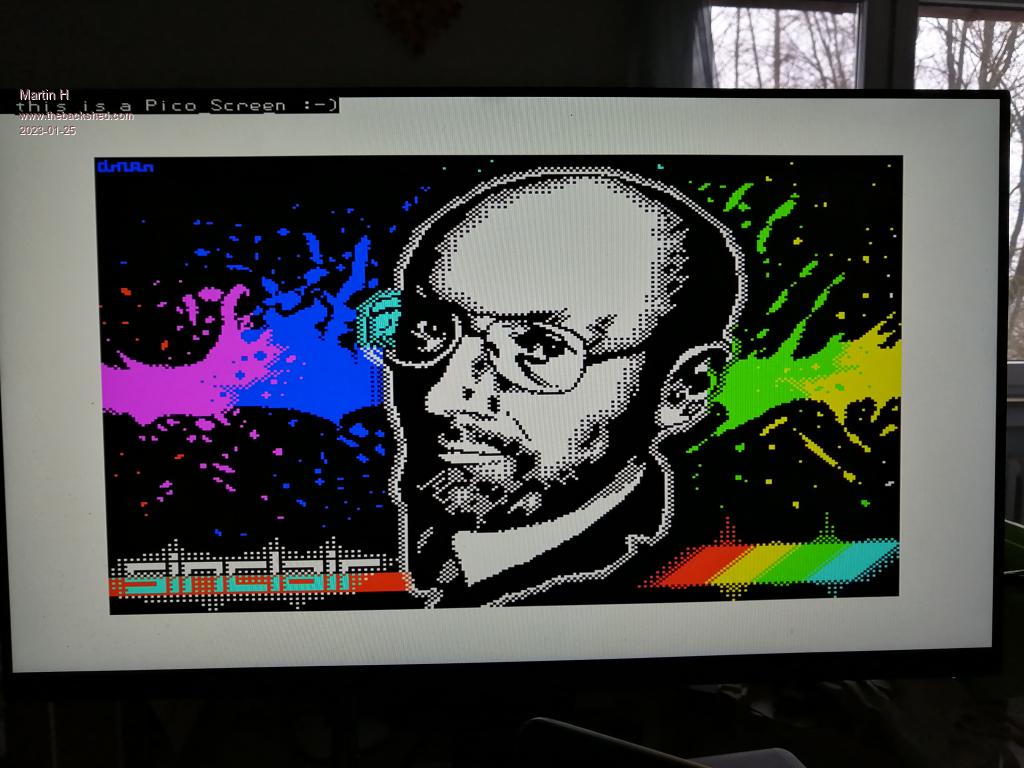

What is scr file?
The scr file extension is used for ZX Spectrum standard screen.
The scr files are memory dumps of the first 6912 bytes of the Spectrum memory.
32*192 Bytes Pixel Data + 32*24 Bytes Color Data
I've made a little Tool to show ZX Spectrum Screen$ files on the Pico
Missing: Flash Attribut and Brightness for white.
'ZX Spectrum Screen Loader for PicoMite

to keep things easier, I used Mode 1 and the Tile Command for the Colors.
The disadvantage of this is that you cannot save the image with Colors as a BMP File.
here the Sample Picture

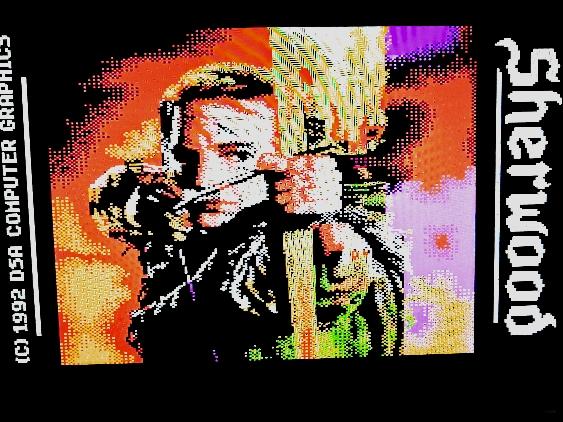

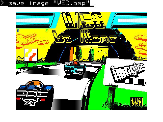

but.. wec.scr    6912 Bytes
     WEC.bmp  230454 Bytes
so the bmp file is 33.3 times as large as the source
