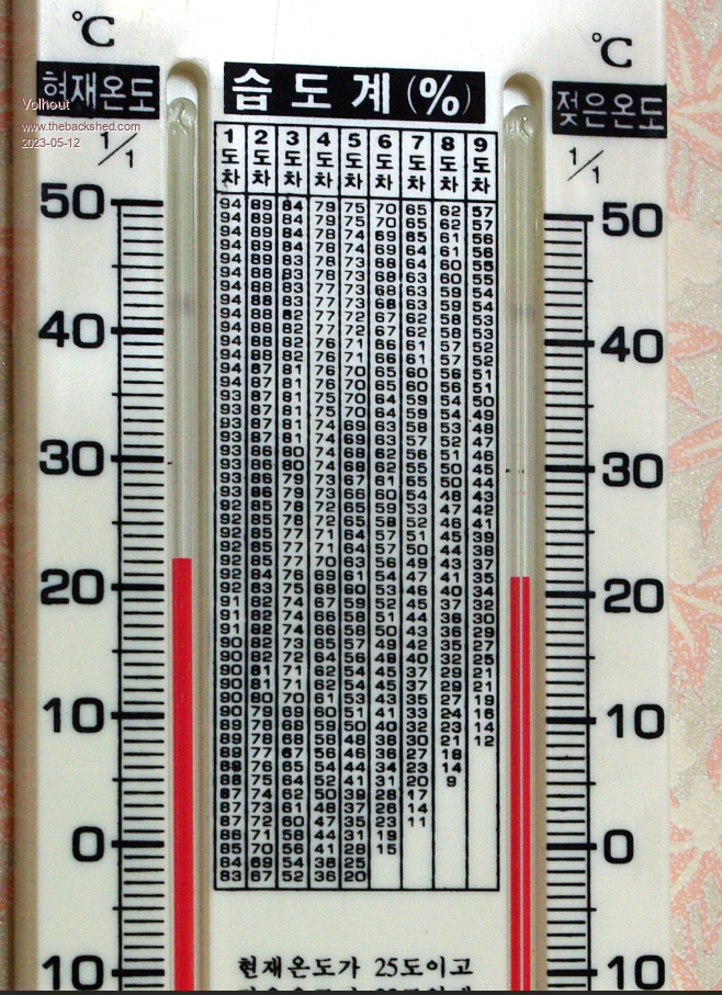

Looked at Wiki, found a picture that shows a physical device. My chineese is sub zero, but I think that the tables columns indicate the temperature difference and a certain level of the dry bulb (the wet bulb would normally not exceed 35C since humans would die, and there would be no-one to read the temperature).
This would require pretty accurate temperature measurement and calibration.
I'll play a bit with the idea. The good thing is that the wet bulb is easy to achieve since there are water pools in the habitat...

That Chinese table is the Mollier diagram to determine the humidity manually.
The two temperatures are measured with a ptc or ntc sensor.
In the greenhouses in my area (West of the Netherlands), measurement with dry/wet bulb is still used today, but due to regular maintenance, this is increasingly done with an electronic sensor.
The electronic versions have the disadvantage that they need to be calibrated, so it is more economical in practice to renew the entire sensor.
Two watertight DS18b20 sensors would work well and include the table in the microcontroller or by means of a formula. Do use good cotton stockings and a small auxiliary fan and demineralized water because the table is based on this.
The DTH22 or DTH11 is not really suitable and I have the DHT20 which according to the specifications should work better and also have the correct i2c subroutine for this sensor but have not yet tested it in practice at a location.

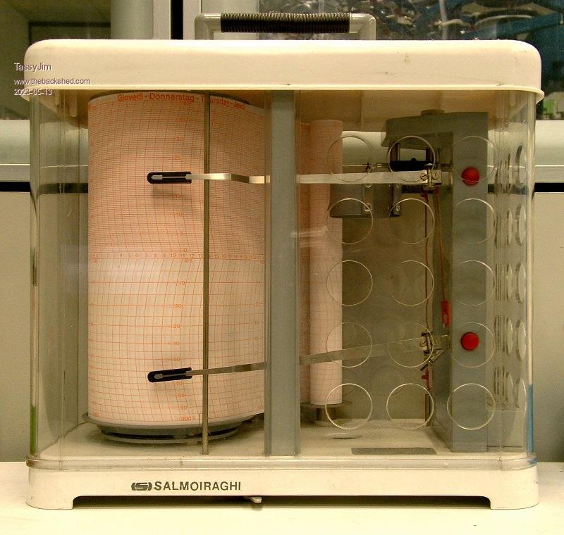

50 years ago I used thermo-hydrographs to record temperature and humidity.
The humidity pointer was controlled by a length of (usually) human hair.
I no longer have a supply of human hair to experiment with.
The drum was clockwork and the charts could be 24 hour or 7 days per revolution.
Edited 2023-05-13 10:45 by TassyJim

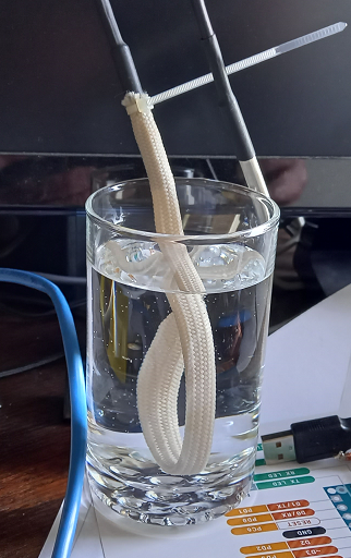

This uses a bootlace as the wick. Not the best choice but my wife's sewing basket didn't have anything better.
On my desk without any air movement, it reads about 10% higher than a DHT22
With a bit of breeze, it would come down nicely.

Thanks Jim. I have been going to set up a couple of 18B20s but the graph is enough to put me off. The words ENTHALPY & ENTROPY still give me nightmares however, it may be of interest to some.
Peter

Yes, long ago also had to monitor air-con zones with thermo-hydrographs and a sling psychrometer (with wet and dry bulbs) to calibrate them. This had to be spun at a rate that gave an airspeed of 60km/h for the Rh graph that came with it to be accurate. There was also a correction table that required the barometric pressure for better accuracy. Distilled water was required for best results.
Are you sure the DHT22 is correct?
Mount the sensors horizontally and use rubber grommets to accommodate the two DS18B20.
When using a fan at high temperature and high %RH and DC voltage, condensation can occur with a standard fan and thus electrolysis at the connecting wires in the fan, so extra insulation.
Make sure the fan is positioned above the sensors and the airflow is upwards. (then the correct temperature and %RH)
Also make sure that the bottom of the measuring box is closed off by a filter or gauze and ensure that the water and wick remain clean by preventing the incidence of light and possibly a small drop of bleach in the water to prevent algae growth.
Calibration is simple by correcting the correct temperature with an offset and making it exactly equal together and then placing the wick.

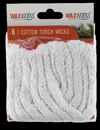

It is a long time since I have handled a genuine wick but the bootlace I am using feels too dense. I will find some better material to make a new wick before I get too involved with a fan.
I will try these.
Cheap and available at the local hardware store (Bunnings)
