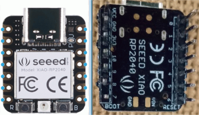

I've done lots of breadboards, but maybe none in the past year or perhaps two. So this was a challenge. The RP2040 mentioned above is superior, but I happened to have a couple of the 14-pin Seeed RP2040 modules.
It was not trivial figuring out the pins from the diagrams and pin numbers on the PCB--they didn't correspond to the Pico pins. After loading MMBasic, I did it by brute force--SETPIN, n,DOUT, then see if I could toggle it.
The right-side pins (top view, USB connector up) are (from the bottom up) 2,4,6,5,3v3,0V,5V; the left side pins are 1,10,9,44,31,32,34.
I used a little SD card module (which apparently some have had trouble with, but I haven't) and these options: OPTION SYSTEM SPI 4,5,6 OPTION SDCARD 2.
I could successfully examine both the A: drive and the B: drive, and save to the B: drive:

I ran this program to randomly turn off and on the LEDs on an 8-LED common anode module (so negative logic--0=on).
Dim integer i,j,k,npins=7,p(6)=(1,10,9,44,31,32,34)
For i=0 To npins-1
 SetPin p(i),dout
 Pin(p(i))=1 ' negative logic for this common anode 8-led module
Next i
Do While 1
 j=Int(Rnd(1)*2) ' 0 or 1
 i=Int(Rnd(1)*npins) ' 0 through npins
 Pause 500
 Pin(p(i))=j
