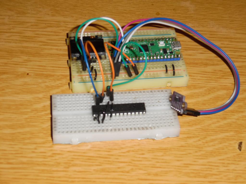

I want to make a board with 8 buttons and use mcp 23017 i2c port expander.
Even games an i2c button would be fast enough.
I forgot I had it, wired to range sensor and ssd1306.. same i2c pins. That's cool.
Would be useful for buttons but looking at the data sheet and I'm lost.
I have Lizby's code for output but don't know how to set to input and pull up settings etc.
Is there a thread about this device please? stan

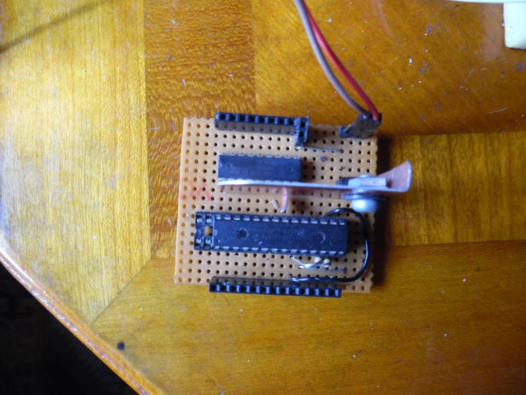

Thanks Andy and all for replying. I got enough to work with and sorry I don't understand data sheets but a code example explains everything.
I found another 23017 board from mega 328 and gcbasic code. Used with uln2003 dual stepper motor driver but output only. I used 2 pullup resistors but only needed for i2c leads longer than a foot.
I2c is nice, like I'm using 3 devices on the same 2 pins.
A strip board with a 16 port expander and buttons that I could connect with 4 wire ribbon cable when needed would have been handy so I'm making one.
If I can get weak pull ups to work then is switch from expander pin to ground safe please? stan

Posted: 02:31pm 26 Oct 2023
Thanks lizby. Turns out I bought 5, I found the tube with 2 in. The other is on breadboard, the other in a robot and the other on stripboard ready to replace the one in the robot with dual uln2003 not the boards with leds that come with the motors.
I am rediscovering the devices from only using them with 8bit.
