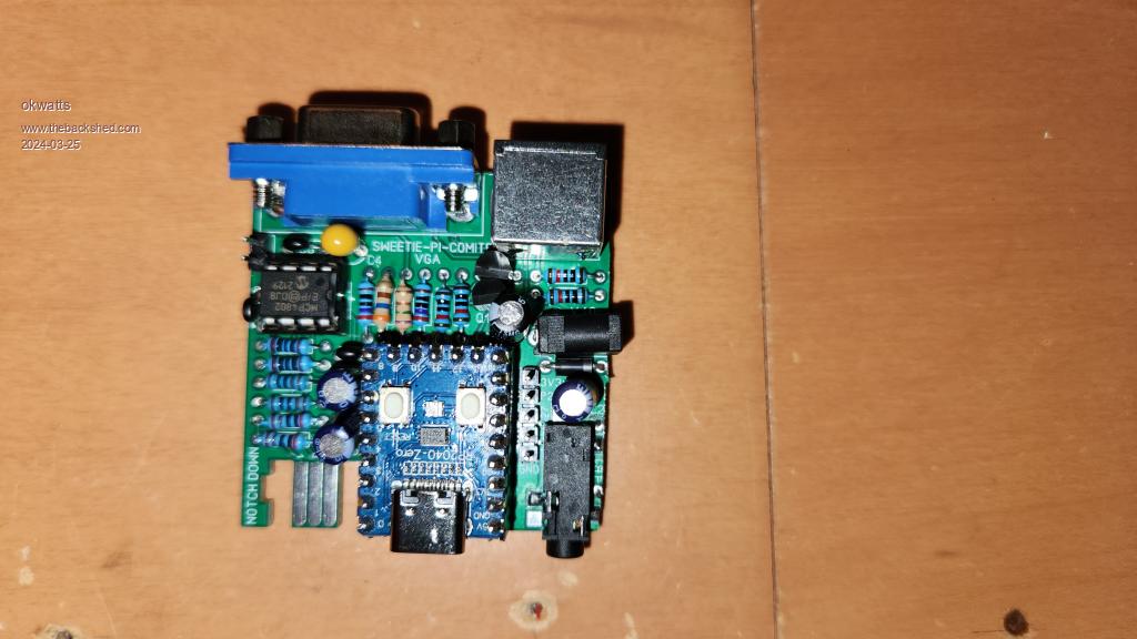

Posted: 09:58pm 22 Mar 2024
I just wanted to report that I built up one of these (thanks to Lizby for the board) and everything I've tried seems to work. I have not tried the WII controller yet as I have to read up and find a game to check out.
Thanks to you both I now have more PicoMite's than I need(I've lost count) but have them in non-VGA, VGA, and VGAUSB - genuine Raspi Picos, matherp's VGA v1.0a, LandBoard PicoVGA, Weact clones, PicomiteBackpack, Raspi2040 Zero etc.
Now I need to start a club and get others interested locally! I don't want to be accused of being a Pico hoarder!

Posted: 09:35pm 24 Mar 2024
Just to show that I actually did build one I include a photo (Poor using phone camera) showing my construction skills(or not) warts and all. I used the resistors I had to hand hence the 1/4 watt ones that were close but not exact to those specified. R1 (2R2 in theory) is just a wire link on the underside of the board. Use and abuse as you will. The board was cutout of a panel of 4 donated by lizby.
Posts: 9220
Posted: 10:46pm 24 Mar 2024
Many thanks. :)
I've tweaked your pic a bit and added it to Peter's thread.
I love seeing the results of people's builds of my boards. :) Sometimes we just use the components that are to hand. Nothing wrong in that. It's part of what engineering is about. Most micro SD cards wouldn't need R1 anyway. I put it in because it would be a pain to add it later if it was needed.
