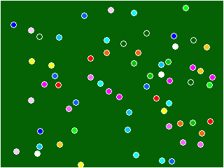

Changes to BLIT and SPRITE
Background
The PicoMite is normally used with SPI displays and these are too slow to use the full sprite fuctionality that was originally developed for the CMM2. Because of this I left sprite functionality out of the PicoMite and only included it in the PicMiteVGA.
However, since that early decision, I have included the framebuffer and layerbuffer functionality into the PicoMite. Like the PicoMiteVGA, these are based in RAM and pixels are stored as 4-bits each - 1 nibble per pixel. This is efficient in terms of memory and allows very fast read-modify-write transactions which are the basis of the sprite functionality.
According, I have decided to incorporate true sprites into the PicoMite and WebMite variants (and the PicoMiteUSB) to work on the framebuffer or layerbuffer.
At the same time, it is clear that the use of the commands SPRITE and BLIT which were interchangeable has resulted in confusion so I am now including both in all variants with the relevant functionality limited to the appropriate command.
In order to free-up the extra command slot the, little used, REFRESH and FLUSH commands have been combined (FLUSH without a parameter = REFRESH).
In addition to free up a function slot for the SPRITE functions MM.HPOS and MM.VPOS are removed and replaced by MM.INFO(HPOS) and MM.INFO(VPOS).
Existing code does not need to change as the firmware will make the changes automatically.
SPRITE command and function changes
The sprite command and function function as per the VGA manual with the exception that its use for a
BLIT operations (SPRITE x, y, newx, newy, width, height; SPRITE memory) is removed.
SPRITES are ALWAYS 4-bits per pixel and therefore for the non-VGA variants can only be used on a FRAMEBUFFER or LAYERBUFFER. Because of this storage of sprites is very memory efficient
New command
SPRITE SET TRANSPARENT RGB121colour  'sets the colour(1-15) that will be used as transparent when displaying sprites - defaults to zero
In addition the maximum number of available sprites is increased to 64 as per the CMM2
Full List:
SHOW SAFE, SHOW, HIDE ALL, RESTORE, HIDE SAFE, HIDE, SWAP, READ, COPY, LOADARRAY, LOAD, INTERRUPT,
NOINTERRUPT, CLOSE ALL, CLOSE, NEXT, WRITE, LOADBMP, MOVE, SCROLL, SET TRANSPARENT
BLIT command
The BLIT command can work on both framebuffers and physical displays. Blit buffers, as used in READ/LOAD and WRITE are RGB888 and therefore take 3 bytes per pixel
The maximum number of available BLIT bufferss is increased to 64
Full List:
MEMORY, COMPRESSED, FRAMEBUFFER, LOADBMP/LOAD, MERGE, READ, WRITE, CLOSE, normal BLIT
This change may break existing programs but the modification needed should be trivial - i.e. swapping BLIT for SPRITE commands or visa-versa
I attach a simple demo program showing a standard PicoMite (or PicoMiteVGA) using all 64 sprites with full collision detection

  matherp said  I attach a simple demo program showing a standard PicoMite (or PicoMiteVGA) using all 64 sprites with full collision detection
Neat, though I'm not sure why the image I saved with "SAVE IMAGE" after exiting has a green background rather than the black one on the ILI9341.
Is it "CLS RGB(myrtle)"? Nearly black, so not transparent?
?hex$(pixel(1,1),6) yields 006000
cls rgb(myrtle) actually looks light green on the screen.
