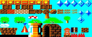

1. Create a Tile Image
   Description: The first step involves creating an image that contains all the tiles you will use in your game.
   Tools Needed: Paint.net (or any similar drawing program).
   Steps:
       Design your tiles, making sure each tile fits within a specific grid (e.g., 24x16 pixels per tile).
       Convert the image to the 16 colors allowed by PicoMite VGA. You can usually do this by reducing the color palette in your drawing program. Some colors that do not exist in this form must be created by dithering.
example
2. Create the Map

4. Convert Tile Image to Sprites
   Description: This step converts the tile image into Spr (sprite format), which PicoMite VGA can use.
   Steps:
       Generate SPR Files:
Write a program or use an existing tool to take the tile image and break it down into individual sprite files (SPR files). Each sprite file should represent one tile.
In my case i use MMB4Windows for this:

In the first part, we explained how to create the tiles and the maps.
Now, it's about getting them displayed on the screen
For this example, we need the CSUB file with the graphics in our program.
